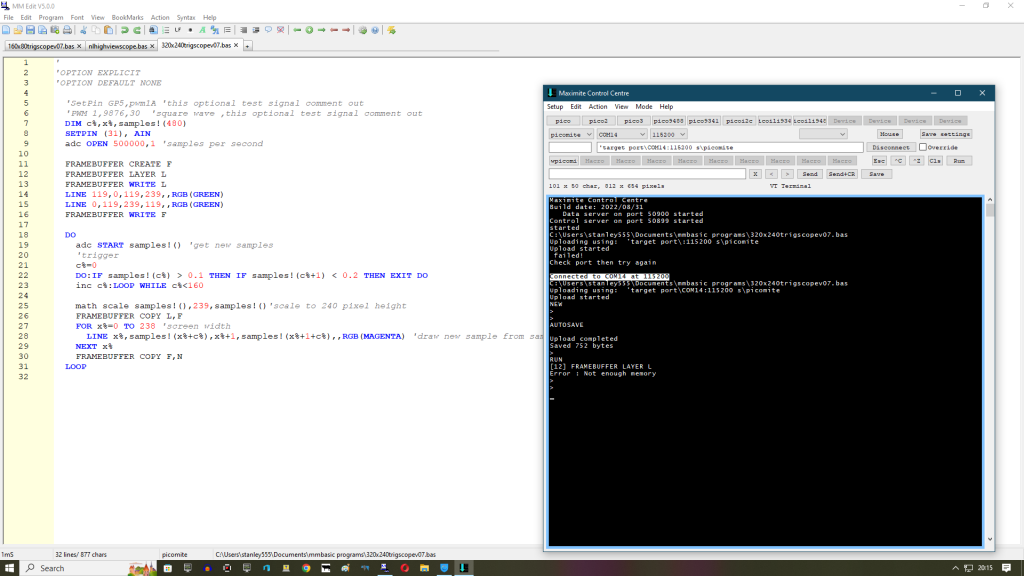

I tried math min for trigger but it's new and I don't understand. Changed vars to integer.minval%=MATH(MIN scaledsamples%(),c%)   -- c%is lowest value in scaledsamples% ???
error message c%=
RUN
0
0
0
0
0
79
0
6
0
0
164
[38] Line x%,scaledsamples%(x%+c%),x%+1,scaledsamples%(x%+1+c%),,RGB(magenta) 'draw new sample from )
Error : Index out of bounds
code
 do
   adc start samples!() 'get new samples
math scale samples!(),79,scaledsamples%()'scale to 80 pixel height
print c%
do:If scaledsamples%(c%+1) > scaledsamples%(c%) then if scaledsamples%(c%+2) > scaledsamples%(c%+1) then exit do
inc c%:loop while c%<99
FRAMEBUFFER COPY L,F
for x%=0 to 158 'screen width
     line x%,scaledsamples%(x%+c%),x%+1,scaledsamples%(x%+1+c%),,rgb(magenta) 'draw new sample from sample(c%)
next x%
FRAMEBUFFER COPY F,N
loop

ok Mick. I just copy from mmedit. The manual MATH(MIN a(), [index%])
is
convert ad samples!() to scaledsamples%() then find minval% and is c% the array pointer to lowest value in array?
Posts: 3378
Posted: 10:42pm 16 Aug 2023
From your output the last (tenth, counting from 0) value of c% was 164, so
means x%+1+c% (10 + 1 + 164 = 175) is greater than the size of the array.
The array needs to be at least double the screen width.
Dim scaledsamples%(mm.hres * 2 + 1)
Edit
You could then use MEMORY COPY to start copying from scaledsamples%() at index c% to another array equal to mm.hres. Then you just plot from the start of the new array.
Dim OutputArray%(mm.hres +1)
offset% = Peek(varaddr scaledsamples%())
output% = Peek(varaddr OutputArray%())
Memory Copy INTEGER offset% + c%*8, output%, HRes
Depending on how the code for MEMORY COPY works it might be possible to copy back to the start of scaledsamples%(), no extra array needed.
Edit 2
TESTED - it works!
Memory Copy INTEGER offset% + c%*8, offset%, MM.HRes
Then you just plot from the start of scaledsamples%().

Thankyou @phil99. I've not used peek yet... er...seemed so 80's or picaxe :)
I guess my trigger doesn't always find a trigger so the index overflows.
First time I used math min and not sure if [index] was pointer to lowest value element.

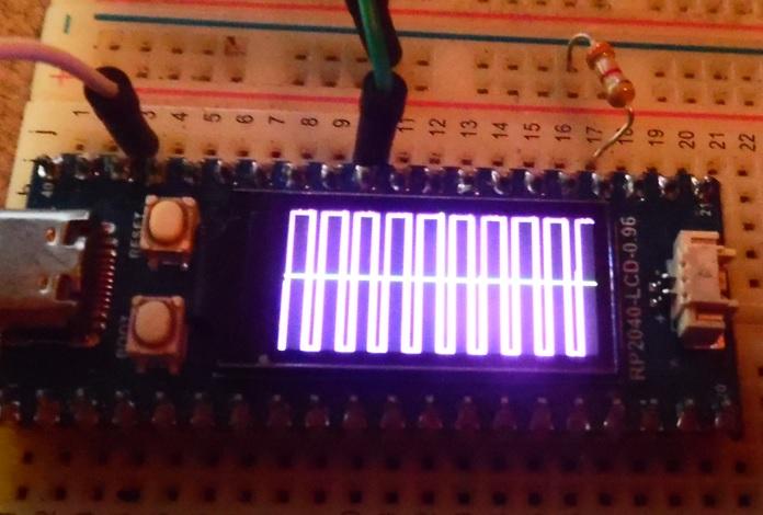

  NPHighview said  I'm not using "join the dots" vectors, just the PIXEL command using arrays. I guess I'm just a pixel sort of fellow (actually, thought about using LINE command using arrays, but then would have to do extra copying).
For those who do want to see the rise and fall of square waves I think these small mods to the last two Subs should do it.
Not tested, it may be necessary to increase the size of sample!() by 1 if you get "Error: Index out of bounds"
Sub Scale_Samples
 Memory copy FLOAT addr.sample + trigger*8, addr.buffer, Hres
 Math Scale buffer!(), V.Scale(Vselect),  buffer!()  ' Scale samples to fit vertically
 Math Add   buffer!(), V.Offset(Vselect), buffer!()  ' Offset to bottom of screen (positive is up)
 Memory copy FLOAT addr.buffer + 8, addr.sample, Hres  'Back copy samples with 1 pixel offset for vertical edges
End Sub

As the rising and falling edges of a PWM output are so fast on the Pico you probably shouldn't be able to see them. Probably not with a 500kHz ADC sampling rate anyway.  :)
Those edges are hardware generated on the chip and aren't related to the speed of MMBasic.

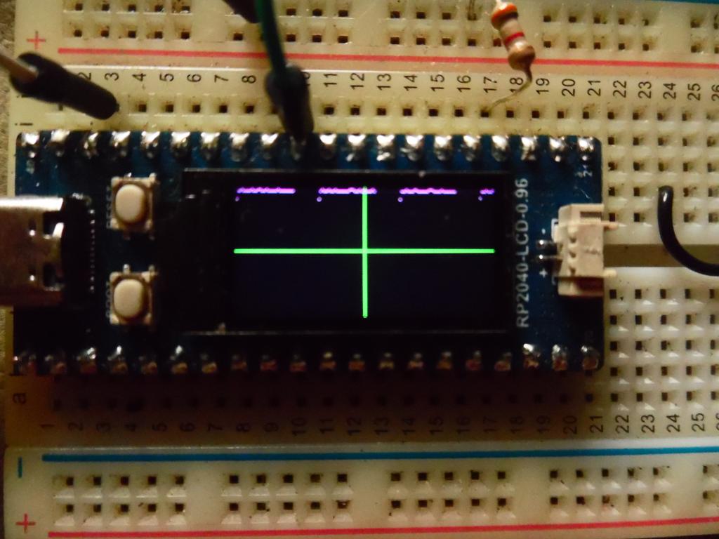

I removed trigger and used plot instead of line but just get a row of samples with flickering pixels for the rest?
 SetPin GP18,pwm1A 'this optional test signal comment out
 PWM 1,10000,30  'square wave ,this optional test signal comment out
 dim c%,x%,samples!(320)
 SETPIN (31), AIn
 adc open 500000,1 'samples per second
 FRAMEBUFFER CREATE F
 FRAMEBUFFER LAYER L
 FRAMEBUFFER WRITE L
 line 79,0,79,79,,rgb(green)
 line 0,39,159,39,,rgb(green)
 FRAMEBUFFER WRITE F
 do
math scale samples!(),79,samples!()'scale to 80 pixel height
for x%=0 to 159 'screen width
     pixel x%,samples!(x%),rgb(magenta) 'plot new sample
next x%
loop

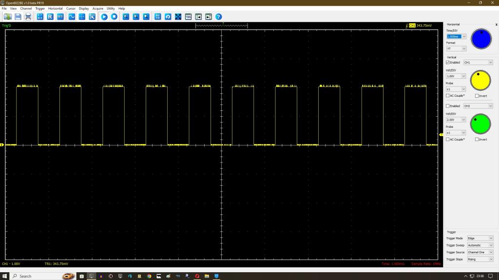

Hi Mick. er.. I can see them with join the samples with lines. Lines take more time than pixels and my prob is not realizing how fast everything is.
My crude trigger I can't find how to improve but a 9999Hz pwm doesn't move much.
It was never meant to be a real scope just a-d idea but I've learnt lots of new mmbasic stuff from this thread.
As mentioned, could be handy for breadboard testing... if no real scope handy.
could it be used for i2c,spi,pwm,serial testing. if the sampling rate was changed?
All input would be 3.3V. Maybe leave sampling at 500000 and if storing to array then pad out horizontal for lower frequencies for display, just a thought.
30KHz pwm 30%
Posts: 9125
Posted: 09:41pm 17 Aug 2023
Joining the samples with vertical lines is deceptive. The line thickness can represent several hundred microseconds on the display (it will actually depend on what your horizontal scale factor is). In actual fact the rise and fall times may only be a few microseconds. However, with edges that fast you can't see them on the display unless you make the horizontal zoom factor very big (only show one edge of the square wave, for example). Whatever you do on such a small display will be a compromise.
You can see this effect very nicely on an analogue scope. You won't see the rising and falling edges until you increase the brightness as they are too fast for the electron beam to put sufficient energy into the phosphor of the tube.

I saw an Asteroids board connected to a xy analogue scope in the 70's. wouldn't work without the phosphor on a sampling scope.
my cheap hantek usb scope shows vertical trace for digital signals

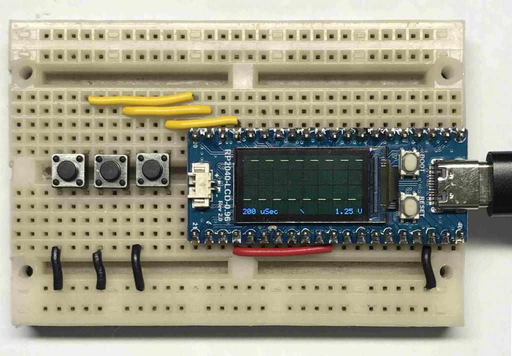

Hi - I've got three momentary-contact, pushbutton switches, one to cycle through time / ADC frequency, the next to select triggering, the the last to cycle through voltage ranges.  See my Handle_Pushbuttons subroutine.
Posts: 9125
Posted: 09:30pm 18 Aug 2023
That's very nice. :)
