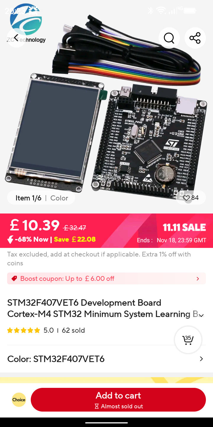

Thanks Gerry
I found this  package deal
At AU$29 + free shipping, seems a bit too good to be true
