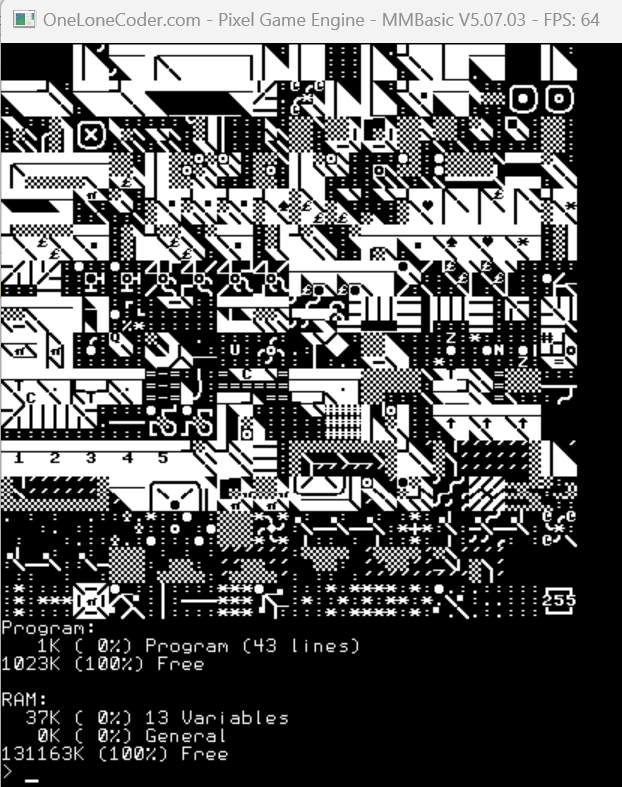

EDIT: This how the Tileset for the Game looks with C64 Font
Edited 2023-09-25 03:01 by Martin H.

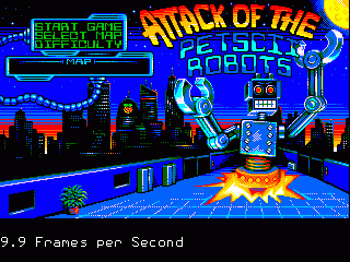

Posts: 3825
Posted: 11:33pm 24 Sep 2023
I don't know how pertinent it is here, but I was curious about the theoretical maximum scrolling speed for the ILI9341 (it may not be relevant, but CPUSPEED is 378000).
Martin's initial screen for PETSCII Robots seemed like a good start. Scrolling one column per iteration, it managed 9.9 frames per second.
Dim integer i,j,x,y,xx,yy
FRAMEBUFFER create
FRAMEBUFFER write F
Load image "b:\petscii-intro.bmp"
'Pause 5000
FRAMEBUFFER COPY F,N
FRAMEBUFFER WRITE N
CLS
xx=MM.HRes-1
yy=MM.VRes-1
Timer =0
For i=0 To xx
 FRAMEBUFFER BLIT F,N,i,0,0,0,xx-i,yy
 FRAMEBUFFER BLIT F,N,0,0,xx-i,0,i,yy
Next i
Print Str$((xx+1)/(Timer/1000),0,1)+" Frames per Second"
Text 0,MM.VRes-(MM.Info(FONTHEIGHT)*2),Str$((xx+1)/(Timer/1000),0,1)+" Frames per Second"
Youtube video here.

Posts: 3825
Posted: 12:36am 25 Sep 2023
Oops, sorry. Should be public now.

I don't think the CPU speed will make any difference to the SPI clock speed and the display will only update at whatever speed it does, depending on how fast you fill its RX buffer (I assume it has one), no matter how fast you attempt to drive it.
Posts: 5998
Posted: 07:54am 25 Sep 2023
With 16MHz clock on SPI, sending 1 pixel (65536 colors = 2 bytes = 16 bits) take 1us (micro second).
There are 320x240 = 76800 pixels.
To refresh the screen takes 76800*1us = 76.8 miliseconds (13 fps) for SPI bus communication.
since pico has not enough memory for a ILI9341 framebuffer, it uses the ILI9341 internal buffer. Through SPI bus.
Scolling the screen would require reading each pixel, and re-writing it in another location.
This would bring back the refresh rate to 2x76.8ms=154ms (or 6.5fps). It would be better not to scroll , and re-calculate the screen each time. The pico is much faster in re-calculating.
But this is theoretical limit of the SPI but. Practice with be slower.
Edited 2023-09-25 17:54 by Volhout

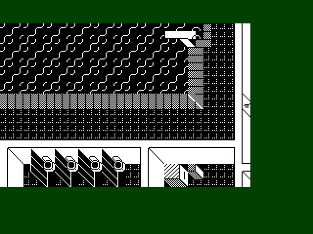

Posted: 09:52am 25 Sep 2023
Proof of the SubTile-concept
(For Picomite VGA, for LCD remove the MODE Commands)
far from optimal (it redraws all Tiles every Frame):
Patscii_ascii.zip
with "GUI BITMAP" it outputs ~5 FPS.
Edited 2023-09-25 20:00 by Martin H.

  Volhout said  since pico has not enough memory for a ILI9341 framebuffer, it uses the ILI9341 internal buffer. Through SPI bus.
How is the observed horizontal scrolling rate of 9.9fps for the ILI9341 shown above compatible with a theoretical maximum of 6.5fps?
