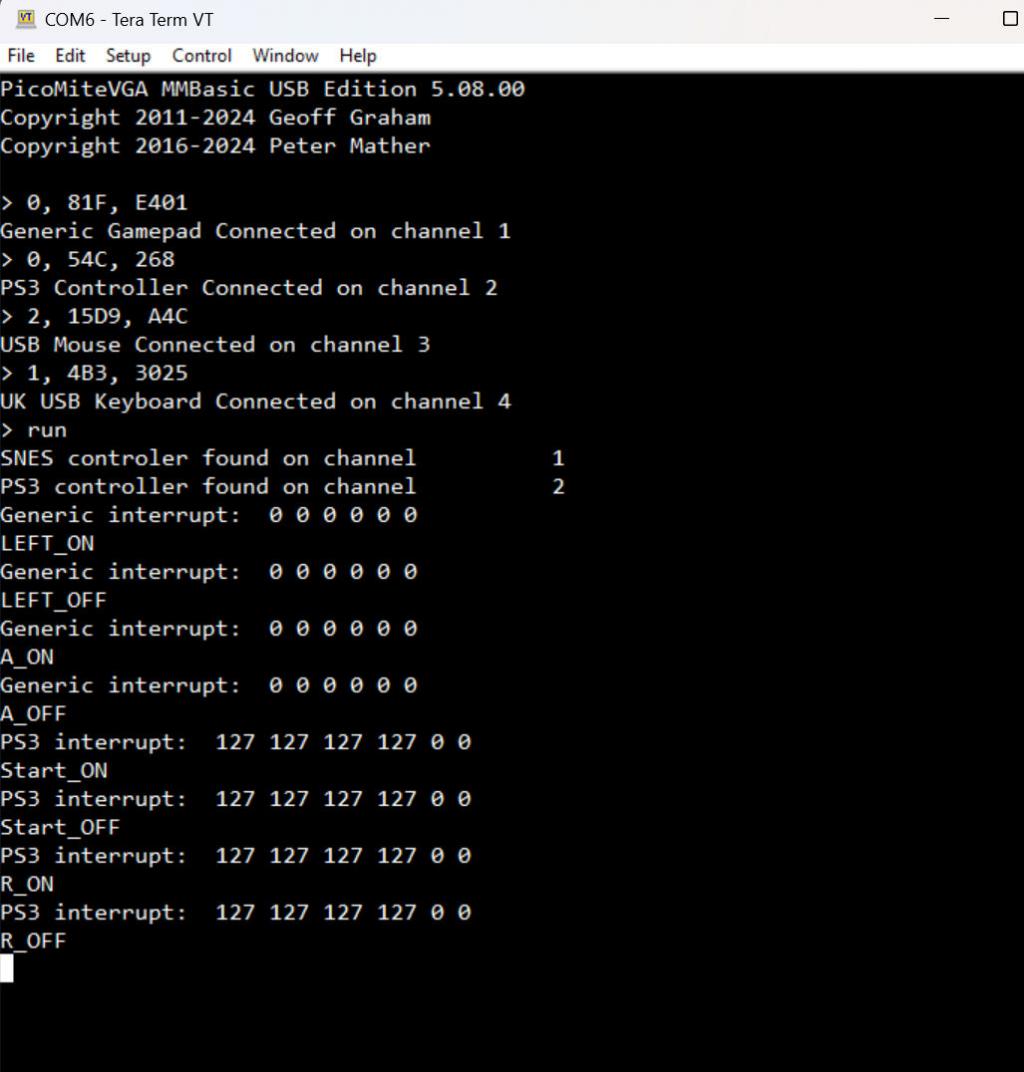

Posts: 11662
Posted: 02:36pm 01 Feb 2024
UPDATE
Please see a WORKING test/example program on my current development build.
Note how an individual interrupt can be allocated to each of the channels on a USB hub when a gamepad of any sort is plugged in.
Following my earlier post and Tom's response, this is how I would intend that the gamepad interface works. Of course, the gamepad can also be polled if required using the DEVICE(GAMEPAD function as in the interrupt.
The interrogation of buttons and analogue values are exactly the same as for a Wii Classic and the same as the CMM2.
As per the picture this program was running with both a functional keyboard and mouse also connected.
Currently left to do is the code to format PS4 data as per the other controllers and providing a MMBasic interface to the mouse.

Posts: 4379
Posted: 02:46pm 01 Feb 2024
Hi Peter,
Three questions:
- Can I have multiple controllers of the same type (on different channels) ?
- Presumably I would need a different interrupt SUB for each because the interrupt SUBs don't otherwise know what channel they were called for ?
- Will DEVICE(GAMEPAD <channel>, ...) return a special value if not a GAMEPAD or an ERROR ?
Posts: 11662
Posted: 03:40pm 01 Feb 2024
  Quote  - Can I have multiple controllers of the same type (on different channels) ?
Yes
Yes
0=not in use, 1=keyboard, 2=mouse, 128=ps4, 129=ps3, 130=SNES/Generic
Posts: 4379
Posted: 04:04pm 01 Feb 2024
  matherp said
  Quote  - Will DEVICE(GAMEPAD <channel>, ...) return a special value if not a GAMEPAD or an ERROR ?
That can't be right can it ? Those values would conflict with the standard "Wii Classic" style return data from DEVICE().

Posts: 4379
Posted: 04:22pm 01 Feb 2024
  matherp said  DEVICE(GAMEPAD <channel>, ...)
not
Huh ?
Will as in "Will you ...?", "Will it ?"
I'll be more specific.
What will:
DEVICE(GAMEPAD 1, b)
return if USB channel 1 doesn't have a "gamepad" attached to it ?
Edited 2024-02-02 02:23 by thwill
Posts: 11662
Posted: 04:39pm 01 Feb 2024
Sorry I answered the wrong question
mm.info(usb n) returns 0=not in use, 1=keyboard, 2=mouse, 128=ps4, 129=ps3, 130=SNES/Generic
device(gamepad b, anything) returns zero if not connected
