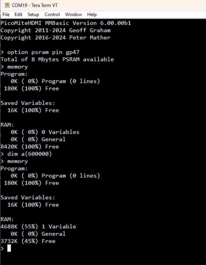

Posts: 11653
Posted: 11:10am 30 Aug 2024
V6.0.0b1 for HDMI, PicoMite and VGA - no USB versions yet
PicoMiteRP2350V60.0b1.zip
This has the new PIO functions as above + full transparent support for PSRAM

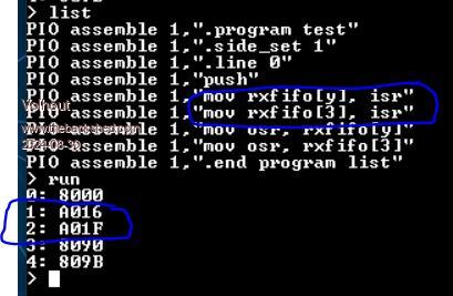

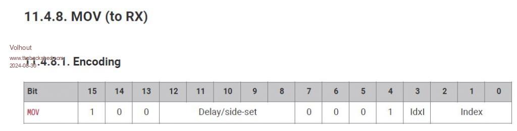

Posts: 5995
Posted: 01:29pm 30 Aug 2024
Hi Peter,
I think the "mov rxfifo[], isr" does not work correct.
When the datasheet is correct it should translate to something starting with &h80xx
Posts: 11653
Posted: 01:43pm 30 Aug 2024
Can you post your test program please - thanks. I think I had a |= rather than an =
Edited 2024-08-30 23:43 by matherp
Posts: 5995
Posted: 03:11pm 30 Aug 2024
That is the whole test program, these 8 lines. I did not arrive at executing anything yet...just the lines PIO ASSEMBLE 1, ....

Should fix the PIO issue above

All versions now support PSRAM if enabled with
OPTION PSRAM PIN pinno 'pinno is typically GP47 for Pimoroni boards
When enabled PSRAM can be used like normal ram to store large arrays/strings etc.

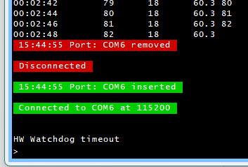

Posts: 6548
Posted: 05:58am 31 Aug 2024
The PAUSE bug has returned.
PicoMite RP2350B, B0 firmware, default options
This code will run for a few minutes to a few hours before locking up. The Hardware Watchdog does it's thing but a software Watchdog fails to restart.
Edit: The first run on b1 failed after 13 minutes.
'settick 2000, ping
'do
'loop
DO
WATCHDOG HW 8000
DEVICE HUMID GP20, tVar, hVar
PRINT TIME$, n, tVar, hVar ;
PAUSE 2000
n = n + 1
PRINT n
LOOP
SUB ping
'do
WATCHDOG HW 8000
'pause 2000
n = n + 1
PRINT n
'loop
END SUB
The print statement was split before and after the PAUSE ro confirm that it is the PAUSE that is the culprit.
Remove the comments from the SETTICK and the empty loop and SETTICK is used rathhheer than PAUSE 2000
Then it appears to run for ever (well tested for 10 hours so for)
Edited 2024-08-31 16:44 by TassyJim

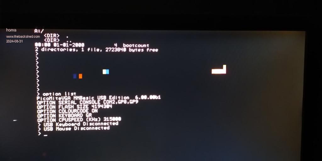

homa
Joined: 05/11/2021
Posts: 651
Posted: 12:32pm 31 Aug 2024
My Pico2 finally arrived :-)
I have graphical artifacts with the "files" command. See picture.
@Peter: Is there a way to prevent the message that a keyboard has been connected/disconnected? The reason is that I use a switcher ... PC/Pico2
By the way, the HDMI/DVI signal only works with a direct connection to the monitor. Using an HDMI matrix (Greathtek 4x2) does not work.
As always, it's an exciting phase to see what's possible.
Matthias
Posts: 8966
Posted: 12:50pm 31 Aug 2024
I see the same artefacts. Only in mode 1. Modes 2 and 3 are ok.

Posts: 11653
Posted: 01:07pm 31 Aug 2024
V6.00.00b2
Minor bug fixes and I've re-coded pause although it hasn't changed in months.
Should fix artifacts in HDMI mode 1

2. Is there a way to prevent the message that a keyboard has been connected/disconnected?
