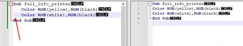

At left - will crash LIBRARY SAVE becouse of spaces in before Color RGB(yellow),RGB(black)
Sub full_info_printer
  Color RGB(white),RGB(black)
End Sub
This LIBRARY SAVE and also properly LIBRARY LIST
Sub full_info_printer2
End Sub
This will LIBRARY SAVE but...
Sub full_info_printer3
End Sub
... LIBRARY LIST will show
>library list
 Color
>_
P.S. One space is enough to call crash
Edited 2025-03-19 06:44 by electricat

disco4now
Joined: 18/12/2014
Posts: 1158
Posted: 04:40am 19 Mar 2025
Peter,
The token allocated to COLOR appears to be FF80.
I think the FF byte might stop Library SAVE when its found.
We might need a extend the condition to ensure the higher tokens don't stop the save.
I have not got an environment to compile so can't test.

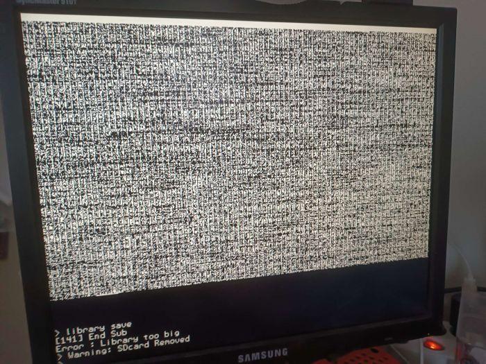

Posts: 6198
Posted: 07:45am 19 Mar 2025
@Disco4now,
I think that is a left-over from the time that tokens where single byte (v5.08.00 I guess).
electricat
Joined: 30/11/2020
Location: Lithuania
Posts: 299
Posted: 07:55am 19 Mar 2025
I`m afraid to be so boring, but... another sad observation.
Freshly cleared/flashed latest RC5
LOADed help.bas .. success
LIBRARY SAVEd .. success
OPTION RESET ...success. (Library deleted according to manual.)
OPTION DISK LOAD .. success(wanted to check if OPTION Fn saves/loads chr$(13) )
LIBRARY SAVEd ... FAIL!!! .
Video screen partially overwrited with data and errmsg
>library save
[141] end sub
Error : Library too big
I`m attaching file used:
help.zip
Edited 2025-03-19 17:59 by electricat

Posted: 09:24am 19 Mar 2025
  Quote  LOADed help.bas .. success
Sorry but you are pushing the limits of what the system can protect against. I've no idea what is in your OPTION DISK LOAD file which includes information about the library.
I don't intend to look at this further other than to implement Gerry's fix for the COLOR issue.
Delete the library before resetting options and make sure you only disk save the options when the library has been deleted
