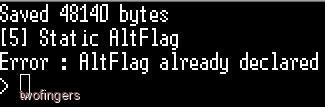

Posted: 06:53pm 16 Aug 2025
Hi Peter,
have you changed anything in PicoMite V6.01.00 beta? I'm getting an error message about this recently.
Do :GetCKey1: Loop Until CKey
Print CKey
End
Sub GetCKey1
Static AltFlag
CKey=Asc(Inkey$)
End Sub
PicoMiteHDMI MMBasic USB RP2350A Edition V6.01.00b5
I'm also getting the same error in an FM version where I use "static." However, it's not an error that can't be easily circumvented. This is just to inform you.
Kind regards

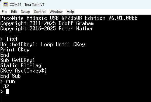

Posts: 11827
Posted: 07:33am 17 Aug 2025
  Quote  have you changed anything in PicoMite V6.01.00 beta? I'm getting an error message about this recently.
Sorry, can't replicate
  Quote  I'm also getting the same error in an FM version where I use "static."
FM version?
  Quote  Probably nothing to do with above report, but if a static variable is declared as a short string so it does not allocated any HEAP memory it fails with various symptoms.
Thanks - will make the change

Posted: 10:43am 17 Aug 2025
@Peter
  matherp said  Sorry, can't replicate
Thanks! But it seems weird. I'll avoid "Static". No problem!
