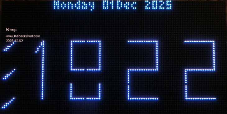

Posted: 06:12pm 30 Nov 2025
Hi Albert,
Further speed ups for BMP Blit etc.
On my setup, loading a BMP has gone from about 3 seconds to just over 1 second, doesn't seem to slow anything else down noticably.

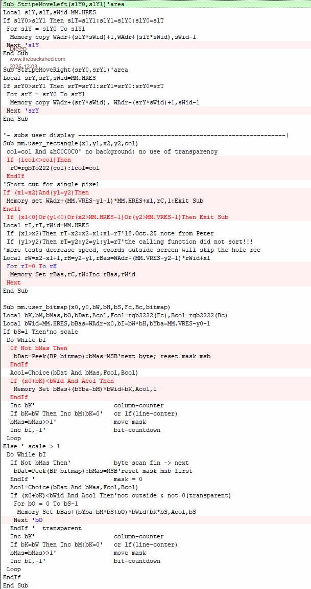

Interestingly if you are trying to squeeze the last bit of speed, changing the way you do end of line comments makes a noticable difference, so instead of:-
bYba=MM.VRES-y0-1          'calc outside loop
bMas=0                     'init val to read byte first
bI=bW*bH                   'all-count
bK=0:bM=0                  'init
Do This
bYba=MM.VRES-y0-1'          calc outside loop
bMas=0'                     init val to read byte first
bI=bW*bH'                   all-count
bK=0:bM=0'                  init
I assume this is because the parser continues looking for code until it find a comment or line end?
Also Next loops are faster without the return lable so:-
 Next i
Next j
Do this
 Next 'i
Next 'j
No idea why this might be, try it in your StripeMove routines, in some places as in after a Next, if you put the comment immediately, when you save the code the editor inserts a single space, again not sure why?
Regards Kevin.

Posted: 10:18am 01 Dec 2025
also if "IF then" are only in one line
If lcol<>col Then rC=rgb2222(col):lcol=col
If (x1=x2)And(y1=y2)Then Memory set WAdr+(MM.VRES-y1-1)*MM.HRES+x1,rC,1:Exit Sub

Continuing with the theme of clocks, here is a ClockClock24 on the 128x64 panel. :-)
Video
Regards Kevin.

AlbertR
Joined: 29/05/2025
Posts: 111
Posted: 01:41pm 03 Dec 2025
Hi Kevin,
Thank you very much for your support, ideas, and testing for this project.
I have incorporated your changes. I wasn't aware that the move function was used so much. I've made a few more changes here.
Sub StripeMoveLeft(slY0,slY1)'area
Local slT,sWid=MM.HRES,sDec=sWid-1
If slY0>slY1 Then slT=slY1:slY1=slY0:slY0=slT
Local sSrc=WAdr+slY0*sWid,sEnd=WAdr+slY1*sWid
For slT=sSrc To sEnd Step sWid:Memory copy slT+1,slT,sDec
Next ' slY
End Sub
Sub StripeMoveRight(srY0,srY1)'area
Local srT,sWid=MM.HRES,sDec=sWid-1
If srY0>srY1 Then srT=srY1:srY1=srY0:srY0=srT
Local sSrc=WAdr+srY0*sWid,sEnd=WAdr+srY1*sWid
For srT=sSrc To sEnd Step sWid:Memory copy srT,srT+1,sDec
Next ' srY
End Sub
I can't explain why it's faster when the loop-start is on the same line as the statement and the “next” is on a new line. Maybe Peter can say something about that.
The collected improvements in zip.
Hub75UserGen.zip

Joined: 09/01/2022
Posts: 864
Posted: 06:15pm 03 Dec 2025
Here is the panel in action with latest driver. As usual the live panel looks much better than the video.
Hub75 Panel 128x64 2mm spacing
Regards, Kevin.
