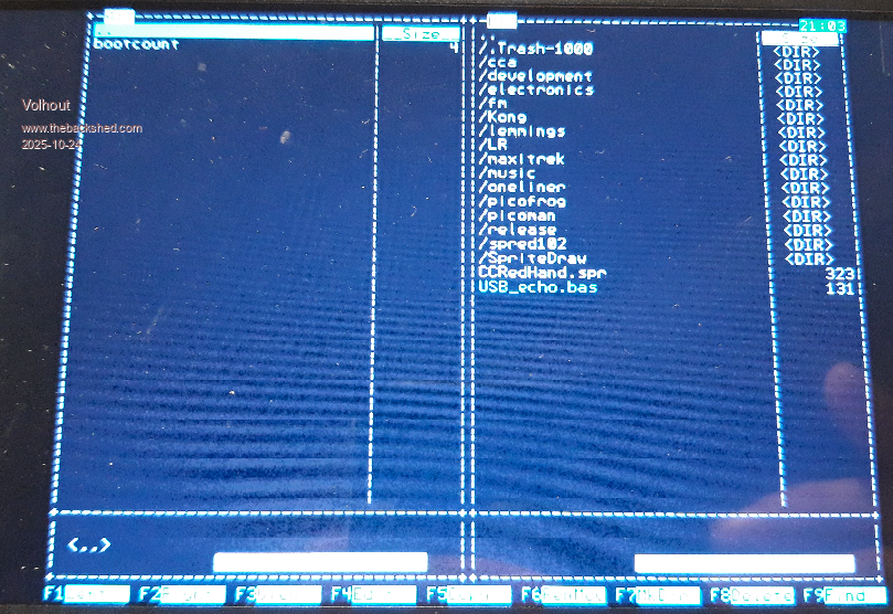

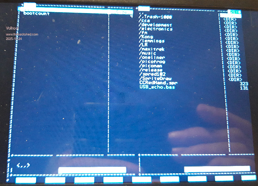

Posts: 6197
Posted: 07:23pm 23 Oct 2025
@Peter,
The filemanager miniFM uses current font information, and reserved variables as MM.HRES to determine the screen format.
Below is tested on RP2040 VGA PS2, and in both cases there was no console connection (that could have impact at screen settings).
Attached are 2 screenshots of b20, and RC6, starting from a virgin system, where all OPTION's where set identical, and no prior program where run (that could impact font or resolution).
b20 (correct screen buildup)
RC6 (screen is misaligned, width is incorrect, height is incorrect).
I have tried this with several versions of the filemanager. Versions that all operate correct with b20.

Posts: 6197
Posted: 03:12pm 24 Oct 2025
@Peter,
The 2040 VGA PS2 screen issue is fixed, thanks. The USB polling (1ms->0.4ms) is a performance impact of 5%-10% on 2040 (impact frame rate in games/logic analyzer averaged). In case it does not fix anything for the people that have issues with USB, I would love to see it reverted. But only when it doesn't fix anything.
I have not tested RC7 on GameMite, but on 2040 VGA it runs fine.
EDIT: RC7 tested on both Game*Mite 2040 and Game*Mite 2350, but no issues found.
