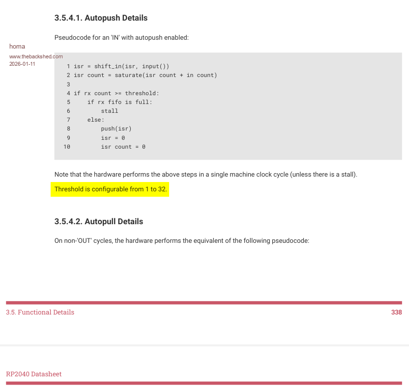

Further questions about PIO and
PIO CONFIGURE pio, sm,
clock [,startaddress]
[,sidesetbase] [,sidesetno]
[,sidesetout]
[,setbase] [,setno] [,setout]
[,outbase] [,outno] [,outout]
[,inbase]
[,jmppin] [,wraptarget] [,wrap]
[,sideenable] [,sidepindir]
[,pushthreshold]
[,pullthreshold] [,autopush]
[,autopull] [,inshiftdir]
[,outshiftdir]
[,joinrxfifo] [,jointxfifo]
[,joinrxfifoget] [,joinrxfifoput]
At [,pushthreshold] [,pullthreshold] the interpreter says "Error : 32 is invalid (valid is 0 to 31)"
But how do I specify that the entire OSR (32-bit) should always be filled from the FiFo and not just 31 bits?

Posts: 3416
Posted: 02:15am 11 Jan 2026
  Quote  At [,pushthreshold] [,pullthreshold] the interpreter says "Error : 32 is invalid (valid is 0 to 31)"
Looking at the PIO examples in the manual it all appears to be Base 0, so 1 to 32 = 0 to 31.
So I assume you will get 32 bits (base 1) if you specify 31 (base 0).

That's a bit of MMBasic-logic.
If a parameter of a function is not specified, i.e., is “0,” the default value is used, which is 32-bit for thresholds. However, I have only used this with “PULL” so far.
I have not observed any offset due to Base.
Albert

Posts: 12059
Posted: 08:18am 11 Jan 2026
  Quote  So I assume you will get 32 bits (base 1) if you specify 31 (base 0).
These are coded values as per the RP datasheet 0=32, 1-1 etc.
I can't help with the program as it is completely uncommented as to what it is trying to do, what the configuration is trying to set up, and how it is being run.
The Raspberry Pi datasheet and/or sdk are essential reading to understand PIO usage. It isn't possible to give more than an overview in the MMbasic documentation
Edited 2026-01-11 18:23 by matherp
So an 8 must be entered for 8 bits. Thank you for the explanation.
