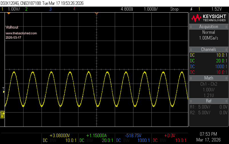

Could you please undo the changes in RC4/RC6, where calculations where taken out of the HW interrupt. The earlier versions had a nice soft transition to the next sinewave. rc6 does not have that anymore.
This is a varying frequency tone on rc2, using Frank 's program. Nice sine waves with smooth varying tones.
Play volume 100,100
For z=1 To 4
For n=980 To 1020
 Play tone n,n
 Pause 2
Next
For n=1020 To 980 Step -1
 Play tone n,n
 Pause 2
Next
Next z
Play volume 0,0
'Play stop

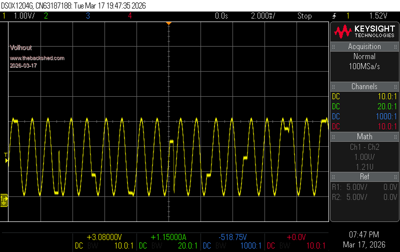

This is the signal of the same program running rc6 (the improved version you fixed for frogger).
RC6
The change is definitely a step back. Please undo this change.

Posts: 12057
Posted: 12:42pm 17 Mar 2026
  Quote  Please undo this change.
No: I'll fix the new code - there was a reason for the change!

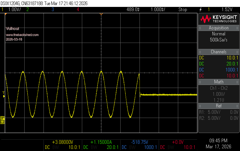

Posts: 6195
Posted: 01:43pm 17 Mar 2026
Peter,
Does not work, the program stops at the first update of PLAY TONE. One sinewave is shown, then nothing after.
Posts: 12057
Posted: 02:10pm 17 Mar 2026
Should be OK now, forgot to clear a flag
VGA
PicoMite.zip
Posts: 6195
Posted: 02:26pm 17 Mar 2026
Hi Peter,
That was confusing... the previous was a microcontroller binary, this is a VGA binary.
Getting closer, there are no irregular transitions between the sine wave changes. But the VOLUME 0,0 is very abrupt, not as smooth as in rc2.
