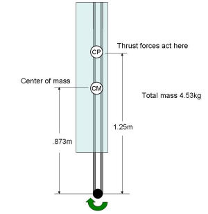

Here's my next model. I kept hitting a brick wall with the stresses getting way too high given the initial assumptions. Go figure, I think any 3.2m dia rotor spinning straight into 65 mph winds at 1000 rpm would fail. Let's take a step back and I am going to 'suggest' some initial conditions. A lot of people have made suggestions and comments and I am trying to incorporate them.
I am trying to model right when the turbine starts to furl. It is seeing the wind perpendicular to rotor at this point. The thrust forces should be highest here. Once it furls it should be slowing down or in a perfect world holding perfectly steady, right?
This model also uses a sched 40 3/4" steel pipe as the internal support rod. No metal rod and thin walled tubing as Oz has suggested.

- 1.5m alum extrusion over 1.625m sched 40 steel pipe
- Furling speed for the turbine is 15 m/s (33.6 mph)
- Rotor dia is 3.2 m
- TSR = 5
- Rotor Cp is .30 which has an associated axial induction factor (a) of .019

Calculate the centrifugal forces
Fc = M x R x w^2
Fc = (4.53kg) x (.837m) x (46.9rad/sec)^2
Fc = 8331 Newtons = 1873 lbf.
Given the cross sectional area of the pipe of .000214 m^2 we can calculate the tensile stresses in the pipe.
tensile stress = F / A = (8331 N)/(.000214 m^2)
tensile stress = 38 MPa = 5511 psi.

Determine the bending moment this force applies to the blade root
I am applying the force at the 3/4 point of the blade towards the tip
M = force x distance
M = 122N x 1.25m
M = 152.5 N-m
Calculate the stress in the pipe at the root
c for the pipe is the pipe radius. moment of inertia (I) is 1.54x10-8
stress = M x c / I
stress = (152.5N-m)(.0134m)/(1.54x10-8)
stress = 132 MPa = 19.1 ksi
We can now add the stresses together
total stress = centrifugal stress + bending stress
total stress = (38 Mpa)(132 MPa)
total stress = 170 MPa = 24.7 ksi

oztules
Joined: 26/07/2007
Posts: 1686
Posted: 09:50am 01 Dec 2009
Your a wizard Perry.
This seems to be more in the realms of what I would anticipate. I think a single supporting member is simple and less likely to fail from poor assembly and stress points. My hubs are made from 14"x 8mm mild steel disks (x2) so my hub would definitely hold these forces in check. The turning center is a 4000lb trailer stub axle... easily rated I should think for this application. It would only see thrust and turning moments from yawing the hub/blade assembly.
Do you have a feel for the magnitude of the yaw forces when turning this gyro in the wind? I'm told that they are of similar magnitude to the thrust.... but of an oscillatory nature.
I suspect that the reason this was said, is that in this application, the thrust is related to the furling/yawing system... as the thrust increases, we furl out of the way.... or the tail exerts less turning moment on the mill than the mill exerts on the tail via the offset.
I find it difficult to see how to equate the spinning mass to what the tube and the hub would see. I guess it depends on the rate of turn involved...controlled by the weight of the tail and the pivot angle used. How do we quantify that.... it all gets a bit murky about now.
