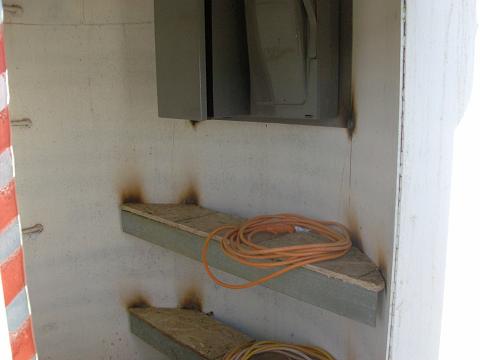

I also took this picture of the control box's and shelves.
The area inside being only 5 1/2 feet is alittle tight to be able to take a good picture, so this was taken looking through the doorway. Yes, thats a 3 phase 480 volt disconnect with 3- 100 amp time delay fuses. The other box to the left is for electrical controls and components. Slowly comeing together.
.....Mac46

Hi Mac
Lookin good. the weight of the batteries will stop it being blown away.

Everyone,
I'm not worried about it blowing away...but the weight of the batteries could'nt hurt a thing. I wanted them up off the cement floor and as close to the disconnect box as possible- within reason. I hope to have a simple incloseure for them built before winter arrives.(maybe I'll have this thing together by then).
Mother nature threw her furry at us last night, quite a storm, no damage to anything, just a bunch of small limbs in the yard, nothing serious.

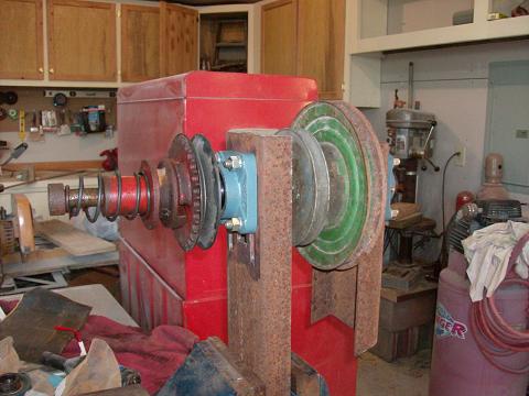

For starters I'm going to be installing a simple GM tractor alternator,(12 volt), and also I will be installing an air compressor. At this point in the game, I truthfully have no idea what to expect for output preformance...especially in my 10 mph average wind area. I know that the mill probably won't even know the alternator is even there, but you have to start somewhere.
The mill and wings did survive a sustained 50 mph wind storm with gusts well above this, but it was bolted down and stationary in its "parking clamps".
Today I managed to install the secondary driven shaft assembly.
This is it in the vice, notice the clutch assembley. I also changed out 2 of the 3 shives before instillation. I also had a contest with "Mr. Murphy" again today, I had a blown tire on the field cultivator to repair and he was not wanting to let me get the rim off the hubb, then he would'nt let me get the tire beds loose from the rim...I spent 1/2 a day on that silly tire...but I showed him who's the boss. There's nothing like working in the mudd to make my day.
.....Mac46

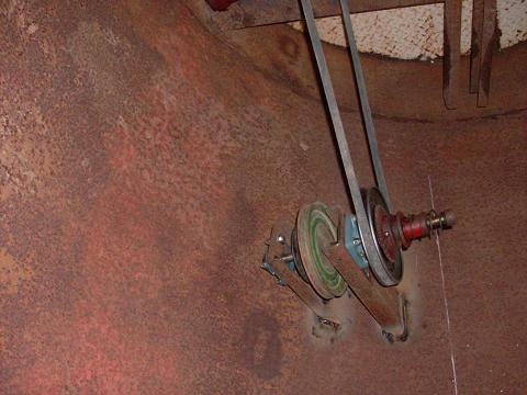

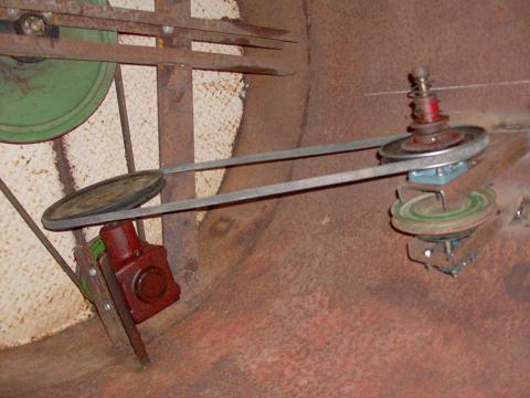

.....Everyone,
You can see that I have an assortment of colored parts, some off of different pieces of old (junk machinery), some new from the tractor supply store.
This is looking almost straight up, inside the mill base. The camera is giveing a distorted picture...the white chalk line is vertical and plum, its located just to the right of the clutch shaft assembly. The main pulley is off a old combine and is 18" diameter and powers the right angle gear box, 1 to 1 ratio on the gears, but it has a 8" input and a 12" output shive, this feeds the clutch assembly witch has a 8" shive comeing in.
The disc break is located above the large center pully on the main shaft, I have'nt completed that portion of the project yet. If it continues to rain I'll get alot more done on this thing.
Thank you all for you'r comments and guidance.

Posted: 07:40am 25 May 2011
Looking good there mac, but looking at that latest pic does show one concern I can see. In time those Vee-belts will loosen off and become sloppy. From what I can see there is no adjustments for belt tightness and by moving one would put the other out of alignment. Personally I would put in a couple of spring based belt tensionors then one would never have to worry about a loose Vee belt coming off and turbine spinning free to destruction.

Bryan1, everyone,
Yes, and thank you for pointing this out, but there are slots where the mounting bolts go through, so tightening the belts is possible. See the assembley in the vice photo, shows 2" of adjustment. The right angle gear box also has adjustment slots. Spring loaded tensionors are a very good way to keep the tension on the belts, I have plans to install them, have'nt taken the time to do this yet, still setting up the main drive line. "I also need to install the mounting brackets for the other side of the right angle gearbox.
I have enough room on the clutch shaft assembly to drift it latteraly in the bearings to adjust for alignment problems. "A bit of a pain, but it can be done". A better way would have been to set up a second anchor frame "holding the clutch mounting frames", in the same plain as the upper gearbox mountings. that way they could be drifted together to maintain alignments. As it is, I have lots of spring loaded tensioners on the old machinery I will put to good use.
Installing this stuff inside of a round container is a real battle, I have resorted to a plum line, a level, and a stright string, to make sense of it.
That is a very vital point you have pointed out, thank you for posting.
