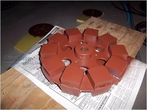

Few folks are building generators with ferrite magnets so Glenn's project is quite interesting. I'd like to find out more about those magnets he's using because he's getting more flux density in the air gap than my gauss meter showed my ferrite blocks had at the surface of the magnet. I used C5 blocks and they're supposed to be about .35 mTesla in the core of the magnet, which is about 1/3 of what a N42 neo is. And that's about what I got in the air gap - 1/3 of what the neos are.
I used a larger (50mm x 50mm x 25mm thick) block that has twice the surface area, and twice the thickness of the neo magnets I normally use, so I ended up not having to use three times the turns of wire. But Glenn's design is quite amazing using the two magnets per generator pole.

Yes, I suspect you're right. I had to "scrunch" my magnets closer together to get 10 poles to fit on 280mm rotors and I may be losing a bit of magnetic performance at the inside corners where the magnets are about 8mm apart. See the attached photo of the center rotor to visualize what I mean.
I know another fellow from Ireland that built a 5 meter machine using two 50mm x 25mm bars arranged in a "tee" configuration for each generator pole. He also got good results by using more than one magnet per pole.
