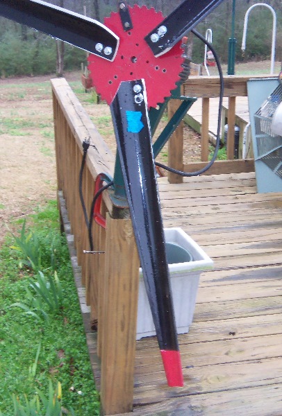

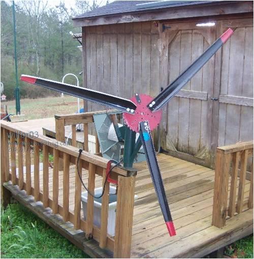

WILFOR03 Tell me more about your blades maybe a picture what size pvc did you cut them from?
Did you remove the encoder and break in the back of the motor?
Isaiah
Made these from 4" PVC pipe from Lowes. Cut it into three sections 36" long, then
measured off 1 3/4" on the right side (tip), ran a paint tape down to the opposite
bottom corner (root)for a straight line to cut on, then rounded over the leading edge
and feathered the trailing edge for a knife like shape. Whoala....took maybe a half
hour for all three. Balancing takes a lot longer than building them.
I've built these with only testing in mind, wooden(chainsaw) blades will follow
once I like what I'm comfortable with. Here's a couple pictures for ya. Hollar if
I can help with anything else......

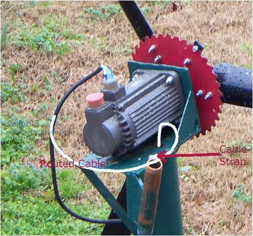

What do you do with the drop wires? do you drop them through the mast pipe or let them dangle on the outside.IM working on some Idea's for a new mount .
wilfor03
Joined: 22/03/2009
Posts: 5
Posted: 03:50pm 29 Jan 2012
  isaiah said   wilfor03
Hey Isaiah....
I just route my servo wires through a cable strap on the motor mount, then down through
a 3/4" hole through the bearing on top of the tower pole/mount and then into a 20a male/female extension cord plug (down about 2' inside the tower pipe). The plugs are wired together with coat hanger straps and electrical tape to keep them from wiggling apart. Just a quick change way of swapping out motors when I want. Been working for over a year now pretty well.
Hope this helps you out a bit 'n let me know if ya need anything else.

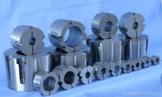

I weld on a taper-lock hub and then it's done.
The smaller machines (under 1000 watts) get just
a sprocket with the taper-lock hub (maybe $10)and larger
machines get a more substantial taper-lock hub (maybe $25).
Then the bushing for the shaft size.

Bill, taper lock fittings have become a world standard way of fitting pulleys and sprockets to various sized shafts.
The blue thing is the taper lock bushing.
While the taper bored into the pulley is standard, you can then buy suitable taper lock bushings to fit a very wide range of shaft sizes in both metric and imperial sizes.
These can be bought anywhere in the world, from companies that sell industrial drive hardware.
Being tapered, it shrinks down onto the shaft with enormous force once the screws are tightened. By removing the screws and reinserting them into alternative threaded holes, the same screws become jacking screws to separate the taper from the pulley.
Very ingenious, and a very effective way to secure something to a shaft.
