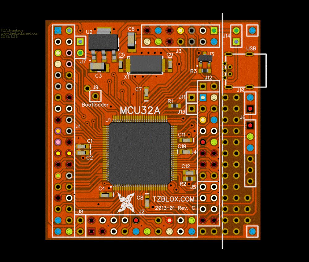

Hi Tz,
An interesting PCB, Actually near beautiful..

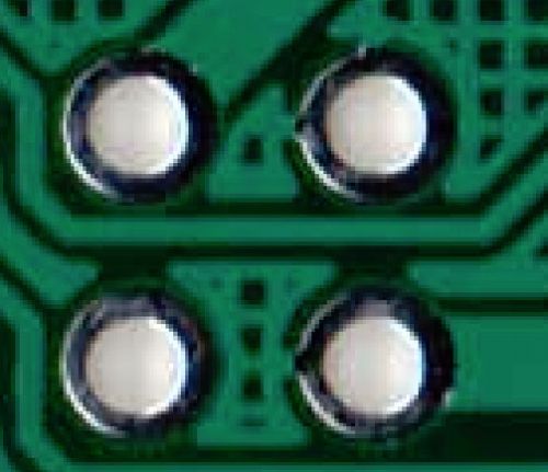

One constructive criticism is that the Pad holes that are GND are fully connected to the GND plane (Polygon fill) and that might make it difficult to get enough heat into those pins to solder easilly.
See the Right hand Pair of these pads , below, to see what I mean.. They are connected to the Polygon GND fill but only by small traces (usally 4 , top, bottom, left and right) to the large GND fill.
This allows the pins to be soldered without a lot of heat being applied.
EDIT***
Actually not a great photo but was a quick scan... If you like I will cut and paste from Protel to show what I mean.
MickEdited by bigmik 2013-01-29

Thanks for the feedback.
I fixed the 0.1" grid. I had to move one connector to have more space for traces but i found another way to route it (all manual as autoroute does not give good results).
The footprint for the caps close to the regulator are on 1206, for smd that is already rather big. :)
For C1, i routed the board with a 0603 as that as the size for a X5R, making it bigger will require major rerouting and searching the web i found a few alternative brands with the same 0603 footprint.
The copper pour is now with thermals. Have to clean up some manual routed traces that interfere with that.
@robert and @mik.
When you use reflow would large copper contact not be better, like when used on a hot plate?
Or is the 4 spokes a good compromise for smd parts.
For through hole i have experienced the advantage of thermals. :)

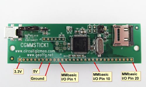

  TZAdvantage said
Size of the board is 50mm x 49mm.
That is only slightly more board area than the CGMMSTICK, and you placed a 100 pin chip instead of the smaller 64-pin. Good job!
Edited by CircuitGizmos 2013-01-29

I moved the supervisory chip to another place and that will allow an even smaller versions of the board. Everything is on 0.1" grid.
The cut of line will be right next to the connectors, cutting of the micro usb and icsp. It will then be 50x40. :)
Good if space is a premium.
Still allows usb and icsp connection through the existing connectors.
I have dropped the diode that protects if you have usb and external power at the same time and replaced it with a header so that a choice can be made to use diodes or a switch.

Posted: 10:48am 28 Jan 2013
Few hours later, eyes half closed. :)
Moved some parts around, made a cutoff area if you don't want USB and ICSP on the board and added a mini 'sea of holes' or maybe better named a 'lake of holes'.
Added headers to breakout the USB pins.
Color coded the pins in use by maximite. (
Light green/dark green center = 3.3v
light green/greyblue center = 5v
blue/blue center = vss
White = PIN1-20
Darkred = Arduino pins
Grey = SD card
Yellow/Red/Green/Blue = VGA,
Black/Red center = reset

Posted: 11:30am 28 Jan 2013
Very impressive.
[quote]Few hours later, eyes half closed. :)[/quote]
Yeah, I know what you mean. Sometimes when designing boards, I find myself at all crazy hours of the morning, slumped over the computer when I should be in bed asleep!!!

  TZAdvantage said
@robert and @mik.
Hi TZ,
I am no expert on Reflow solder.. (In fact I am not an expert on much these days) but you did say that it was for Proto and Production.. I was commenting on it from a hand soldered perspective..
