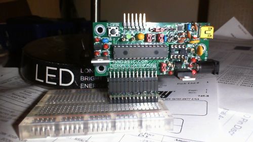

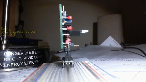

Zonker
Joined: 18/08/2012
Posts: 772
Posted: 05:58pm 15 Mar 2014
Evening Gents...
Ok... Just got back from Lou's place, after spending the afternoon getting the stuff organized. Lou managed to get another DFN stuck on using a mag-lamp and a good bit of luck.. So, I think it's going to be doable. The good news is the boss at work let me take off a week so we can get a double teem thing going on these units. One thing I would like to try is using a fitting jig to make sure the part is sitting just right. I was thinking of using a tiny drop of that lock-tight SMD glue to stick the part to the PCB, let it dry, then try soldering it. I hope it would be an easier operation without worrying about the part moving around as your moving the iron around. Anyway, I fitted a right angle male connector to a finished board an plugged it into a 200 to 300 center converter board.
Mounting it vertical seems to leave plenty of space on the vector board...
I also managed to locate a female connector that could be used if the board was being used in the stacking configuration... So, I will take a look at getting all the numbers and pricing stuff done Sunday after church. Then Monday we will give it a go making a small group of ready to go units for shipping out...
PS: For those of you who would like to try building these yourself, just send me a PM saying what you want. We have all the parts to go with the bare board and could kit them up and send them out during the week... More info soon...
EDIT: After a trip to Lou's place to grab the parts, I got setup at work and spent the morning creating a reference jig to hold the DFN's in place. With the help of the nice staged microscope at work, I managed to get 4 of the DFN,s fitted to the PCB's... I think I'm getting the hang of this... The jig is working great..! I hope to put in more time at it tomorrow..
Edited by Zonker 2014-03-19

Zonker
Joined: 18/08/2012
Posts: 772
Posted: 04:37pm 18 Mar 2014
Evening Gents...
Got the first 10 pack of boards "DFN'ed" using the jig and microscope.. Lou stopped by the shop to grab em up, so I gave him a nickel tour of the place.. Ok.. Double team time... Starting the next 10 tomorrow..
EDIT: @Cronic.. The schematic show jumpers for control of the OB USB.. There is power selections as well..Edited by Zonker 2014-03-20
