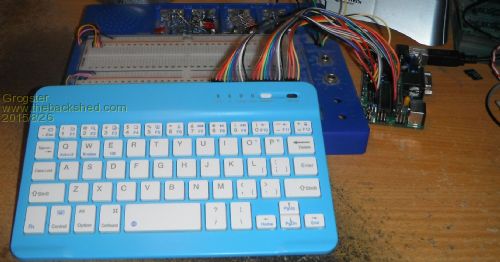

UPDATE:
Here we have the running prototype - excuse the rats-nest of wiring.....
...and the results on the console...
This is just initial testing - the code needs tweaked some more, but basic keyboard is working fine, and I have the 170 MM chip throttled back to 10MHz, AND with a 100ms delay between keypresses. Matrix scanner code is crude by some members' standards - just a whole heap of IF/THEN lines inside a loop. Loop completes in 25ms @ 10MHz, and is down to about 9ms @ 48MHz, but you don't need it to run that fast, really, just for scanning a matrix.

Hi G,
Nice
Can you clarify something for me please. What 'electrical connection' is being used to connect the keyboard to the MM for it to 'drive' the onboard console? Is it through a serial port? If so, which pins?
Also, is there drive for caps LED?
Been keeping my eye on this thread with great interest and am keen to try things that you have achieved so far.

  WhiteWizzard said  Can you clarify something for me please. What 'electrical connection' is being used to connect the keyboard to the MM for it to 'drive' the onboard console? Is it through a serial port? If so, which pins?
Hi-de-hi.
The output from this experiment is via the native MM console pins.
These would connect directly to the console of another MM, or any other serial port.
At the moment, the code basically ignores console RXD, and is an output device only.
'Power' LED on KB is lit, and blinks when you type anything(not shown).
'CAPS' LED on KB is driven from an IO pin, and the PCB I have made allows for both these LED's in their original locations, so they will show up through the case like they would have before I got hold of it. The other two LED's are NOT allowed for.
I only have lower-case working at this point - I need to add more flags for shift and caps etc, so that in the output routine, I can just make use of MM's UCASE$ function.

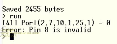

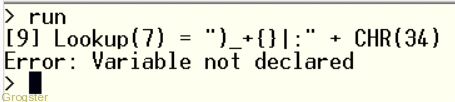

Hi. Result:
EDIT: Ignore - should be CHR$(34).....
EDIT: Port errors:
Edited by Grogster 2015-08-28
Posts: 6607
Posted: 07:48pm 26 Aug 2015
Try
PORT(2,6,9,2,25,1)
JimEdited by TassyJim 2015-08-28

Thanks for testing! Some stupid little mistakes.
That PORT command is fighting me all the time. I would have preferred just a list of pins instead of the pin,count pairs just like in the other commands like LCD and KEYPAD.
I just got some mail. This weekend will be fun.

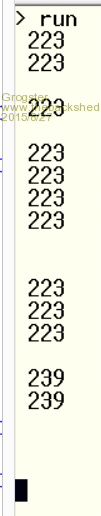

Posts: 10044
Posted: 11:13pm 26 Aug 2015
Results:
This is with the change you requested - OR changed to AND on line 75.

Posted: 11:29pm 26 Aug 2015
Well obvious something is not working as expected.
What should happen is that after a keypress is detected it goes into the ScanMatrix$ function which starts a full scan.
It does see the keypress but it does not determine which column.
The code should test each bit in the ScanCode for a 0.
If it finds one then you have a row and column number.
That IF statement after the FOR is not doing what i expected. I tested that in MMBasic for DOS and it worked. Is there a difference in versions when 64 bit integers were introduced?
If i just use
[code]
print (239 AND (2 ^ 4))
[/code]
i get 0, and that is right.
I'm puzzled.....

Grogs,
Can you please post TZA's code with all the updates you have made from suggestions posted. This is so we can eliminate any 'silly' typo's/errors i.e. have you changed both PORT commands in the SetRow sub (if not then it won't work).
TZA,
I think you may find that in you SetRow sub, then the following line (in the ELSE section):
PORT(2,7,10,1,25,1) = 512 - (2 ^ value)
needs to be ... = 511 - (2 ^ value) otherwise you have too many 0's!!
ALSO
SetRow(RowNumber) in ScanMatrix (under the first DO) you will need to change to SetRow(RowNumber + 1)
Make these two changes and you should progress further . . .
WW
These two changes simply give you a correct value to compare with - there may still be other issues which will be easy to detect once the most recent version of TZAs code is posted
