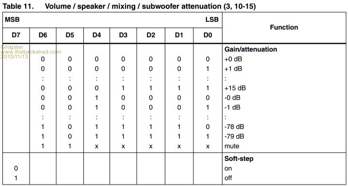

Not a fan of the dB scale for volume controls, then?
Just about all commercial amps use the dB scale, but I have to agree with those who say that bigger numbers equal more volume - nice and easy to understand etc...
I have a problem with the way that the 7419 chip deals with the volume past 0dB, but will post about that later. Basically, +1dB to +15dB are byte values 1-15, but -1dB to -79dB are byte values 16-95. SO, if you volume DOWN past byte value 16, the volume suddenly jumps from 0dB to +15dB - not good, so I have to work out how the hell to get around that!

A crude translation of user input level fro zero to 95
translated to the corresponding 7419 values.
FOR gain_user = 0 TO 96
gain_device = gain_xlate(gain_user)
PRINT gain_user,gain_device," ",RIGHT$("00000000"+BIN$(gain_device),8)
NEXT gain_user
END
FUNCTION gain_xlate(a)
LOCAL b
' zero = mute
'1 = -79dB
b=max(a,0)
b=min(a,95)
IF b = 0 THEN
gain_xlate=96
ELSEIF b > 79 THEN
gain_xlate=b-80
ELSE
gain_xlate=96-b
END IF
END FUNCTION

You may not need the sanity checks - MAX and MIN if you have done that elsewhere.
If you don't want soft-step, add 128 decimal to the value.

volout(0) = 96 'mute
volout(1) = 95
volout(2) = 94
volout(3) = 93
volout(79) =16
volout(80) = 0
volout(81) = 1
volout(82) = 2
volout(83) = 3
volout(97) = 15
do
if btn-vol-up then vol = vol + 1
if btn-vol-down then vol = vol - 1
output_to_device = volout(vol)
loopEdited by ajkw 2015-11-14
Posts: 10043
Posted: 12:16am 13 Nov 2015
Thanks for the comments, fellas. I do like the array idea, and that would also allow me to have a 00-99 type volume control.

Personally I like it db and code below solves the TDA7419's odd volume scale problem
The DisplayVolume Sub takes care of the sign so the display is from +15 to -80
Sub VolumeUp
Volume = Volume + 1
If Volume >= 15 Then Volume = 15
If Volume < 0 Then
VolumeD = (Volume * -1) + 16
Else
VolumeD=Volume
EndIf
DisplayVolume
End Sub
Sub VolumeDown
Volume = Volume -1
If Volume <= -80 Then Volume=-80
If Volume < 0 Then
Else
VolumeD=volume
EndIf
DisplayVolume
End Sub

Special thanks to jman, as he is helping out lots(via email) with the mathematics of the code for the 7419, leaving me to concentrate on the GUI and other stuff. I am also learning heaps about manipulating bits in a byte, which I was totally lost with at the start, so it's all good.
That bloody 7419 volume scale is odd that they don't have sequential data byte values from one end of the scale to the other. What were ST thinking when they made it like that?!(rhetorical)

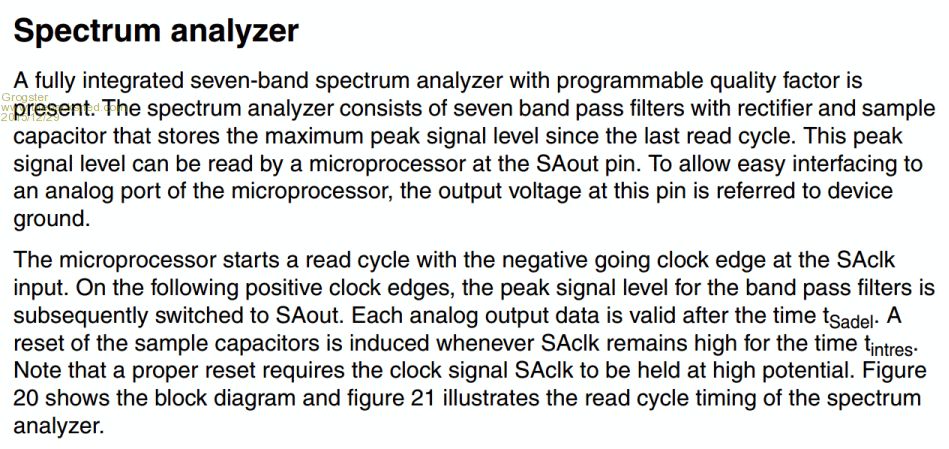

The Spectrum Analyser works with the original SPI LCD and a MX170 but runs a little slow matherp kindly wrote a driver for the ILI9325 parallel LCD with this driver
running on MM+ (64pin) the Spectrum Analyser now runs really well
Spectrum Analyser

Would the spectrum analyser 'software' work on 'any' MM TFT (i.e. SPI or Parallel) or is it specific to the ILI9325.
I am fully aware about speed - just wondering if it would work at all on a SPI TFT 'as is'.
Thanks - and keep up the great work . . . .
WW
EDIT: And how about it running on a SSD1963... ?
sorry for all the questions Edited by WhiteWizzard 2015-12-30

Phil - the analyser is supplied by the 7419 audio processor chip, and jman's code just talks to the 7419 to get this data, then plot the bars on the screen. So, you need the 7419 chip and audio going through it before you could use the analyser output.
From the 7419 manual:
Anything's possible, but I would expect the answer to your question is no.....
Posts: 2991
Posted: 12:29am 29 Dec 2015
Thanks G - that's useful info
