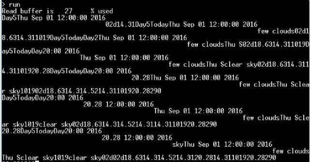

It's "KINDA" working
It now prints this
BUT prints every 4 items one after the other until it does this
FieldArray$(Count) = FieldArray$(Count) + Chr$(char)
Error: String too long
I think I need to clear the FieldArray$ when I close the serial port but not sure how to do this
I also need to put a line feed after each item is printed, I THOUGHT I had done that by adding ; at the end of the print statement

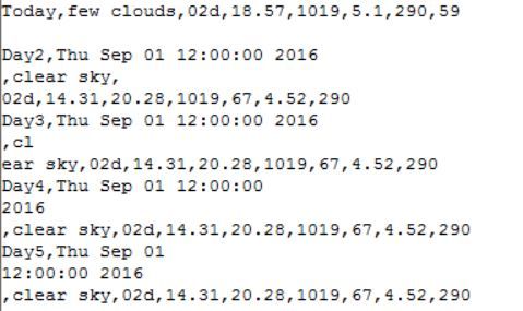

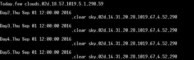

For clarity here is the information being received on Com3
[quote]Today,few clouds,02d,18.59,1019,5.1,290,59
Day2,Thu Sep 01 12:00:00 2016,clear sky,02d,14.31,20.28,1019,67,4.52,290
Day3,Thu Sep 01 12:00:00 2016,clear sky,02d,14.31,20.28,1019,67,4.52,290
Day4,Thu Sep 01 12:00:00 2016,clear sky,02d,14.31,20.28,1019,67,4.52,290
Day5,Thu Sep 01 12:00:00 2016,clear sky,02d,14.31,20.28,1019,67,4.52,290[/quote]
Here's how the info looks when viewed on Terraterm
and
here's how the info looks viewed on the MMEDIT console
The Function seems to me to be stripping the commas from the received data?
AND it also doesn't clear the count when it receives new data from the com port, it just adds it all up till it crashes
Edited by lew247 2016-09-01
Posts: 2991
Posted: 08:24am 31 Aug 2016
The semi-colon at the end of a PRINT statement will PREVENT the linefeed. Simply remove the semicolon!
Posts: 2991
Posted: 08:36am 31 Aug 2016
To 'empty' an array element I would simply set it to an empty string AFTER you have finished with the element.
So for example; if you want to simply print the data contained in FieldArray$(7) then use:
PRINT FieldArray$(7): FieldArray$(7)=""

[quote]FieldArray$(Count) = FieldArray$(Count) + Chr$(char)
Error: String too long[/quote]
The FieldArray$ is still counting after printing, I need to find a way to clear the whole FieldArray$ after I've finished printing the elements I need so it's empty for the next serial input
