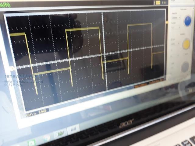

Frigg, I got the thing going by disabling driver signatures.
This was the inverter
And this was the mains
So looks like I'm not using it right
Edited by renewableMark 2017-12-27

What voltage are you sampling? I wonder if you are getting signal clipping as you need to run maybe an x10 divider for your input signal due to the high voltage level.
My little DSO toy, the one mentioned above can only handle 50v Pk, so I got a cheap x10 probe for it, or else it will be cooked.
Ralph

OK that was on 100x on the probe.
I really have no idea how to use it, better look at some vids.Edited by renewableMark 2017-12-27

PC? That would be bad. Sounds like you connected the probes ground lead to a live source and the PC was grounded to earth. Only a laptop "floats" and not to any real agency standards.
Any time I see a flat top it is a good indicator that the input is clipped. There should always be some noise on the trace. I wish they would eliminate red as a trace color option and turn that section of the trace red that has reached the A/D limits. There is no AC input that removes the DC content. I have a capacitor with a clip attached handy for that.

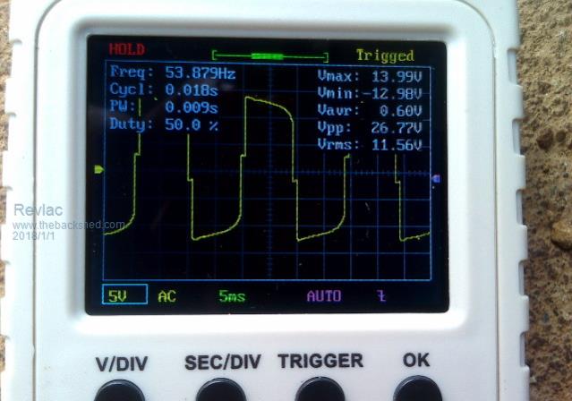

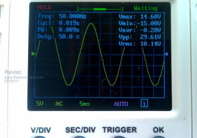

Found out my long battery lead was picking up some noise from power cords and other things.
using the 12v transformer the results are pretty good.
This was the wave on the HF inverter which looks ok, I could pick up the high frequency with some adjustment.
This one if from a YUK (Modified square wave) Plunged the transformer in and could here the buzzing.
