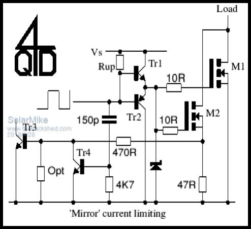

Here is an example of using a current mirror to sense current drawn from a single mosfet, this could be one of the lower devices in the H-Bridge. The on resistance of the Main load mosfet (M1) has a very small voltage developed across it due to its load current, this current is mirrored by the second device (M2) and is sensed as a much higher voltage across the 47r load by TR3.
Something like this could be used to sense abnormal currents at the 23Khz switching rate and shutdown the drive. Normally current mirrors require matched devices usually on the same silicon, however we do not require absolute accuracy, just an extreme overload condition, so it should work.

Mike, not sure how well that will work in our particular situation.
The voltage developed across M2 and the 47 ohm can never be greater than the drain source saturation voltage developed across M1.
For Tr3 to turn on that would need to be something greater than 600mV.
Here is a link giving some more details of this mirror measurement method:
https://www.onsemi.com/pub/Collateral/AND8093-D.PDF
Lets think about this.
Current limit set point maybe 25 amps rms in secondary or 35 amps peak.
Toroid ratio 9:1
Peak current in primary 315 amps.
If there are four HY4008 mosfets, say 79 amps per mosfet.
If the Rds on of a HY4008 is perhaps 2.9 milliohms that gives us 229mV of saturation voltage at 79 amps.
It should work if Tr3 was a fast voltage comparator instead of a bipolar transistor.
Definitely worth a try.Edited by Warpspeed 2018-09-29

>> Another possible gremlin is gate source capacitance of M2 putting a big current spike into the 47 ohm resistor during M2 turn on.
This is blanked by TR4 and the 150p cap at turn on.
The cct was only a suggestion, TR3 would be in our situation be replaced by a comparator with a settable reference voltage for the trip point.
Many of those Chinese inverters use a sense resistor, 3 or 4 parallel wires on the main pcb in one leg to detect over current, that's not the best as they heat up, we need sensing in both legs, so 2 extra mosfets and a dual comparator.
I think I have convinced myself to try this out.
Mike

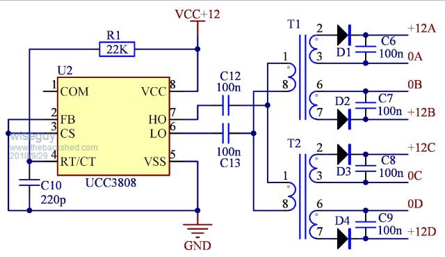

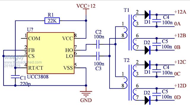

Time to start putting all this stuff into practice. Warp this is my isolated gate power supply circuit, transformer is 1:1:1. In your opinion do I need to check all voltages are ok or check 1 or just assume they are all ok. There does not appear to be an enable in the FET buffer or UVLO (TC4452) - did you do anything special about this?
PS ignore duplicated part numbers - a hazard of copy/paste.....
Edited by wiseguy 2018-09-30

Hi wiseguy, in your schematic if the intent is to have +12B and +12D as shown, I think the D2's should be connected like the D1's.
Or better:
Keep the D2's as shown and re-label the nets:
+12B to 0B
0B to +12B
+12D to 0D
0D to +12D
Edited by tinyt 2018-09-30

Hi Tiny good to hear from you again - thanks for the comments - you noticed my intentional confusion & unintentional confusion you are correct the nets are not labelled correctly.
I have used similar circuits many times for this function. Essentially the PWM IC outputs a push pull 12V squarewave and transforms this to the secondary. If it was a flyback circuit the phasing would be wrong. My scheme is a bit mean for the driver IC as there is no current limiting, just the diode and a capacitor. If we do all 4 outputs phased exactly the same way it makes half the push pull driving circuit do all the work. By antiphasing two supply windings it makes the other half of the IC driver do some work also - share the load.
I'm always happy to receive comments like this though it has helped avoid an error.
On my prototype when I lashed it up I could easily draw ~ 100mA from the one transformer and maintain ~11V - there will also be electrolytics or tantalums ~ 22uF - 47uF for the final circuit.
Cheers Mike
Posted: 05:38am 29 Sep 2018
  wiseguy said
That 57P1805A is rated for 20 amps, 100 ohm load, 0.1v per amp, 2v max output.
Can we just ignore that its rated at 60Hz? I also would have felt more comfortable if the termination was listed as Typ,100R instead of Max,100R (at 60 Hz?) for those reasons I thought a linearity check might be in order and to go for 1/2 max load? I'm always willing to learn...[/quote]
Should work fine 50Hz or 60Hz. In theory the flux density in the core at 50Hz will be 20% higher but it really does not matter. We are not using this current transformer for very accurate current measurement, only as a rough measurement of overload indication, so any very slight non linearity is of no real consequence.
One hundred ohms is the recommended load to get the full available 2v at 20amps.
If you only wanted 200mV at 20 amps (to drive a digital panel meter for example) ten ohms would be ideal. It puts out a current, so you select the burden resistor to give the desired voltage.
Your isolated power supply looks fine, I have used something similar in my inverters in the past. One thing I did notice though, is that at very low load some pulse transformers can sometimes overshoot or ring. That can cause the dc output voltages to become surprisingly high and uneven. Suggest you make provision for a 12v zener on the output of each isolated supply to tame at very light load.

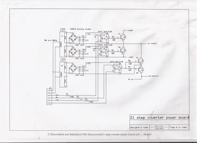

Posted: 09:02am 29 Sep 2018
This is an old circuit going back to 2015.
It uses a very similar isolated supply concept to yours, its for +15 volts. and ran at 50Khz. The pulse transformers were commercial SCR gate trigger transformers.
The HCPL gate drivers have a built in under voltage shut down with a threshold of around +11v, and this circuit also uses the inverse opto isolator trick for the half bridge part of the circuit.
Never had any problems with it blowing up until the crystal oscillator started to give trouble because of shorts between the pads and the crystal's metal can. Other than that it has run reliably powering my house for almost three years, and is still running now.
I discovered two things during prototype testing of this circuit. It would not work reliably at +12v, that was too close to the +11v under voltage shut down, so had to wind up the wick to +15v at the 50Khz driver.
The other problem was that the +15v supplies were pretty wild going up to almost +20v which was dangerously high for the HCPL3120's. Some 600mW 15v zeners fixed that.
And its worked very reliably switching at quite low frequency of course.
