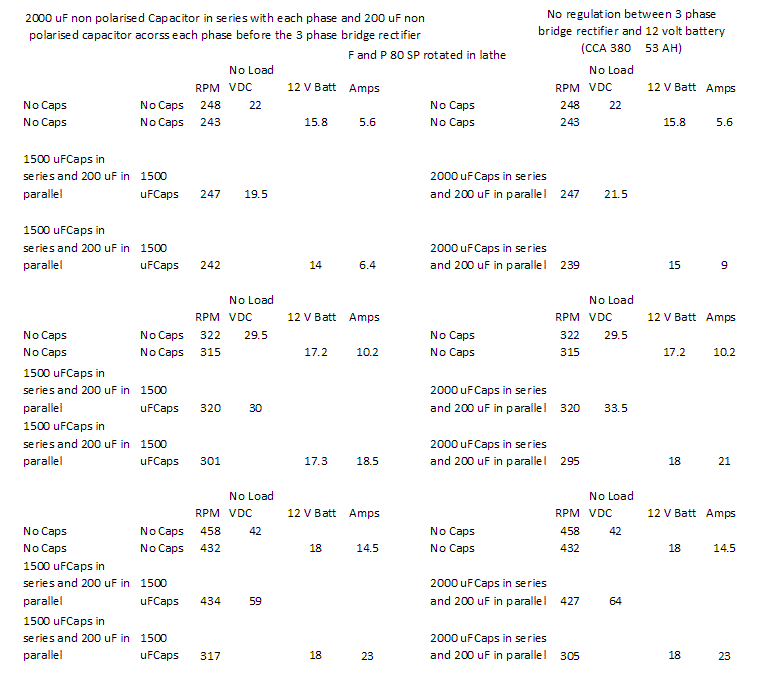

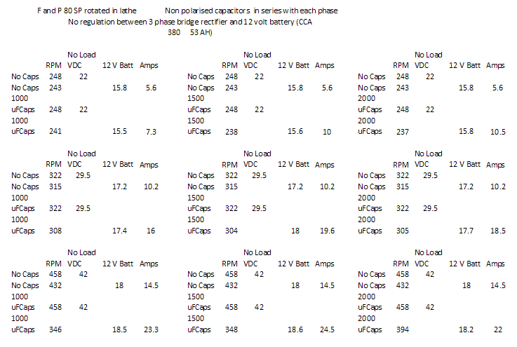

Have been watching this topic so decided to put a F&P 80 SP in the lathe and connect up some non polarised capacitors (created from 2 1000 electrolytic caps connected back to back "neg to neg")in series with each phase. See attached chart for results. One of the unfortunate results is that the motor on the lathe needs some more grunt as it suffers from rpm sag as the load goes up.

We have done all our testing using 24 volts and a large battery bank. Using 2 by 12 volt to give a 24 volt load creates a problem to a motor driving the F and P. This results in the load you talk about and it a bigger problem at 12 volts. Early on we tried 12 and 48 volts then settled for 24 volts. It is much better and most of us use it and it does not muddy the waters when comparing results.The max uf caps we use has been 400uf and it appears about 250 uf is the best match. In closing non polorised caps work the best. Regards Dennis L

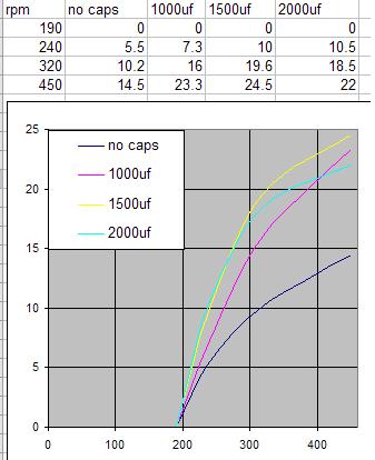

Hi 9c12m,
Is this a std rewire, series80, 2S7P?
I took the liberty of plotting your data. I do not know the input power, so cannot comment on how a windmill would see this change in output current v rpm.
The better combination appears to be around 1500uF. As the capacitance is increased, eventually, the with cap and without will produce the same results. How the blades handle the additional loading and how this affects power output will be interesting.
I would expect the 12V system is causing some stator overloading. Caps are providing a significant boost to output power, and this appears to be across the speed range as well. This is similar to my mill results.
I extrapolated down to approx 0 amps, and the cutin does not appear to be changed with caps. Hopefully you can test with a parallel arrangement as well, to see if the cutin voltage can be reduced as well. I would start with a cap value of half the series cap size. ie 500uF at the 12V levels.
Gordon.
PS edit,
unfortunately, the graphs still go the wrong way as the rpm increases. Ideally for a doubling of rpm, there should be 8x more current, so no maximising function here. If the blades can still drive the alternator to these rpm, then the extra current will become available though.Edited by GWatPE 2008-10-06
become more energy aware

Hi Gordon,
It is a standard F&P 80 of 42 coils and 14 magnet blocks rewired as per the instructions of this website as 7 groups of 2 poles star configuration.
As it happens I had already run a test with 200 uF non polarised caps in parallel between the series caps and the 3 phase bridge rectifier so I have attached that chart to provide some idea of where the results are heading. Might think of a higher value. Will look in the junk box.
What I find interesting is that at 427 rpm with 2000uF series caps and 200uF parallel caps the no load voltage jumps to 64 vdc. I now think that my old lathe motor needs more get up and go to provide more meaningful data at the high current loads. A rough connection circuit is also below.
Replaced with star.......
Cheers 9c12m
Edited by 9c12m 2008-10-06

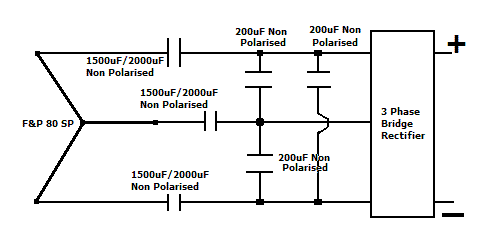

Gill
Joined: 11/11/2006
Posts: 669
Posted: 10:06am 05 Oct 2008
Thanks 9c12m,
That's the simple report I am hoping to see for the full range of F&P series and configurations. It'll give us a good start point to boosting power on all the variety in use. Still a lot of blanks to fill in though.
Unfortunately you don't state if this is Star or Delta or if the 80SP is 3 phase, 2 in series times 7 in parallel or 7 in series times 2 in parallel? Unfortunately there are these short-cut codes around that instead of making it clear and convenient only leave us confused from their ambiguity. That 80SP code introduced by Ecoinnovation is a case in point. Please clarify so we can tick that one as done?
Cheers Gill _Cairns, FNQ
Gill
Joined: 11/11/2006
Posts: 669
Posted: 10:18am 05 Oct 2008
Seems we were both writing at the same time.
I'm thinking your battery may be overcharged as per the 18 volt readings. Maybe dump some power from the battery and see if the readings are same?
Also in the text you say Star but the circuit shows Delta, hate to be a pain but these contradictions confuse me. Edited by Gill 2008-10-06

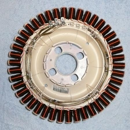

9c12m
Joined: 04/09/2007
Posts: 28
Posted: 12:04pm 05 Oct 2008
Hi Gill,
Thanks for that Star/Delta check. Not enough coffee and have updated cct.
Just to be on the safe side re the type of F&P stator I am using I have provided an image and hopefully with enough clarity for it to be correctly identified. So please let me know when you get a chance to have a look at it. The windings are .75mm - .78mm dia which I understand to be the 80 series.
I hooked up an old aux motor from an aircraft to the 12 volt battery and let it run for a few minutes until the battery voltage dropped down to 10 volts and then powered up the lathe. The motor increased its rpm (high pitched scream) and the F&P with 2000 uF caps in series with the 200uF caps in parallel provided a reading of 15 volts and 25 amps at 305 RPM. This rpm is down some 153 rpms hence my thinking that the lathe motor can not provide enough power for the F&P to reach what ever its potential is.
Cheers,

Hi 9c12m,
The picture you present is very clear, your wiring is a star connection for the stator. The stator is the standard rewire, series80, 2S7P. The 2S means, 2 coils in series, and the 7P means, 7 of these groups in parallel. There are of course 3 groups of all this for the 3phase configuration. I have made a stator with this same configuration. cutin for my 27.6V battery was 300rpm.
The capacitors are a series configuration and then there is a parallel configuration as well across the phases[Delta]. It does not seem to matter which side of the series caps, the parallel caps are, on the simulator.
The unloaded voltage gain at the higher rpm with caps is complimented by an unloaded attenuation at the lower rpm with the parallel caps it seems.
I intend to take measurements at discrete input power levels. I intend to record rpm, AC output voltage and current and DC voltage and current and voltage across the series caps when tested, for a range of power levels, up to 700W or so, with a battery load, and also with a boost maximiser. I have the opportunity to recycle the power with my battery inverter setup. The voltage may drop slowly, but this will be minimal with a 2-3kWhr battery reserve. I will only waste the system losses, and my other windmill should keeep the battery topped up.
This is still looking to be a major exercise.
Gordon.
Gill
Joined: 11/11/2006
Posts: 669
Posted: 02:20pm 05 Oct 2008
Gordon,
I don't see what you are hoping to achieve with the caps in parallel whilst the series caps are still fitted. As I understand it, you have the same effect as slightly less series capacitance. Having quired that, I am by no means a master of the Smith chart. Parallel caps may give a lower cut-in and series caps a greater power at higher Fq., but adding the two produces a combined effect of less series cap reactance?
If as you indicate an intention to take 'current and voltage across the series caps' then I think it will vary these readings as to where parallel caps are placed. However I don't see where these particular readings fit in other than a distracting curiosity?

Hi 9c12M
These tests are the best I have seen here.
One simple addition that I seem to have trouble getting across here is to measure the input power.
When testing in my lathe I clamp the shaft in the chuck. I do not support the unit but to stop the stator turning I attach an arm and a spring balance so that it is acting a tangent to the arc the arm would scribe. Now in every test you do measure the force. Watts in = 2 * 3.142*rpm*force*arm length/60
force in newtons. 9.81newtons =1kg
arm length = distance balance attachment to shaft centre in metres.
My results have shown that caps effectivly increase the excitation and allow the FP to produce at a lower rpm all good but there is no power gain. the fact you are dropping rpm with load also confirms this.
I believe that for those not wanting to delve into the reasons its enough to say that adding caps is like increasing the field strength. output volts increase or if tied to batteries the current increases BUT we must supply the increase in power to the input +little extra for excitation. Yes there is a point were it will not work but if we get the characteristics that suit the driving force before that alls good. There is no free lunch here its its a means lowering the generating speed by increasing magnetic field.
