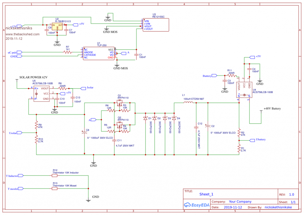

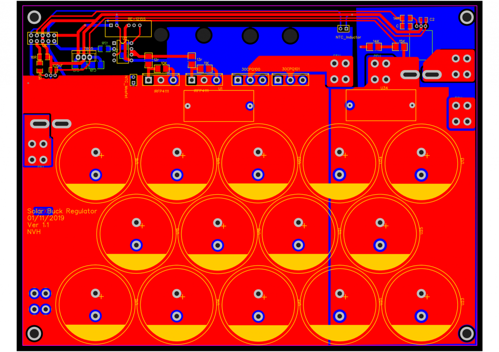

Hi, maybe it's better to discuss the design here Peter and let other people also get involved with it. The more voices the more input. The design is ok and will work electrically , but maybe we can give ourselves at least a week to think about simple improvements. And how connection/layout will be made with the brainbord.
So let's think about the design a bit:
1- If we want to use the Unidirectional current sensor for higher accuracy  we need to check it's polarity. (I'm NOT sure about it.) Let's check also compatible sensors like it's successor acs770? (edit: Also Poida told me there are some nice devices of LEM) If they aren't good enough because of the high noise you noticed maybe we better drop it? Or put them on another smaller boards to put them elsewhere to make them more immune against noise?
2- If I do the board all over again I want this connector (maybe overkill and extra cost), it has a more secure connection, but needs a little bit extra footprint space. Is the current connector well positioned the way it is now?
Connector
3- How are we going to connect the powerboard to the brainbord? If we use the ribbon flat cable will it be ok? Do we need to add extra mounting holes to bolt the brainbord directly on the powerpcb with long bolts or standoffs or are we mounting the brainbord directly to the housing.
4- Do we need to calculate the gate resistors for power dissipation? Is 1206 big enough? Maybe put a place for an extra series resistor with a small schottky diode to have different Turn on and turn off timings?
5- I don't want to much extra bells and whistles, and want to keep it low cost and simple. The capacitors used are not the cheapest and dc/dc are maybe adding to much cost for others already @ this moment. But everything is there that we want?
We can always ad another footprint to allow a cheaper version of capacitors?
(My first criteria for this project was using components I had already laying around, but is potential more expensive for others) I will stay using the big ones, they allow the system to operate 20 years an beyond without looking back.
6- Maybe adding some extra bleed resistors to remove the charge quicker from the big capacitors? There are already the voltage dividers that are on place though. Maybe a small indication led on in and output?
Edit:
7- We might want to use M4 bolts to mount the mosfets and diodes, you can make the mounting hole of the to-247 device wider with a drill. I think it was a suggestion of RenewableMark in his warpverter build if I remember correctly. It's easier to tap those M4 then M3.
In this case we need to make the holes bigger in the pcb, the bolts I'm using have a head diameter of 7mm (hex key? allen screw? I don't know the translation), so 8mm is a good value

poida
Joined: 02/02/2017
Posts: 1497
Posted: 11:47pm 06 May 2020
Nick, I am already happy with all the features of the existing board design.
Here I am at work building board #3 for further stress testing and code development.
detail changes:
I suggest there is no +Battery copper immediately nearby the -Battery terminal.
I accidentally bridged the terminal and +B when fitting an alligator clip during early testing. This copper is not needed, I showed a simple cut-out in the PCB changes I sent you.
put component values next to each SMD footprint, this makes building the board nearly fool-proof.
The connector you like (in the post above) will fit without any changes to the PCB.
It will overhang outside the PCB and look a bit like a hack I suppose.
(this sort of thing never worries me)
But you might like to neaten things a bit with a reshuffle of placements if the larger locking 10 pin connector is used. My view is the locking type is not needed if you use good quality plug and sockets. The force needed to remove the plug is quite high for me and I won't bother with a locking socket.
The low pass filter on the current sensor outputs is 100nF/220R and this has a Fc of 7.3kHz. I would want a Fc much more like 20Hz, something like 10uf/1K to smooth the sensor outputs. But EMI will be added to this signal in large amounts by the time it reaches the Nano...
Using a 10 wire ribbon to connect the brain to the PCB is OK in my view.
The PWM signal AS OUTPUT TO THE MOSFETS is not badly effected.
EMI will add small variations in pulse rise and fall shapes/timings. The TLP-250 isolates as well as low pass filters the noisy PWM signal it receives from the Nano.
For the brain PCB, I imagine a small board about 100% larger than the Arduino Nano, with another 10 pin socket, and SMD RC LP filters positioned close to the ADC inputs for the 2 NTC resistors, Vin, Vout, Iin and Iout. Fc for all filters to be 10-20Hz.
A bit of space for the LCD connection will be needed. Either 4 pins for I2C or 2 pins for UART at 9600 baud.
A 7805 to provide 5V for the Nano would be good. The Nano's onboard regulator can take 12V but it gets a bit hot when driving an LCD as well.
The current sensors are positioned in a way that they take +current on the left and -current is on the right. We could design things to require a unipolar sensor and need to get the component connection correct with possible PCB changes, or just use bipolar parts and fix it in calibration (a simple change to a negative calibration factor is all that's needed)
The datasheet for ACS770 shows the current flow arrangement and I think you have it correct for unipolar sensors with the existing PCB.
The LEM parts are good.

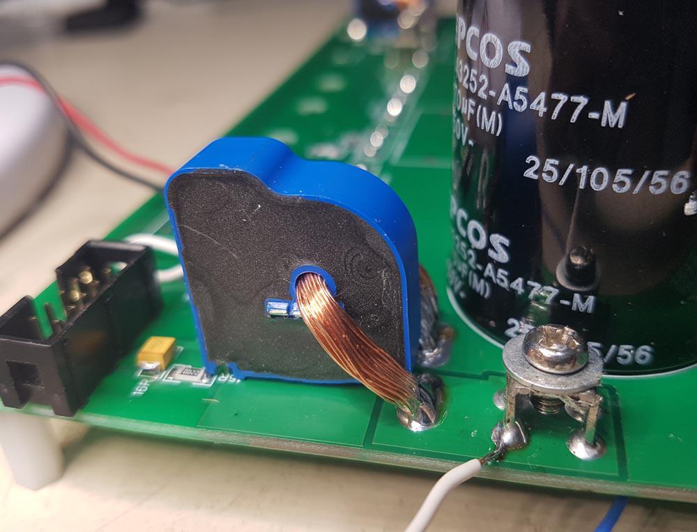

I make them fit like this:
I cut the 3 current sense wires on both sides of the part and feed 4.5mm copper conductor through the hole.
The Allergo sensors have 40mV/A sensitivity for the bipolar 50A device.
The LEM LTSR-15NP is a bipolar 48A device with ~42mV/A
The pinouts are the same (output, ground, 5V)
Accuracy and linearity are comparable and quite good enough for this application.
I see no need for M4 screws, the M3 screws do fine.
The large cap footprint is ideal. It is a standard size and will be easy and cheap to find caps. The 10,000uF 100V $6 each caps from aliexpress will fit. I would not fit 14 of these, no need at all.
1206 size SMD parts are easy to work with (for me at least).
I probably will experiment with diodes parallel to the gate resistor later.
You could add the footprint for a diode, to be used if needed..

Any chance of seeing the schematic and PCB layout - has it been posted and I missed it ? (Is it Prime time yet?)
Not many comments, suggest considering using all through hole components - not sure that smd is required - there only seems to be a few smd parts used and they appear to be in areas where real estate is not a big problem ?
Can the whole unit be powered from the Solar voltage input - when solar is gone not sure that it needs to run/display anything ?  One of the little mains to 12V at 250mA would be a good candidate on the power board. Maybe a second one for the high side TLP250 drive.
Lastly my personal preference would be to use the FDH055N15A (or 2).  On paper one of those FET's should perform better than two of the IRFB4321 with half the drive requirement and its Avalanche rating is like 4 times as much. To be fair though it is nearly double the price of a 4321.

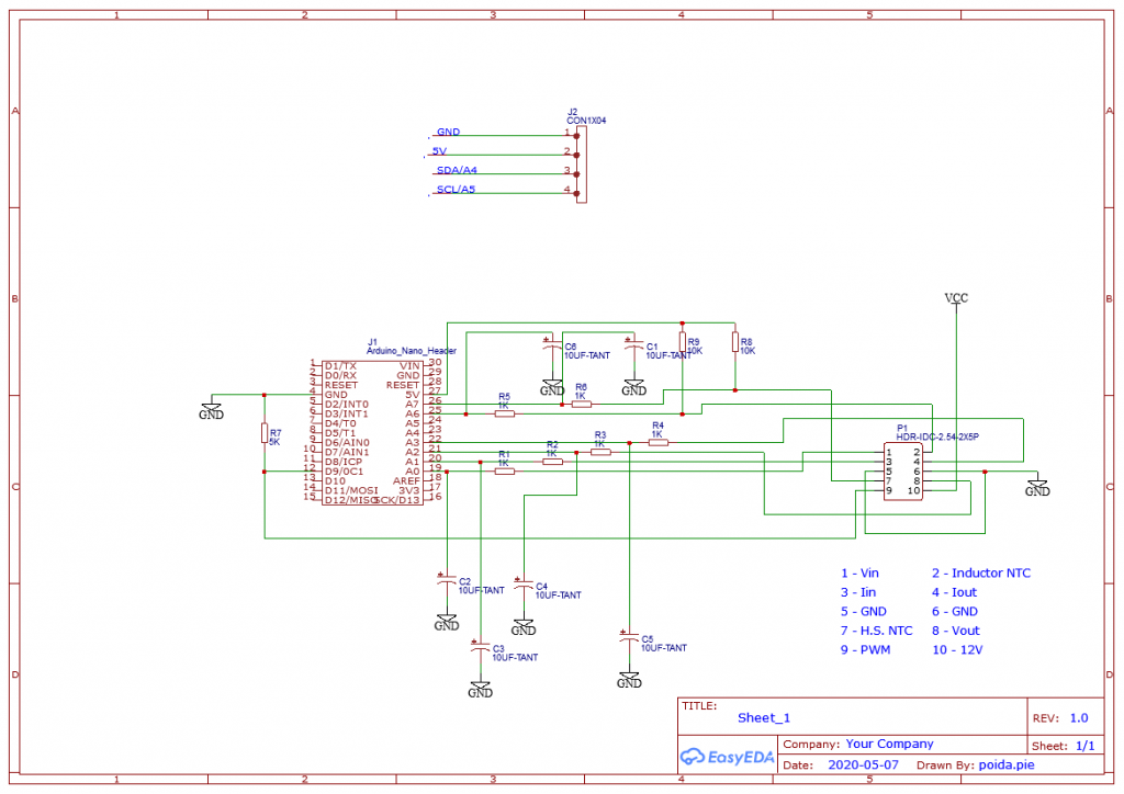

Here is the brainboard, it will use an off board 12V supply, sourced from the battery connection, using a XL7056 based buck converter (good for 80V input).
I only just roughed out this a moment ago. Errors and omissions
etc..
It presumes you will connect it to the power board.
Here is the schematic of the board I have built 3 of so far.
I now have a few changes to the above:
a 10uF 16V Tant cap alongside the 0.1uF bypass cap across the TPV-250 Vcc/GND pins
Any old caps either side of the 7805
No 4.7uF 250V caps used. (too expensive, will use them if they help in any way)
I used 10R resistors on the MOSFET gates, 12R was hard to find and why...
Also I used 1K in series with the LED driver of the TLV-250, just a standard part and available.
Edited 2020-05-07 16:31 by poida

wiseguy
Joined: 21/06/2018
Posts: 1326
Posted: 09:19am 07 May 2020
Can we (I) see the blue side too please?
From my calculations, the resistor value for the TLP-250 is too high & should be 330R for worst case spec & I would not recommend to go any higher than 470R (5V logic).  I know it is currently working but by what margin ?
Cheers Mike

poida
Joined: 02/02/2017
Posts: 1497
Posted: 10:06am 07 May 2020
Mike,
the TLP-250 specs recommend If(on) of 8mA.
5V from the Ardudino, 1K in series means 5mA which is good.
Absolute max is 20mA, so for 5V that means 5V/20mA = 250 Ohms
Threshold Iforward is 1.2mA, that is, the minimum current that turns the LED on, for 5V that means 4200 Ohms
I am using 1000 Ohms. 5mA.
The margin from the threshold (1.2mA) to what it's operating at now (5mA) seems good.
nickskethisniks
Joined: 17/10/2017
Location: Belgium
Posts: 499
Posted: 10:30am 07 May 2020
Don't forget the forward voltage drop of the diode in the tlp250, about 1,2v. And the arduino nano is not putting out the total 5V.
What you may want to consider is using a buffer ( I use a simple mosfetdriver tc427) between the nano and the tlp250. I don't know what the current limit is of the 328 uC.
Edited 2020-05-07 20:35 by nickskethisniks
nickskethisniks
Joined: 17/10/2017
Location: Belgium
Posts: 499
Posted: 10:43am 07 May 2020
  ryanm said  So you've purchased a core and wound your own inductor? Only geting cores when I search that product no.
What you see is my original pcb layout and schematics, please take the layout as "concept" not all values are right.
Yes I wound my own inductor, because that gave better results.
wiseguy
Joined: 21/06/2018
Posts: 1326
Posted: 10:44am 07 May 2020
TLP152 Recommended operating conditions from data sheet -> Led current 10mA minimum 15mA maximum.
LED forward voltage drop Max 1.8V
Voltage to work from -> 5V - 1.8V = 3.2V
Minimum current -> 3.2V / .01A (10mA) = 320 Ohm
Note this is maximum resistance for minimum current.
at 15mA Maximum current -> 3.2V / .015A (15mA) = 220 Ohm
Edited 2020-05-07 21:11 by wiseguy
