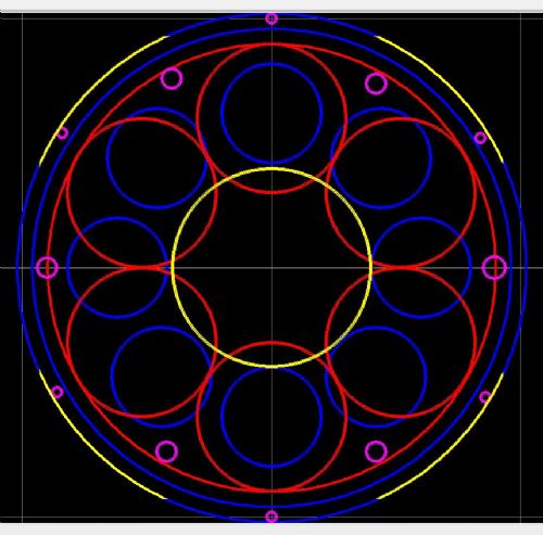

GWatPE
Joined: 01/09/2006
Posts: 2127
Posted: 01:10pm 31 Jan 2009
This is the tentative layout for the new AxFx unit. The magnets are 2 inch dia, the coils work out to be 3.6 inch dia. The rotor is 10 inch dia plate, and the magnets will be placed at a radius of 3.75 inches. The stator will end up approx 11 inch dia and will fit inside the rotor can.
The final dimensions will be close to set when I make a second test coil with 1.8mm wire. This will probably reduce the resistance by 40%. The low resistance will probably give bone jarring stopping of the rotor.
The first set of wooden blades are being tested on a chinese windmill. Preliminary testing indicates a significant improvement over the factory originals.
Gordon.
become more energy aware

GWatPE
Joined: 01/09/2006
Posts: 2127
Posted: 03:03am 01 Feb 2009
Hi Oztules,
I may have enough room to increase the wire size further, just kidding.
here is a clearer pic of the expected layout. I had to juggle the extracting bolt position to avoid magnets and coils. The magnets are the 8 blue smaller circles. The 6 red medium circles are the coils. The yellow circles represent one rotor ring. The opposite rotor is a fullsize disk, on the other end of the can, that is the blue large dia ring.
computer generated images will have to suffice for the moment.
Gordon.

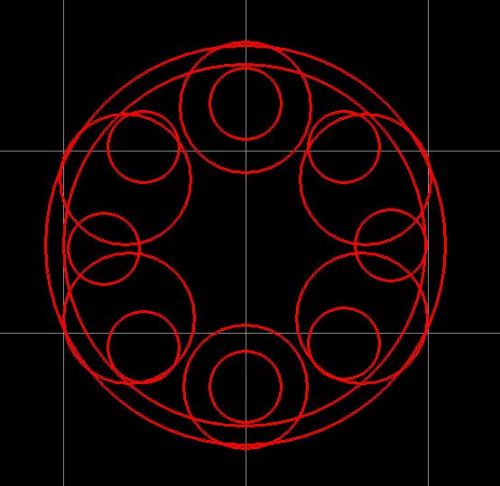

GWatPE
Joined: 01/09/2006
Posts: 2127
Posted: 12:12pm 05 Feb 2009
Hi tinker,
I have never been a fan of the open style of AxFx windmills that have appeared on many windmill sites on the internet. I have decided that I would make my new AxFx alternator in a similar way to the prototype machine I built in 1993/4. This has the magnet rings connected on the outside. The stator is fully enclosed, but is open to cooling through a significant space on the rear side between the rotor and the axle. Only one magnet ring is directly attached to the bearing housing. The wiring tails will be flexible wire and fully moulded into the stator. The tails will exit the alternator in the gap between the rotor and the axle. The alternator will be no biggger than the can that enclosed my F&P unit, and will attach to the yaw box on the first page of this thread. I am expecting the rotor will have a higher mass than the plastic F&P. The new wooden blades will more than compensate.
Here is a drawing of the new expected layout.
new layout
This is tentative until some coil testing is done. I was able to increase the coils from 6 to 8 and the magnets from 8 per rotor to 12. Unfortunately the arrangements allow only 2phase with 8 coils. I only have 3 slip rings on the tower and I want to keep the AC output. I will need to see if I can reduce the turns and add another coil in the layout, so I get back to 3phases.
Gordon.
