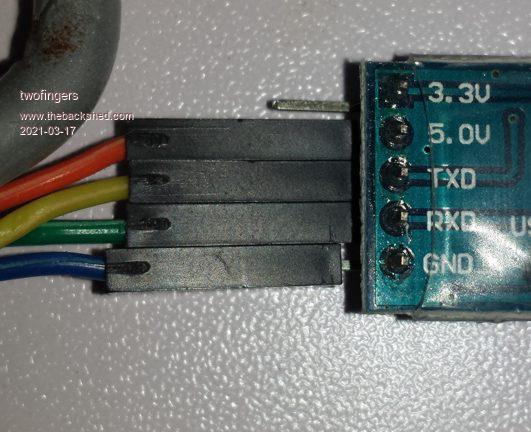

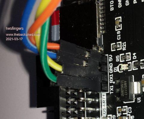

Something strange about the firmware download/programming (Board V33):
I had to use the serial (TX-RX, RX-TX) port as the USB seems to stop working in bootloader mode. When I used the normal jumper settings, I was unable to connect to the CubeProgrammer.
Then I tried without the BT1 jumper and ... was successful.

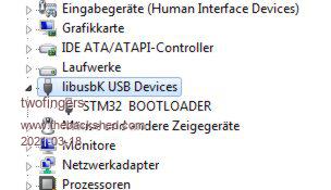

It seems that Zadig (https://zadig.akeo.ie/) solved my connection issue with Win7, the STM32F407VET6 (V33) and the CubeProgrammer. I found it after reading this thread: https://community.st.com/s/question/0D50X00009XkXagSAF/dfu-usage-with-stm32cbeprogrammer
BT0 jumper only! That's weird because it worked twice with BT0 + BT1 plugged in.

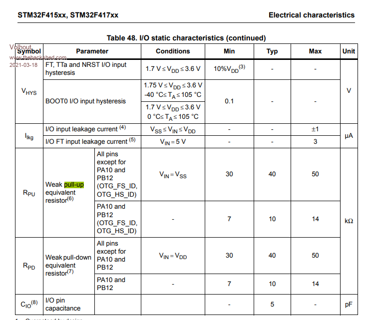

I should have expanded my reply. What I was trying to get at, for the V33 board with no external pullups, no internal pullups would mean no cards would work, while weak internal pullups might allow some to work. I guess some SD cards must have their own.
Does this chip have more than one size pullup option. I would have thought the usual 100k would be too high for reliable communication at the high data rates of SD.
Posts: 6112
Posted: 12:18pm 18 Mar 2021
Hi Phil99,
The weak pullup inside the STM32F407 is 40kohm.
The suggested external resistive pullup is 47k ohm as I recall.
Therefore the internal pullup is even stronger than the suggested external resistor.
Posts: 11868
Posted: 12:23pm 18 Mar 2021
I didn't originally enable the internal pullups as the board is supposed to have external. These are really too strong (10k) so with the internal enabled as well we are now on 8K. Assuming it works for boards with the pullups I'll leave the internal in place.
