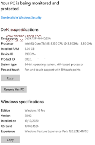

I wonder what dll  are needed to runing mmb4w?
I testet up to 30 win pc in the last time without problems but
Frank N Furter shows a Problem. So iam curious , can you sort it out ?
Plasma
Posts: 12059
Posted: 03:39pm 07 Mar 2022
winmm..dll
user32.dll
gdi32.dll
opengl32.dll
The problem one based on his report is winmm.dll. All the others were needed to run versions he said worked

Can anyone send me these DLL's?
THANKS!!!
Frank

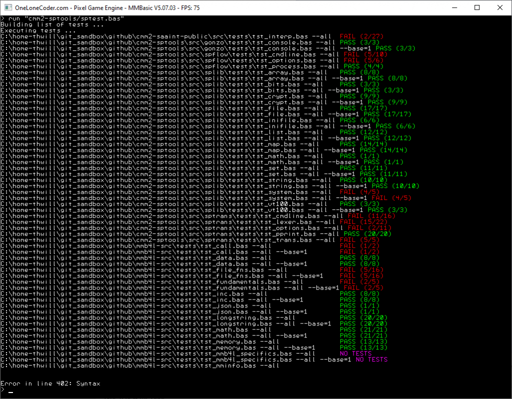

Starting to look pretty good with b4:
Notes:
1. I'm currently focusing on getting them all to run without crapping out ... which is what tst_mminfo is currently doing due to no OPTION SEARCH PATH being implemented.
2. Some of the FAILures are almost certainly false positives.
3. This is NOT a comprehensive set of unit-tests.

> list "timer-bug.bas"
Option Base 0
Option Default None
Option Explicit On
Option Console Both
Dim old_timer% = Timer
Dim i%
For i% = 0 To 200 Step 10
 Timer = i%
 Print Timer, i%
Next
> run "timer-bug.bas"
0.0005  0

Posts: 12059
Posted: 11:29am 08 Mar 2022
  Quote  You appear to have implemented OPTION CONSOLE BOTH|CONSOLE|SERIAL without telling us exactly what it is implemented to do - or did I miss that post.
I did what you suggested
  Quote  Here's a bug for you, fairly sure we saw it on either the CMM2 or PicoMite previously:
What is the bug? The timings will depend on other activity. The bug on CMM2 was that it wasn't monotonically increasing
On line 9 the TIMER is set, on line 10 the TIMER is printed.
It appears the TIMER has not actually been set as there is no relationship between the two numbers .

  Quote  It appears the TIMER has not actually been set as there is no relationship between the two numbers
Sorry missed the point of the test
Here is the bug
int64_t offset= getinteger(++cmdline) / 1000 * frequency;
and here is the fix
int64_t offset= getinteger(++cmdline) * frequency / 1000;

@Frank n.Furter
dll.zip
my win 10 64 bit dll files / from system32 folder
gtx
Edited 2022-03-09 01:32 by Plasmamac

  Plasmamac said  @Frank n.Furter
dll.zip
gtx
MMBasic for Widdows is a 32-bit application.

Posted: 04:24pm 08 Mar 2022
@Plasmamac:
Thank you very much - I copied your files to my MMBasic folder - unfortunately no change...
Frank
Posts: 12059
Posted: 04:26pm 08 Mar 2022
  Quote  I copied your files to my MMBasic folder
You need to copy them to Windows/system32
What CPU do you have?
Edited 2022-03-09 02:31 by matherp

Posted: 05:24pm 08 Mar 2022
The 32-bit libraries(in Windows 64bit) are located in Windows\SysWOW64.

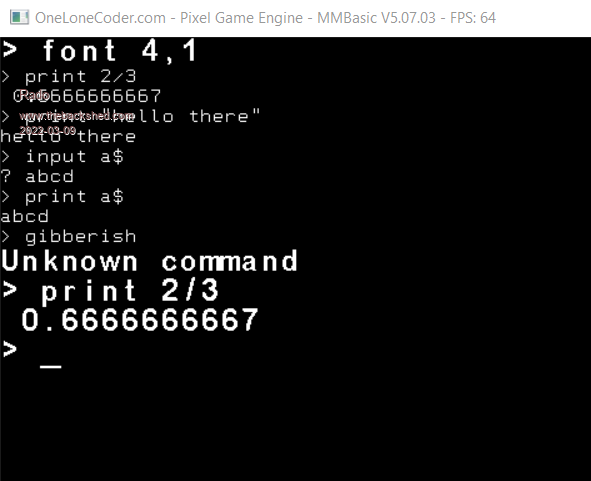

Just got some time to play with this (03.b5), and it seems that there's something with fonts: in command line, as soon as I enter something invalid the font reverses to default:
