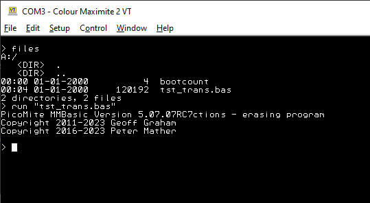

In order to execute user functions/commands at the command line the sub/fun table has to be created. This means if it is full there is nowhere for the firmware to go. As I say, please post the offending file and I'll see what sort of work-around I can create

V5.07.07RC7
Fixes various issues raised by Tom above
Tom: load this and it will delete the offending program but not delete your flash disk

Posts: 4398
Posted: 05:27pm 25 Apr 2023
Hi Peter,
Now running RC7, it prints the message about there being too many sub/funs, but then it restarts, backing up one line before printing the (c) message and half erasing the error message from the user:
Edited 2023-04-26 03:28 by thwill
