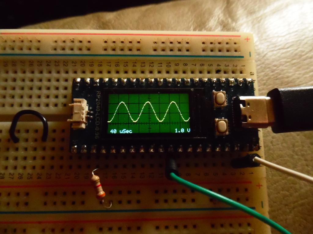

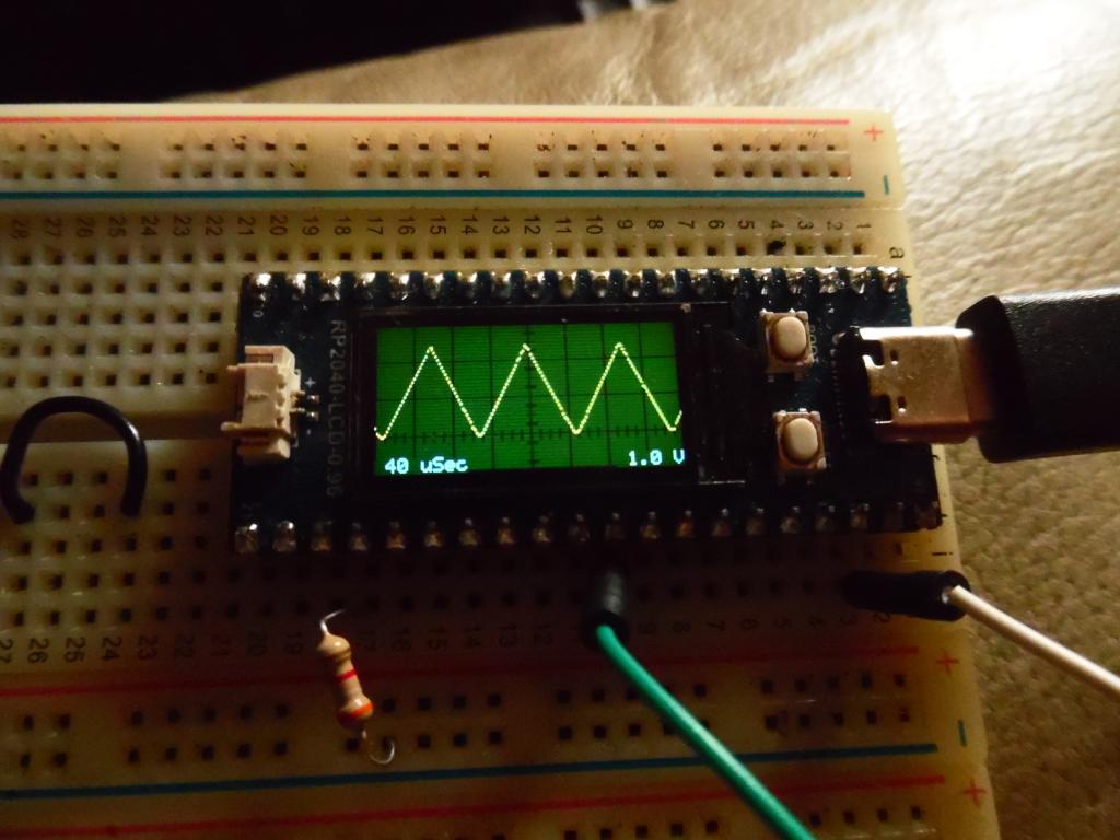

NPH, Hi! I tried your scope v1 and v2 in page 4 in this thread and it's very nice.
removed the random pwm mark space. Looks nice display. How come I never got that using pixels??
10000Hz sine with dc offset
The cursor is not mid screen??

Ooh - that looks good! I don't have a signal generator, and could only use the PWM test signal.
I set the cursor at 3/4 the way to the bottom to show DC signals (the cursor is at 0VDC). I have a 3PDT switch on the way; I will use two poles to switch the R/C network in and out to center the signal, and the 3rd pole to indicate to the program whether this is an AC or a DC signal, and move the cursor appropriately.
I see the resistor in your photo - is that to do current limiting between the test signal output on pin 24 and the signal input on 31?
You're also using an older version of my code - I don't see the Trigger symbol ("/", "\", "-") in the middle.  My newest version is on my GitHub page, linked here.

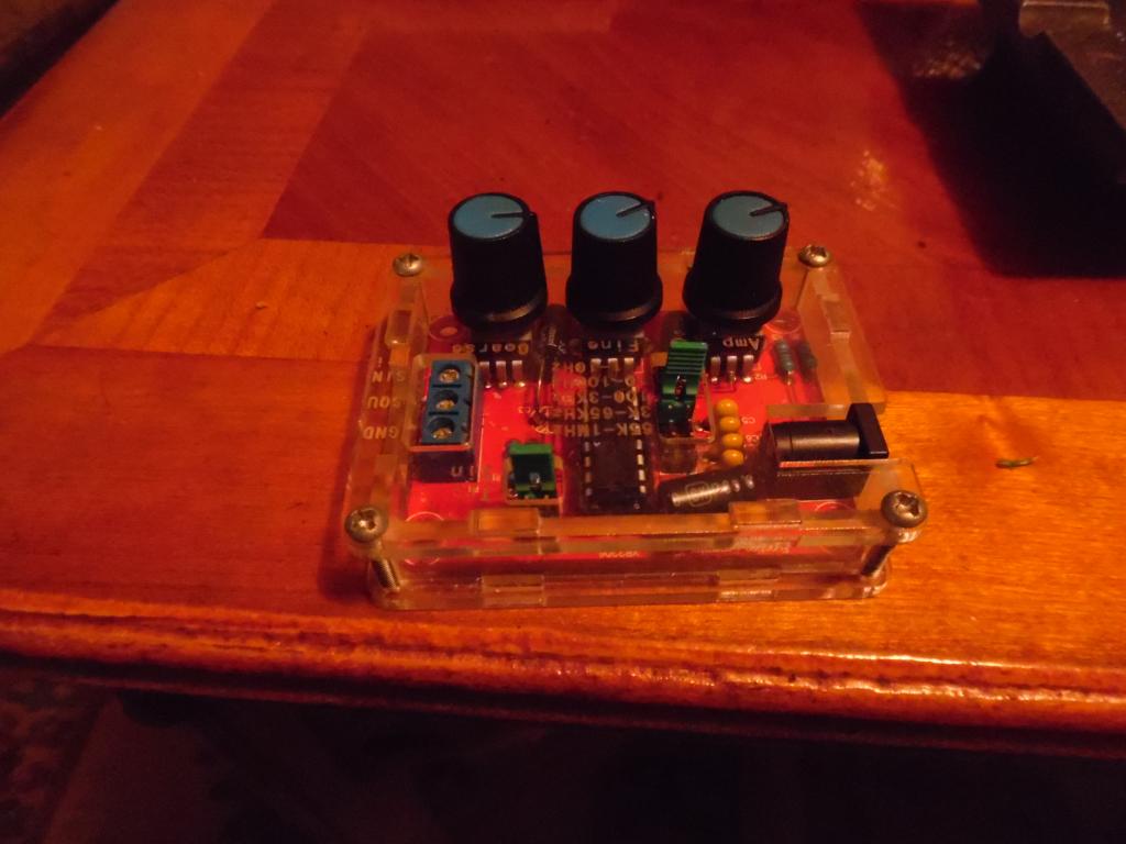

Posted: 10:47pm 19 Aug 2023
my Pic based sig gen and a sig gen chip spoiled by being cheap.. but cheap and works.

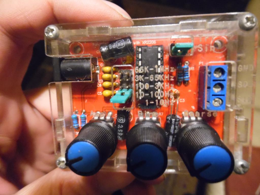

Posts: 2807
Posted: 12:27am 20 Aug 2023
these are a common chip but done cheap but work as a sig gen
