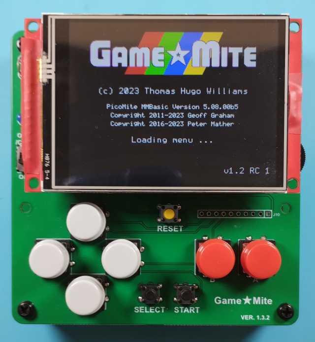

Hey folks,
This is the best I can muster in the way of a Christmas present:
   https://github.com/thwill1000/mmbasic-gamemite/releases/download/v1.2-RC-1/GameMite-1.2-RC-1-full.uf2.zip
Version 1.2 RC 1 - 21-Dec-2023:
- Updated to use standard PicoMite firmware (5.08.00b5).
  Required options are:
    OPTION SYSTEM SPI GP6,GP3,GP4
    OPTION AUTORUN 1,NORESET
    OPTION CPUSPEED 252000
    OPTION LCDPANEL ILI9341,RLANDSCAPE,GP2,GP1,GP0
    OPTION TOUCH GP5,GP7
    OPTION SDCARD GP22
    OPTION AUDIO GP20,GP21
    OPTION MODBUFF ENABLE 192
    OPTION PLATFORM "Game*Mite"
- Changed menu program to support multiple pages and be configurable
  via the "A:/.gm-menu" file:
  - This file will be created on startup if not present.
  - CSV file with entries of the form:
      <menu-text>,<file-path>
    e.g.
      PETSCII Robots, B:/mmbasic-robots/robots.bas
  - If the <file-path> is not absolute then the program will look first
    in "A:/GameMite" and if not found there, in "B:/GameMite".
- Changed startup screen to include image/logo
  - and made easier to configure via ".startup" file.
- Added @Volhout's "Circle One" game (v1.1.0) to the program suite.
- Updated program suite to use latest version of 'splib':
    System software => v1.2 RC 1
    PicoVaders => v1.1.2
    Yellow River Kingdom => v1.1.1
    3D Maze => v1.1.1
- Reduced size of program suite through better pre-processing.
Thank you to @Volhout for "Circle One" and @vegipete for the splash-screen font/logo.

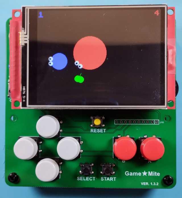

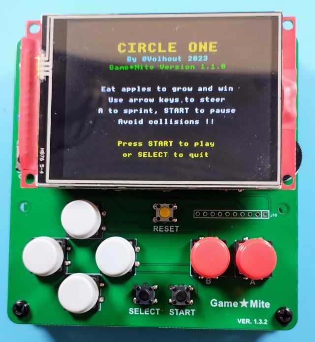

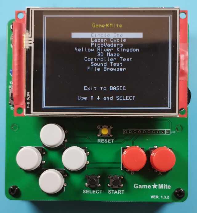

Alas it appears I get worse, not better at taking photos:
Merry Christmas & Happy New Year,
Edited 2023-12-23 00:01 by thwill

Posted: 07:02pm 22 Dec 2023
Hi Tom,
The circle game works nice. You can even run diagonal now (=new).
Thanks for implementing.
You (and Kevin/Martin) did a great job. I just copied petscii robots on the SD card, and could play it when started from the browser. This is the first time I see it being played on an LCD. I will look at adding it to the Game*Mite menu. Thank you (all) !!!

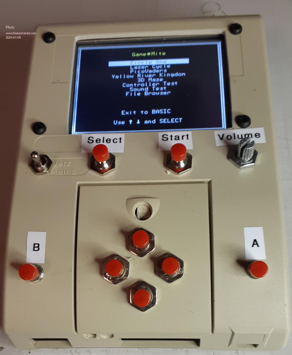

Posted: 06:44pm 07 Jan 2024
Loved by grandchildren (and older generations):
Pluto
Posts: 5995
Posted: 06:45pm 07 Jan 2024
Works well,
Thanks for the update.
Posts: 4378
Posted: 06:51pm 07 Jan 2024
  Pluto said  Loved by grandchildren (and older generations):
Neat.
I'm guessing that must be a clone and not @bigmik's PCB ?
What's the enclosure, not a 3D print by the looks of it ?
I'd love to see inside.

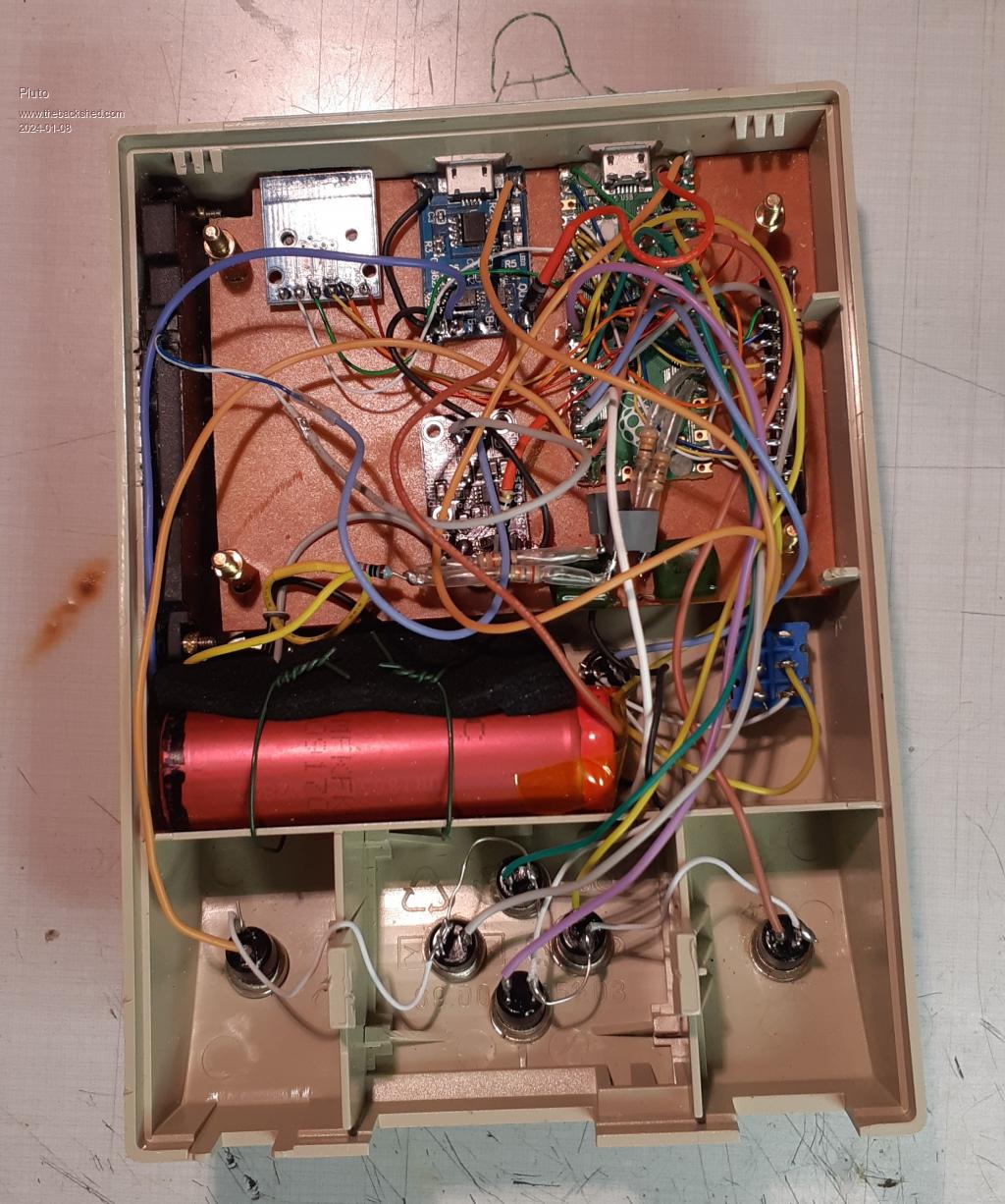

Pluto
Joined: 09/06/2017
Location: Finland
Posts: 411
Posted: 07:46pm 07 Jan 2024
Tom,
it is not only a clone; it is more like a clown.
Enclosure from some old recycled (BOSCH) equipment. Can't remember what it contained.
LCD attached to a scrap PCB used as support for the various modules (SD, Charger, Pico and PAM8302 audio. Black thin box on left side is a recycled laptop speaker. Battery recycled from an old laptop.
Inside looks very much like a transistor radio from the sixties:
Believe it or not; It works!
The longer cables are soft silicone wires which enables the PCB to be removed from the box without need to desolder anything. Servicefriendly!
The only problem I had was with the (cheap) switches. Was corrected by with CRC Contact Protect.
PAM8302 sound is (fortunately) not too loud!
Pluto
Posts: 4378
Posted: 08:21pm 07 Jan 2024
Even messier than the prototypes .
It's awesome, I love it.
