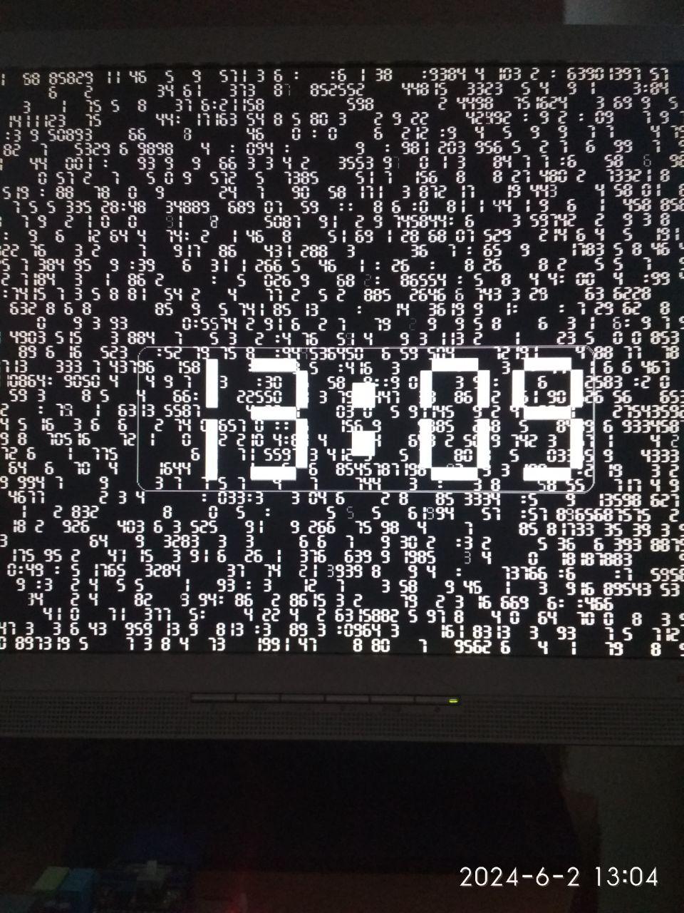

javavi
Joined: 01/10/2023
Location: Ukraine
Posts: 603
Posted: 08:13am 02 Jun 2024
  Mixtel90 said  You can have a sub that runs every second using SETTICK. It's usually accurate enough for most purposes, but not for timing.
Thank you very much Mixtel90  !
Thank you very much Martin H. !
Now the clock is running, I am updating the readings by SETTICK.
7SClock.zip
Edited 2024-06-02 18:22 by javavi

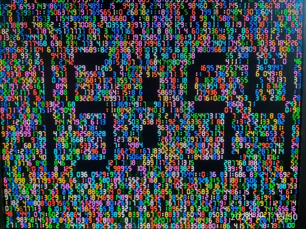

javavi
Joined: 01/10/2023
Location: Ukraine
Posts: 603
Posted: 10:18am 02 Jun 2024
7Sclock2.zip

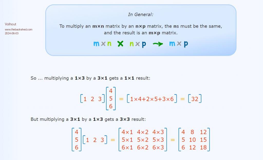

Posted: 07:06am 03 Jun 2024
Peter (Geoff),
I have a generic question about matrix multiplication.
In my Thermal imager project I am trying to speed processing up by doing matrix multiplications to achieve higher video resolutions.
But there is something strange in the MATH M_MULT command.
This is the knowledge I have:

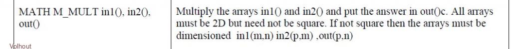

When I try the values for n,m,p (see above) that are according to the text book, I get an error message (array dimensions).
But when I look in the PicoMite user manual I see this:
This implies that matrices in(1) and in(2) are in reverse order in the multiplication ? Please explain how this works ??? Are rows and columns swapped in the MMbasic implementation ? What cells are multiplied by what cells to achieve the geometry specified ?

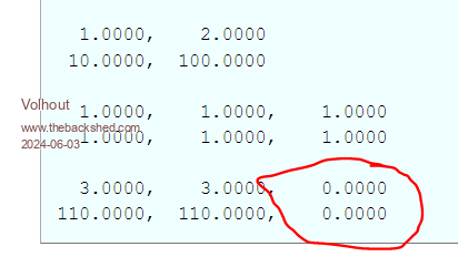

Posts: 11830
Posted: 07:13am 03 Jun 2024
MMBasic will not allow arrays with a dimension of only 1 element so you cannot initialise an array to achieve your first example. This could be programmed round in the multiplication algorithm to special case the single element but that is a big project - If anyone wants to do it I would gladly incorporate it.
Posts: 6101
Posted: 07:19am 03 Jun 2024
Hi Peter,
With(default) option base 0, the arrays have minimum 2 elements per dimension in the example code (not in the text book copy).
Please try this:
Dim a(1,1)=(1,2,10,100)
Dim b(2,1)=(1,1,1,1,1,1)
Dim c(2,1)
Math m_print a():Print
Math m_print b():Print
Math m_print c():Print
Math m_mult a(),b(),c()
> RUN
  1.0000,    2.0000
 10.0000,  100.0000
  1.0000,    1.0000,    1.0000
  0.0000,    0.0000,    0.0000
  1.0000,    2.0000
 10.0000,  100.0000
  3.0000,    3.0000,    0.0000
110.0000,  110.0000,    0.0000
Regardless how I fill array b(), there are never any values in c(2,xx).
It feels a bit like the code has a good implementation of the text book, just array dimension checking works reverse.
Edited 2024-06-03 17:22 by Volhout
