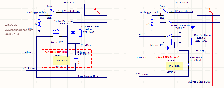

  wiseguy said  I am not advocating to use the second circuit it just shows an ideal solution.
The second circuit could use either a spare contact set that some of the contactors use or alternatively a second small 48V relay driven in parallel with the contactor, untested but I believe it provides the required isolation from the bulk capacitors and the Nano controller.
Will the forward voltage drop on the diode in the circuit for pre-charging the capacitors mean they won't quite get to VBat and need an adjustment in the setup to account for it?
Good question, in Poidas code we put a known voltage simultaneously on the Vcap and Vbat inputs and calibrate them both simultaneously to the known Vbat voltage. That way resistor tolerances are taken into account and calibrated for. There would be an offset error that the diode causes to the Vcap that becomes more prominent the closer we get to zero volts.  I'm going to ask KeepIS what the prognosis is for the added diode, and when calibrating should it be with the diode included for better accuracy at the region of interest, or does version two need more work.... or more lipstick...
Circuits in question:
Edited 2025-07-18 11:46 by wiseguy

  Quote  in Poidas code we put a known voltage simultaneously on the Vcap and Vbat inputs and calibrate them both simultaneously to the known Vbat voltage. That way resistor tolerances are taken into account and calibrated for. There would be an offset error that the diode causes to the Vcap that becomes more prominent the closer we get to zero volts.  I'm going to ask KeepIS what the prognosis is for the added diode, and when calibrating should it be with the diode included for better accuracy at the region of interest, or does version two need more work.... or more lipstick...
The diode should not cause any issue and if used should be installed when calibrating, VBat to VCap delta is only relevant when the Inverter is above low voltage cutout and SPWM / Solenoid are enabled. My code also has a more stringent delta test immediately after Solenoid enable (and a different code), IMHO in either case, the  calibration of VCap with a Diode in series should only have an influence at very low voltages when the Solenoid is switched off, as wiseguy indicated, that difference should be meaningless to the code at low V.
EDIT: Just to be clear, there are separate calibration settings for Vbat and VCap in my Code, and allowable Delta is adjustable up to 3V if needed.

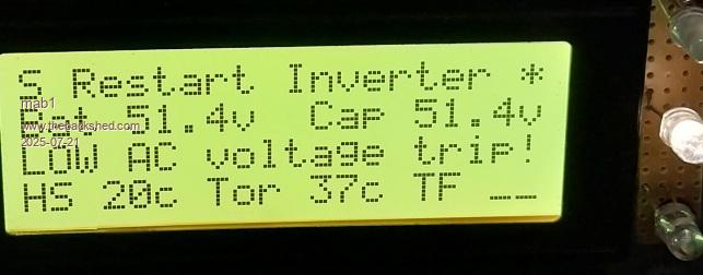

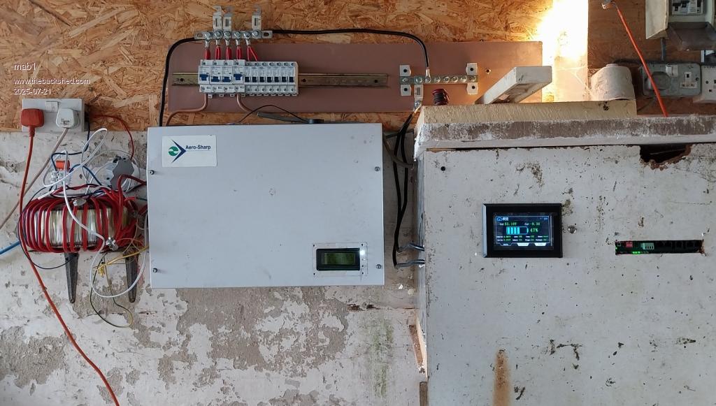

Probably not your stuff up but mine Wiseguy    I downloaded copies of the schematics early on so I wouldn't have to go looking for them when I needed them. But I didn't check to see if it was the latest version when I came to use it
Finally got it connected to the battery today:
Not yet tidied up on the ac side but ok to start testing. Tried a couple of small loads then connected the mahoosive chest freezer as a longer term test, and to see how it was with a big start surge - fine,  although it did manage to trip once in about 5hrs on overcurrent.
I don't have any solar connected to the 48v battery yet, so once i was sure it was happy with the freezer I switched a couple of gti solar arrays onto it as they're on plugs and easy to transfer over. I can't recall if anyone else was planning to backfeed with gtis, and it wasn't very sunny so it was only 500w, but the inverter didn't bat an eye when backfeeding
Gradually left it for longer periods but kept popping back to check as I don't want the freezer to defrost,  but then after about 5hrs from Startup, I came back to this:
Note the torroid temp was high. I couldn't really figure out what had happened so I reset the inverter- it started fine and started the freezer fine, but the transformer seemed a bit noisy, and after a couple of minutes it was getting louder and rougher sounding, and seemed to be pulling a couple more d.c. amps than it ought, so I unplugged the freezer. The transformer got quieter, but was still loud, and was getting louder even with no load, and putting my hand on it, the primary was getting hot   so I turned the inverter off.
Thinking about it, I'm guessing I'm losing drive to one corner of the h-bridge (again   - i had that on the test bench, but i fixed that solder joint for sure)? But I'm not sure yet and need to do some testing   . I'm guessing I must have a dodgy solder joint somewhere.

I'm glad the smoke has not been let out so far.  Highly recommend that you get a scope on the output to see the waveform shape.  Did you use quality machined IC sockets? - I tried some cheapies from AliExpress and it caused many hours of chasing intermittent faults.
Some of the machined pin sockets had zero tension with a pin inserted - gravity would make it disconnect when testing each pin of each socket. The ones that had some tension were only about 1/4 to 1/2 of a good quality socket.
What value choke/s are you using in total? I found for a 48V inverter ~ 47uH was about the right starting number. I calculated for my 2KW 12V inverter as ~ 5uH but made the mistake of starting with that value unloaded. It turned out ~12uH was the right value - are you seeing a pattern here? A few have asked for a "rule of thumb" guide to the choke value.
I suggest that a good starting point seems to be ~1uH for each volt and expect only ~ 30 - 50% of that starting value remaining under load & depending on the core material. I will do more work on this eventually.

Might be best to go back to a current limited supply with a small value of Cap bank just in case, you should notice any extra current fairly quickly with that, and an intermittent board fault shouldn't blow the FETs.
Interestingly heatsink temps look fine. I noticed it has turned on the Toroid fan enable, 37°C is not really that hot though but it may have been a lot hotter before the trip?

yes I was impressed that it didn't let the magic smoke out, but I'll still use a  bench psu and small caps when I try and trace the fault - no use tempting fate.
I remembered your warning about cheap Chinese sockets so I avoided ali - but I think I may have gotten them from lcsc who are, technically, Chinese now
There are two chokes, about 25uH each, 5 turns on 5 blue sendust(probably) rings, and according to my attempt to measure their saturation, should be OK up to the high side of 400A. And 5.4uF (1 + 2 x 2.2) capacitance on the transformer output, plus 10nF to 0v from each side of the primary as per your schematic.
Keepis, yes  I was surprised there was no heat discernable in the heatsink/caps if there was enough current to heat the 16mm2 primary in a couple of mins   , particularly as the battery current was <10A. I guess it was in core saturation spikes from the cap bank?
I don't actually have any fans set up yet so i haven't looked at the settings: in theory I'm not pushing it past the 3kw transformer rating yet, so it should cool passively. The chest freezer can pull 400w when it's working hard, but more usually 250 - 300w.

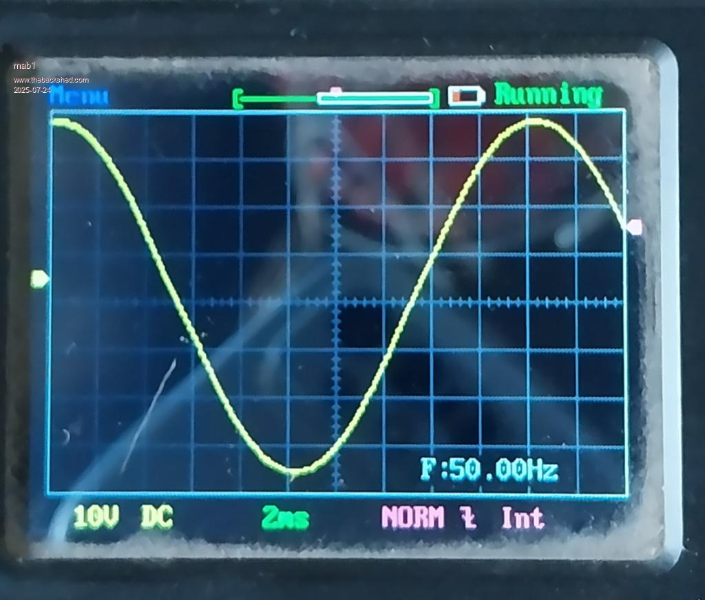

Ok, haven't been able to look at the inverter til today due to work
But got home earlier today and not too tired so I fired it up on a 2A bench psu and 2000uF capacitance, and looking at the waveforms on the little pocket'scope:- running fine with no issues, even when prodding/poking/wiggling things in their sockets.
Sinewave (via the weller iron 24v transformer) looks ok to me.

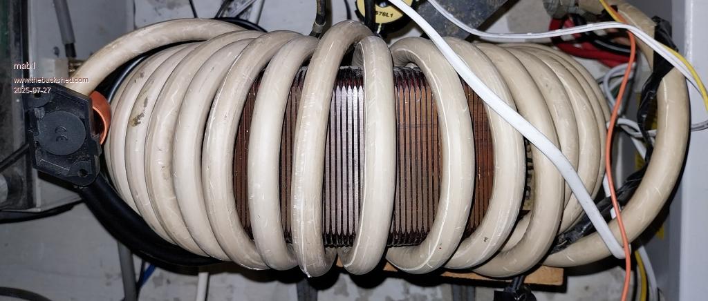

So for testing to higher loads I've cobbled up another temporary transformer:
This is the variac core with 37 turns of 50mm2 . Using the 230v winding as it is so runs about 16W at 230v Due to the smaller core cross section it needs more turns/volt, but there's room for 70mm2 in that huge centre hole (50 is what I've got). Although my inductors are still wound with 16mm2 for now
I ought to get on with winding the double stack really, but I feel it may be worth playing a bit with transformers first.

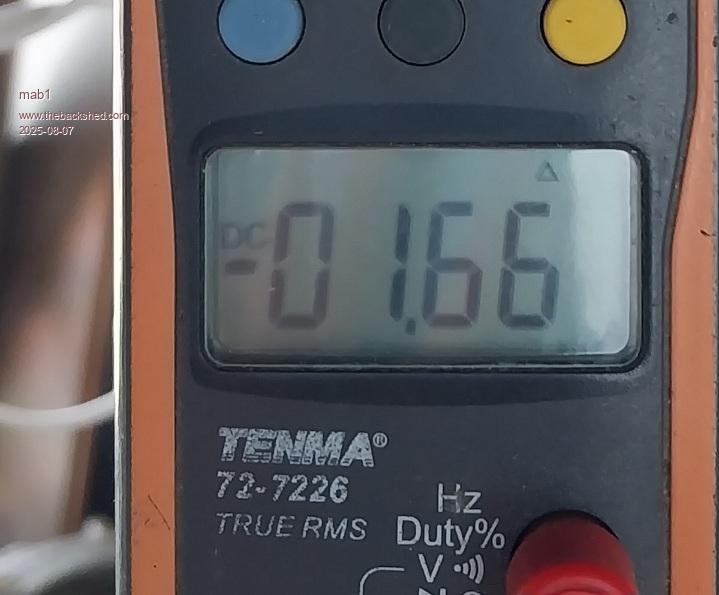

having resoldered the optos, it was running much nicer, but there still seemed to be noticeable transformer noise when running under load, but oddly, got quieter when backfed from the gti's, even at higher power. It made me wonder if I still had asymmetric drive - the gti's are sunny boy transformer types so they would obviously push back with a symmetrical output.
Had the idea of measuring the primary current using the clamp meter set to d.c. and sure enough, it was consistently showing 1 amp or more in one direction even with no load connected.
With 2kw load it would nudge up towards 3A.
When backfeeding it was too noisy to be sure, but given that other people's builds have quiet transformers, it was time to go back to the test bench.
Thinking it could be another dodgy solder joint , I tried to think of a way to test the whole gate drive, optos,  and totem pole drivers: decided to use a signal generator to drive a 10khz 5v-0v square wave into each opto in turn and look at the mosfet gate signal in each case:
Actually turned out easier to spot than that: for 3 of the optos, applying the 10khz signal caused the 12v supply currect to increase from 55mA to around 78mA for the high side drives, and about 86mA for one of the low side drives, and I could actually hear the 10khz drive faintly. For the 4th opto (one that had had a bad solder joint) there was no increase from 55mA and no noise!
Soldered a new opto in and bingo! All four drives work and produce a square wave on the gate resistors   (although, there was still a slight difference in the current draw for the two lowside drives: about 86mA for one and 94mA for the newly installed one - I'm still thinking about that   ).
