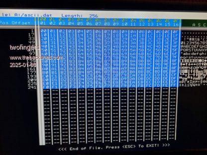

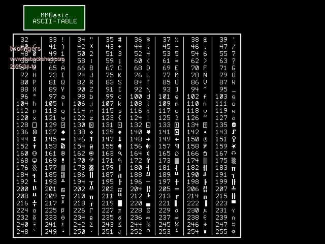

Hi Vadim, all,
I have modified FM 1.14 with some extensions that I think are useful.
These include Harm's FREEPINS,
and my "ListHex" - for displaying binary files. Called with Shift+F3 -, a color table and an ASCII table (F9).
This is a suggestion and if Vadim also finds them useful then I would be happy if they are included in the later versions.
fm115.zip

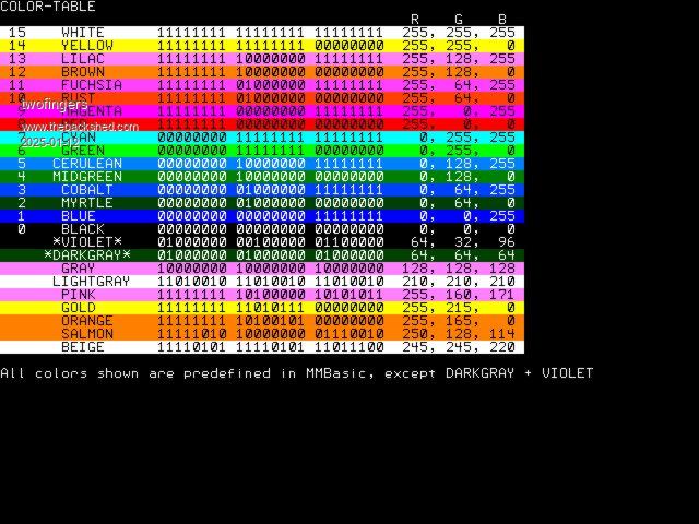

I've worked a bit on the color table:
fm115.3.zip
Note: The colors don't exactly match the screen display of the Pico.

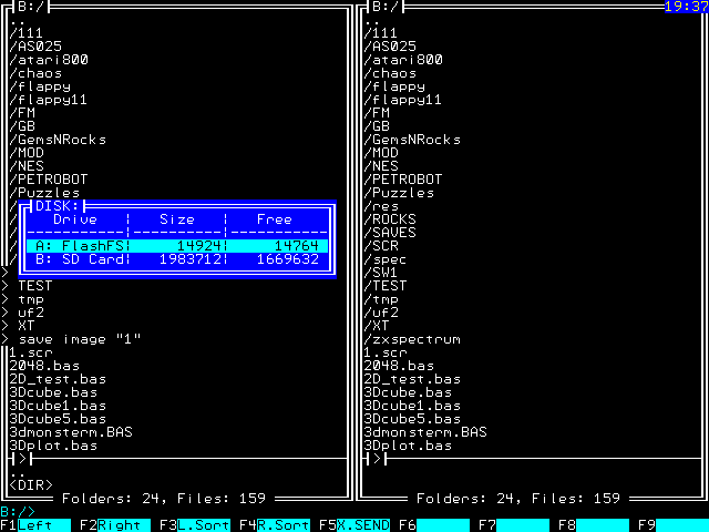

FM v1.20 for PicoMiteVGA/HDMI MMBasic V6.00.01
FM_v120.zip
- Bug Fix & Optimization
- Display paths for left and right panels
- File overwrite warning
- Viewing image files .bmp .jpg (.png)
- Listening to background music .MOD .WAV (.MP3)
- Redesign F9 Commands Menu
> Commands and options executed at the command prompt
* Commands and options executed at the command prompt
(The user will be able to create their own subroutines and add them to the menu)
P.S. I haven't added the suggested functions to the code yet, which still need to be tested. You can still do it yourself.
For now, it's like this... I still have an anxious situation.
If you have any suggestions for the functionality of the File Manager, write here.

I have renamed the manager to "FM120.bas" and added these two lines::
Data "> 'For start FM from B:"
Data "> OPTION F9\q*\q+Chr$(34)+\qB:FM120\q+Chr$(34)+Chr$(13)"
Can you tell me how I can switch to drive B: in the left-hand window? I have not been able to do this yet...

Hi Frank,
Press ALT F1, and select B

UPDATE:
ALT+F1  does not work for me. It makes no difference to me whether I hold down the ALT key while pressing the function keys or not. (I have tried two keyboards...)
