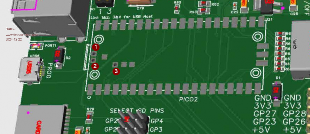

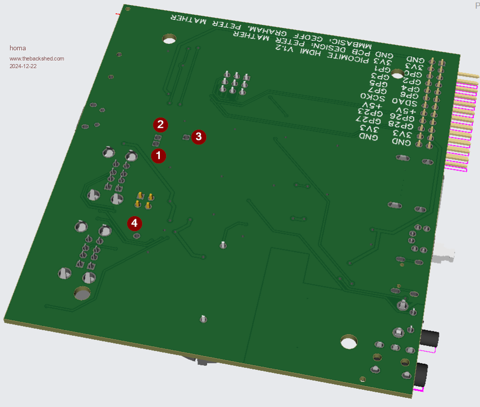

@Peter
Important soldering question!
  matherp said
Notes on use.
Solder the PICO2 direct to the motherboard ensuring it is completely tight to the PCB
On the rear side of the board there are 4 holes without solder mask. Apply liquid flux to these and solder through them. These connect the USB programming micro-USB, Pin GP23, and improve cooling for the USB HUB chip.
Are there really 4 holes or are there only 3 due to the redesign? My board arrived today and I can only see three!
I don't want to make a mistake.
Matthias
Posts: 11826
Posted: 05:13pm 21 Dec 2024
The other hole is under the USB hub - not important - just might help cooling
homa
Joined: 05/11/2021
Posts: 685
Posted: 05:30pm 21 Dec 2024
ok, found it.
For others who have the same question, here again in dye and colour :-)

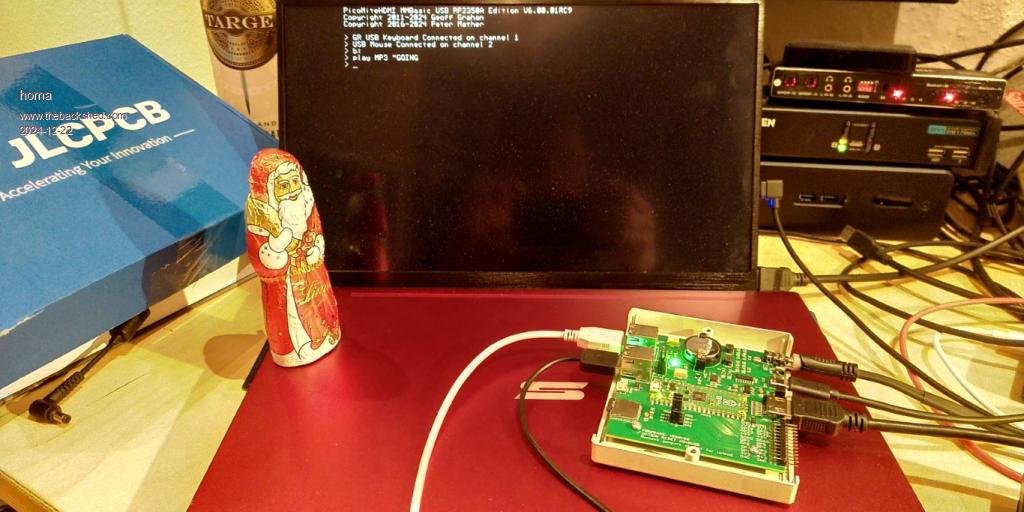

Joined: 05/11/2021
Posts: 685
Posted: 10:31pm 21 Dec 2024
My first board is finished :-)
The apertures are still missing, but I'll make them on Monday with the small CNC.
Thanks to Peter!
Now I'm enjoying my whisky ... and looking forward to it.

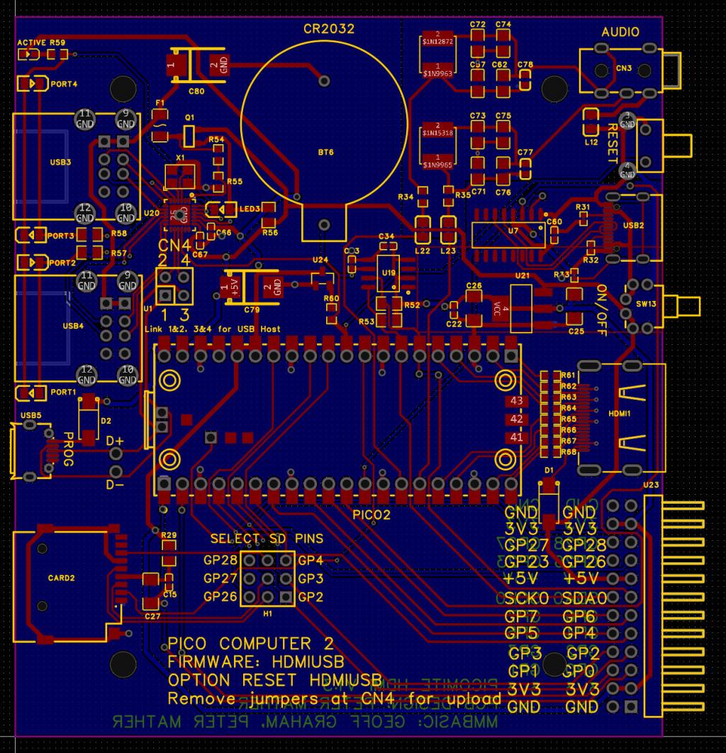

Posts: 11826
Posted: 10:58am 01 Jan 2025
Here you go. Same BOM and CPL as before
PicoComputer2V1.3.zip
