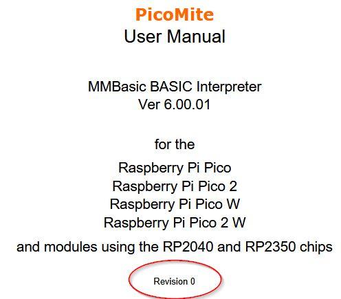

  JanVolk said  Geoff,
I noticed that Appendix J – Advanced Graphics NOT AVAILABLE ON HDMI OR VGA VERSIONS in Revision 1 is gone.
This is an important chapter and if it is no longer in the manual it will be forgotten.

We seem to have talked past each other here.
In your link I find Ver 6.00.01 Revision 0.
Isn't Appendix J - Advanced Graphics included there?
Jan noted that this is missing in revision 1.
Hence my request for it.
There have already been a lot of improvements and I have lost track of everything that has been improved. So I was hoping for a revised version.
Hence my request for revision 1, but apparently .01 from Ver 6.00.01 was meant here! In which case I don't understand Jan's comment.
I am confused. Who can clarify?

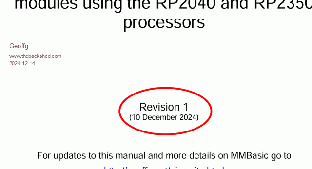

Posts: 3367
Posted: 09:08pm 13 Dec 2024
Something is not right here.  This is what I see when I download the latest version in that link:

homa
Joined: 05/11/2021
Posts: 685
Posted: 10:18pm 13 Dec 2024
  Geoffg said  Something is not right here.  This is what I see when I download the latest version in that link:
Geoff
I think you could say that is more than surprising.
I have changed the browser and also used the “private” mode. It remains at revision 0. The link in the first post is: https://www.thebackshed.com/forum/uploads/Geoffg/2024-11-28_215954_PicoMite_User_Manual.pdf
Is that a cache from the ISP in between? The download is in Germany. Do other users from Germany have this problem?

Posts: 3374
Posted: 11:07pm 13 Dec 2024
That is the Revision 0 link.
This is the Revision 1 link.
https://www.thebackshed.com/forum/uploads/Geoffg/2024-12-10_194930_PicoMite_User_Manual.pdf
Note the date in the link.

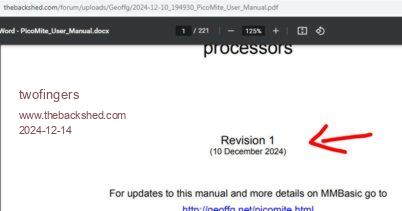

twofingers
Joined: 02/06/2014
Posts: 1769
Posted: 10:26am 14 Dec 2024
  homa said  ... Is that a cache from the ISP in between? The download is in Germany. Do other users from Germany have this problem?
Matthias
Hi Matthias,
I get the revision 1 from here: https://www.thebackshed.com/forum/uploads/Geoffg/2024-12-10_194930_PicoMite_User_Manual.pdf
without any issues.

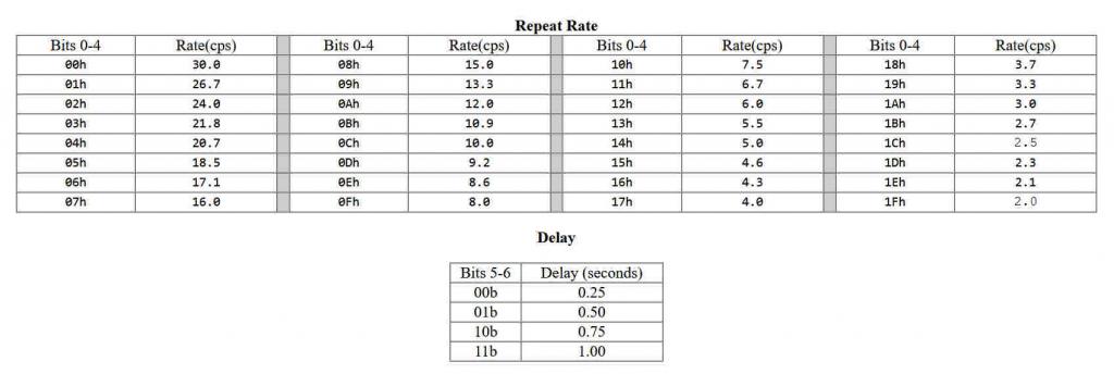

Posts: 11827
Posted: 02:31pm 14 Dec 2024
Option break is a temporary option you need to set in a program. It works for a console and a PS2 keyboard. I missed it for USB keyboards but will add it.
OPTION KEYBOARD REPEAT is just for USB keyboards and sets the time for the first repeat (100-2000) and subsequent repeats (25-2000) in milliseconds
OPTION KEYBOARD applies to both USB and PS2 keyboards. For USB keyboards the parameters work as per OPTION KEYBOARD REPEAT
For PS2 keyboards they are a number between 0 and 3 and 0 and 31 respectively and act as per the PS2 keyboard specification
