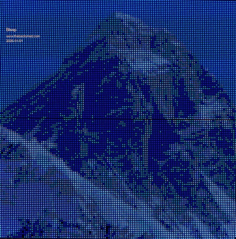

Joined: 09/01/2022
Posts: 864
Posted: 02:50pm 31 Dec 2025
Hi Albert,
As prommised, here is a 128x128 display, same image with different dithering unfortunately this was about as good as I could get it. :-(
I'll keep experimenting.
Regards Kevin.
