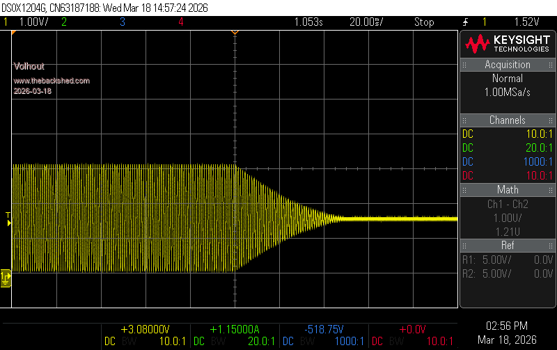

Volume down is very smooth !! rc2 volume down worked by changing at the first zero crossing, but this is also possible.
