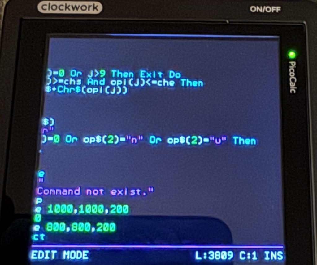

Joined: 02/01/2026
Location: Hungary
Posts: 155
Posted: 08:08pm 19 Apr 2026
@matherp
Peter!
After writing a long line in Picocalc and press Enter I got the attached screen. From here I can’t go back to the beginning of the lines.
Only if I save and reopen editor.
Or pressing shift+Tab (home) twice to go to the top.
G@bor
Edited 2026-04-20 06:11 by terekgabor

Posts: 12056
Posted: 09:42pm 19 Apr 2026
terekgabor: will fix both issues tomorrow

Posts: 12056
Posted: 01:42pm 20 Apr 2026
V6.02.02B8
PicoMiteRP2040V6.02.02B8.zip
PicoMiteRP2350V6.02.02B8.zip
Fixes bug where returning to FM after a failed image load changes the font
Fixes bug in AUTOSAVE CRUNCH
Fixes bug when pressing ENTER in a line that scrolls in the Editor
Extends long line support in the editor to MARK mode
Allows LIST command to both page up (up arrow key) or down (any other key) in both the LIST command and LIST invoked from the filemanager
Output from OPTION PROFILING ON now supports paging
Output from LIST COLLISIONS now supports paging
Pulse duration in the stepper now increased to around 10uSec. This works by setting the pulse at the end of one interrupt and cancelling it at the start of the next. This is the only way to reduce the overhead in the 100KHz interrupt routine and is UNTESTED
