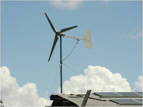

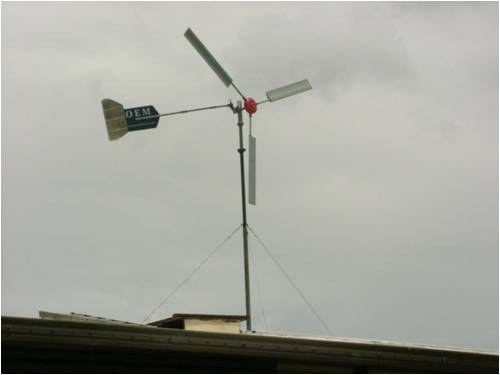

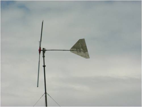

I have decreased the tail weight by 2 pounds by fitting the larger tail sheet which is alloy, as compared to the original one which was steel
New tail:
Original Tail:
The original one in this configuration was also 6 inches longer adding to the tail weight.
If you will note the lay back in the tail pivot you can see that it has a lot of lift, on trying to move it by hand in-situ I found it nearly impossible to move as Phill suggested. On reading up on furling angles it looks like the Chinese have put to much angle on the pivot thereby increasing the moment of force required to overcome the lift of the tail, like adding more weight. Phill has recommended reducing the lift angle, so I will make a jig and try the difference in foot pounds torque required to lift the tail as it would be when furled.
One other thing I have noted is the tightness in the bush that the tail pivot rotates in, as it is new and hasn't run in yet so I think that will effect the furling as well. When they welded the bush it has distorted slightly and tightened on the shaft, I will try honing it for a better fit and a polish on the shaft that looks like it was turned down by a rusty nail, it all adds friction to the system. When I tried it initially it wasn't to bad but didn't have the tail weight hanging on it, it probably needs a couple of ball bearings on a larger housing to reduce friction or a brass bush not steel to steel.
I did try the smaller tail approach but the mill became unstable and wandered around all the time coming in and out of wind, but not furling.

Looking from the tail vane (rear) of the mill the blades turn ccw and the mill furls to the left, I have looked at a few different designs and that seems to be a standard in the small mills, got into big strife with the wife when I took the wheel off her exercise bike, no sense of humor at all, my bike had a flat tire so was a bit wonky.
I will keep trying and let you know.

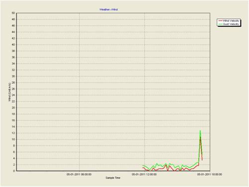

Progress Report
I put the mill back up and two hours later I had one of the worst storms for a long time 3 + inches of rain and lightning and thunder in a continuous burst for nearly two hours, The mill survived the storm and appeared to be furling in a controlled fashion, while it was difficult to see exactly what was happening due to the heavy rain, I could see the blades slowing down then speeding up as the gusts went through, the blades went from full speed back to about 60 to 80 rpm then speeding up again.
The rain was so heavy I couldn't see the angle relationship to the blades so dont know the exact motion of the furling, but, I think to bring the blade speed down as much as it did it must be near fully furled.
The angles used on the head are 5.5 degrees lay back and 9 degrees to the side, I was aiming for 5 degrees back and 10 to the side but welding changed things a bit.
I reduced the weight of the blades by a total of 1.4 KG by cutting the steel tube in the blade off just past the second bolt taking 12 inches from the tube.
Looking at the action of the blades they accelerate a little quicker and slow quicker due to less inertia, as the weight reduction means a weight reduction of 30% at the center of gravity of the blade, and as the weight was on the outside of the rotational plane it would mean a significant reduction in the moment of inertia of the turbine.
A more careful balancing has removed any vibration from the blades.
The machining of the stator to a perfect round in relation to the rotation of the rotor gap solved the growl that was noted at low speed cut in, it is now a gentle and even hum, so thats a big improvement. The air gap is now .016 thousands of an inch or about .4 mm.
The extra air gap hasn't made any significant increase to the cut in and it starts charging at 120 rpm one amp through the boost module for 10 volts AC from the mill. Below that it still charges a bit starting at 3.5 volts AC only 85 ma but it is working.
How much did it put out during the storm? I don't know because I wasn't silly enough to go out in the storm to watch the meters, that will have to wait for better weather.
This graph is from the time I put the mill up to the storm, the first high peak is the start of the storm but the lightning zapped the radio link to the weather station so it didn't record the full event but it did get worse from there.
All the best
Bob

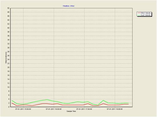

Hi All
It was a bit dryer today and I had a chance to do a guage gaze with a good slow and consistent wind speed to asses the usefulness of the boost controller, the following is the wind and gust graph.
Not impressive in the way of wind but it is proof of concept for the boost module, during this time the mill output was fluctuating between 500 ma and 1.5 amps on the boost module and just starting to feed through the cap doubler. just under 1 amp on peak gusts. The combination of these two devices pull every last watt out of the mill.
The figures are higher than the Altons simulator and I put this down to the efficiency of these blades at low speed. Others may disagree with me but I know what I am seeing, unfortunately I cant log it for you all but that will come in the future.
All the best
Bob

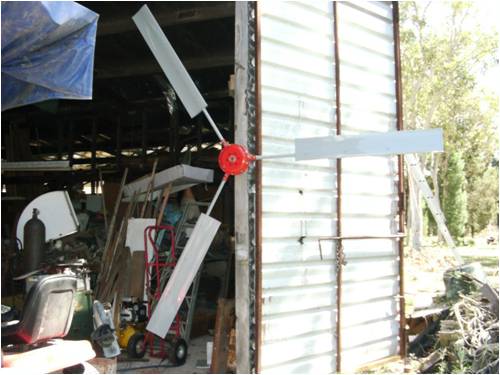

Horses for courses. This morning I have been observing the results of low wind on my two wind mills, the Old mill a 500 watt Chinese mill with a set of upgraded composite blades 2.5 meters in diameter, and My new mill which has the extruded alloy blades ge222 profile as supplied with the mill 2.8 meters dia.
My old mill blades are more theoretically efficient as they are tapered and pitch twisted and generally what would be considered to be a better profile, and once they get going they can produce a lot of power, in high winds I have seen the amp meter pegged at 50 amps nearly 1600 watts not bad out of an old 500 watt mill.
My new mill blades are a constant cord blade with no twist for pitch compensation, wide cord right to the tip a high lift, high drag airfoil profile,GE 222 all in all a theoretically less efficient blade set, and they have a big aerodynamic hole in the swept area due to the blades not going right to the hub.
The performance of these blades is exceptional though, they are quite happy to start below 1 ms average wind speed if a slight gust starts the moving, once moving they produce power, consistently in excess of the Alton example, they are producing electrical energy at 80 RPM 1.4 ms 1 amp into 27 volts while the more efficient blades on my old mill are still sitting still, and by 120 rpm around 2 amps into 27 volts, the more efficient blades are just starting at that producing nothing, they are .3 meter smaller in diameter so a smaller swept area comes into play.

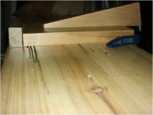

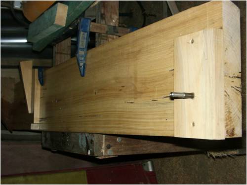

The locating pin on the inner end of the blade holds the shaft.
The blade rests in the angle which is cut at 12 degrees to give 8 degrees at the cord line.
I tried more pitch but the blades where sluggish, and with less pitch they where hard to start and didn't produce as much torque so Phill's recommendation was spot on.
