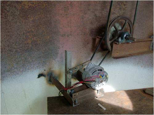

mac46
Joined: 07/02/2008
Posts: 412
Posted: 11:59pm 03 Jun 2011
Hey Everyone, this is a picture of the drive system includeing the alternator. I believe this is a 65 amp model.
You can't believe how tempting it is to unbolt the parking clamps...and give her the first try. I've got the wind, but no breaks, so its a no go for today.
I'm really getting the itch to give it a try.
Now, as Gizmo stated in an earlyer post, "I'm getting as nervous as a frog in a blender". (Getting so close to running).
Tune in again tomorrow, thanks for visiting.
....Mac46
I'm just a farmer
Bryan1
Joined: 22/02/2006
Posts: 2297
Posted: 06:14am 04 Jun 2011
G'day Mac,
With my first motor conversion I did wonder as it was predicted 100K + winds were due to hit us should I take the tower down or just let her go. I left it up and watched the amp gauge as those winds hit and man did the genny love those high winds. These days when I can hear the blades topping 500 rpm from the house I run upto the shed to watch the output. Go on be game and let that big vawt go and see what she can produce in a high wind. If it does break apart well give Murphy a kick where needed....(Murphy don't take this too hard).
Cheers Bryan
mac46
Joined: 07/02/2008
Posts: 412
Posted: 12:39pm 04 Jun 2011
Bryan1, and Everyone,
I researched the "GM alternator" last evening...I have the alternator set up to turn backward, I'm going to have to fix that. Also, the paticular model is rated at 63 amp max. output, not 65 amp. that I posted earlyer.
I have the break to install, the cluch linkage, batteries, wireing, ect. ect. so I still have a fair amount of work ahead of me yet.
The gearing ratio,"for those of you who are wondering", is 7.2 to 1 , my best guess at the moment, I don't know how well the wings will perform. This is likely to be geared alittle "tall", and I anticipate adjustments will be needed. I've read that it takes 1 hp. to generate 20 amps-12 volt, (approximately). I can sit here and speculate all day, but it won't get me any closer to produceing power, and will just waste our time.
Bryan1, thanks for following my posts. I appreciate you'r involvement in this project, as I do everyones. This is all new terrain to me.
....Mac46
