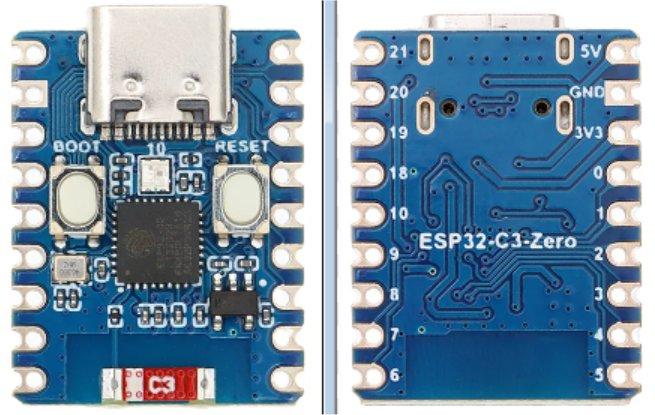

Here's another "Recent Basic", Annex32 on an 18-pin ESP32-C3-Zero.
Annex ESP32-C3-Zero .010    .080    .151    .153    .186    .277    .506    .299
Pretty comparable to the F4.

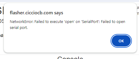

Posted: 02:41pm 08 May 2024
  JanVolk said   but I do have the LILYGO T-PicoC3.
That's what I have.
It's a no-go for me, thus far...tried every darned thing.
The COM-Port shows-up in the list but all I get is:
No response from the Annex32 guys.
Googled the message and tried everything including switching from a W11 to W10 system.
Downloaded the toolkit, the COM Port shows up on the list, attempt to flash and it complains that the COM port doesn't exist.
The USB-C connector is the correct orientation. I power-up, holding the Boot button so that all I have is a green LED. The COM Port even shows "J-Tag (something-or-other)"
Posts: 3868
Posted: 03:07pm 08 May 2024
  PhenixRising said  It's a no-go for me
I don't have that module, but have successfully flashed maybe 20 or more ESP32s using the web flasher--D1-Minis, S2-Minis, C3-Zeros, S2-Zeros.
Maybe it's a duff module (although I haven't had one yet).
