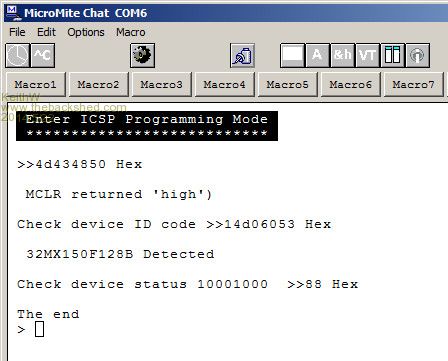

Ok, I have begun to communicate with a chip using ICSP from another MicroMite, a WhiteWizzard board with a 32MX150128D 44 pin to the subject 28 pin MX150F128B’s ICSP connector.
I started with Mobi’s program but have modified somewhat. JTR0701's posts have also increased my confidence. I place the code here to help others get started. Mobi was trying to erase the chip as an early goal but I have resisted that as the PicKit3 has currently gone back to its owner. I can read the chips ID correctly which is a 32 bit number and I think the Status read is OK. Therefore some things are working. I will try to build on this but have a way to go.
I will be grateful if people who are more familiar with MMBasic have a look at my code as I struggle a bit. I have particularly had trouble with using what I had hoped were global variables within subroutines. Finding that they are not visible within the sub? I am trying to minimize processing to increase speed. Using text strings for data seems helpful but may prove cumbersome later.
Geoff, thank you for answering my post regarding creating a small Pclock routine. Perhaps the ability to poke a small machine code subroutine into memory from MMBasic and then being able to call it would be a more universal answer. I think this has been written about before, but have forgotten the status. A method of programming a blank chip would be to put in (using ICSP and MMBasic) a small loader that could then communicate via the subject chips hardware serial port from/to the programmer chip to speed the process. This may be faster than bit banging it all on ICSP.
Whatever, getting some code in is the first step.

There is a problem with your Setmode sub routine. You are calling it with Gosub Setmode and you have coded the routine
SETMODE:
clock 0,1 ' tdi = 0 : tms = 1
clock 0,1
clock 0,1
clock 0,1
clock 0,1
clock 0,0 ' tms = 0
End Sub
It needs to be ended with a Return not an End Sub
SETMODE:
clock 0,1
clock 0,1
clock 0,1
clock 0,1
clock 0,0 ' tms = 0
Return
Not sure if that will cause a problem. I seem to recall someone raising that question before. I'll keep looking.

  Keith W. said   Ok, I have begun to communicate with a chip using ICSP from another MicroMite, a WhiteWizzard board with a 32MX150128D 44 pin to the subject 28 pin MX150F128B’s ICSP connector.
Keith W.
Nice work Keith and congrats on that and also to Mobi and others who helped reach this milestone. Programming the PIC32 via the 2-wire 4-phase method is not straight forward and getting this much done means that there are some of the needed primitives working.

Posted: 03:48am 23 May 2014
From my oscilloscope on the PGEC wire an 8 bit data transfer which uses about 15 Pclock (4 basic clocks each) per transmissions takes 50 milliseconds. With 30 millisecond minimum between the transmissions. CPU = 40 MHz.
Looking at the method used by Kaikkonen the overhead to program is horrendous as it requires about 50 off 32 bit transmissions to load just 32 bits of code. Without reading it back. His method seems to repeatedly load a program in to flash just 32 code bits which is a very slow technique. I may be incorrect but cannot find otherwise yet. Hopefully JTR0701 will tell us that this is not required. The DS6001145(now N) does not use the same method, but without a knowledge of the assembler instructions given it will be a hard grind.

Keith,
In your xferdata sub, I believe your tms footer should be '10' (according to datasheet) but you have '00'. i.e. should be 'clock 0,1' two lines before the end of your sub.
WW
Keith W.
Joined: 09/10/2011
Posts: 118
Posted: 06:20pm 24 May 2014
WW,
Thank you.
I have altered to correct but so far does not act differently.
I am happy to find that someone is trying.
And more importantly checking.
Keith W.

  Keith W. said   WW,
Thank you.
Keith W.
"So far does not act differently." Right!
You just haven't progressed far enough to see that the whole TAP state machine is now out of kilter. You get away with it (now) because it is virtually the last operation you are doing that is being "misterminated" (is that a word?)
Nice catch WW. Potentially this could have saved days of hair pulling troubleshooting later... Edited by JTR0701 2014-05-26

Well JTR0701, now I have found another error. This time within my Xferdata sub. On the third last clock call of this routine TMS should also be 1.
Sub xferdata(st$)
y = Len(st$)
outdata$ =""
clock 0,1
clock 0,0
clock 0,0
outdata$ = Str$(tdo) + outdata$ 'first bit in
For x = y To 2 Step - 1
clock Val(Mid$(st$,x,1)),0 'out
outdata$ = Str$(tdo) + outdata$ 'in
Next x
clock Val(Mid$(st$,1,1)),1 'last bit out ‘******************correct last chr to 1
clock 0,1
clock 0,0
End Sub
And fixing these errors has corrected an anomaly that had concerned me. I had found that I must call Setmode again between reading the ID and reading the Status to return the correct status. I had tried swapping the two operations but the second still did not work without a preceding Setmode command.Correct code to be: -
Print : Print " Do not recognize chip"
EndIf
Print : Print "Check device status ";
I am happier now.
Keith W.

Yes, another good catch and another bug squashed. More reason to feel like things are advancing. It is not as if anyone really believes we get stuff like this right the first time.
The thing about both these two errors is that they are pretty much the same in effect. They both throw out the TAP state machine in the same place (after the data is read) and as you have found, the effect is not immediate but occurs with subsequent operations unless you do something to reset the TAP controller.
To be perfectly honest I was looking at your code and wondering how the MCHP_STATUS read after the MTAP_IDCODE read could work but now I understand it was the additional SET_MODE in between that reset the TAP state machine. Ahh!
BTW, The nitty-gritty details of how and why it works are not in the microchip programming specification so if you are wondering where I am getting the insight on the TAP state machine it is in the MIPS EJTAG specification MD00047-2B-EJTAG-SPC-03.10.pdf.
