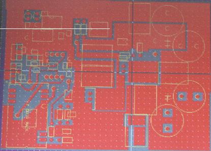

Hi All,
MPPT is progressing well. I am at final artwork stage. Screen photo is presented below. I have been unable to capture this screen, had to use camera, so apologise for poor quality.
This is a multi layer board. approx dimensions are 100mm x 80mm. No heatsinks should be required. Only one picaxe is on this board. 2 other picaxe interfaces are off this main board and connect with a 4 way loom. The current sensing Hall effect device is also located OFF the board. This is designed to be a universal main board. I have also made provisions for in circuit reprogramming. I hope to have a cct in operation next week.
cheers, Gordon.

Hi Domwild,
  domwild said
As the answer(hope) to your concerns:
1. Why not use a larger Picaxe, like the 28 or 40? Then there would be enough storage, etc. for more code.
2. A larger Picaxe would also no longer require interfacing between modules as larger Picaxe's have more I/O pins.
We must have posted at the same time. I missed your comments as the forum automatically created a 7th page link.
WRT your comments.
The program space for code is not a problem. The 28 & 40 pin axe micros would have enough analogue inputs. The Extra Digital I/O are not of much use here. The parallel processing ability of using multiple micro's increases the real time control ability, by sharing the tasks and prosessing the information simultanously.
The MPPT is pushing the limits for the picaxe chip. I already have made an analogue control MPPT. The picaxe micro, MPPT is a project that I am tinkering with to compare performance. I am still unsure if the picaxe will process the information at a fast enough rate even with parallel processing. I had previously been unsuccessful with a single processor. A BS2 running at 20MHz, with a 4 channel A/D converter.
The AXE 08M are cheap as well.
I will know pretty soon, if the chips are up to it.
cheers, Gordon.

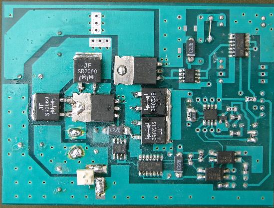

Hi interested readers,
I have attached a photo of my prototype MPPT board.
This board has the high power DC-DC converter and modulators.
There is still quite a bit of code optimisation in the micro still to be done. I have had to relocate as much of the code to other micros, to improve the response time.
It is inconclusive at this point to say the AXE-08M is able to perform the Maths functions necessary for correct tracking of a windmill's output power.
Still some more work to do.
cheers, Gordon.

Hi Herb,
As you will be aware, these type of ccts do require special construction techniques. Poor construction can lead to a serious RFI problem. If this works well, there is probably economic value in it. At this point I will not be publishing any cct diags on a public forum. I may have employed similar techniques to others and I will not be publishing ccts as my own without first checking. If I have used other persons published ideas, then I intend to credit those people.
I am still trying to distribute the various mathematical tasks between micros. It is pretty apparent that a single micro, AXE-08M is unable to fulfill the role by itself. The control of rapidly changing variables may still be better managed by a mixture of digital and analogue ccts. In the past I have been able to modulate at 500kHz, with a linear response 0-100%, to digitally amplify audio using a discrete component digital modulator that I have built. The digital control response time of the process usung the AXE-08M is currently a bottleneck.
I will continue to press on as many DIY windmillers and solar experimenters will benefit if this technique can be successfully implimented.
cheers, Gordon.
