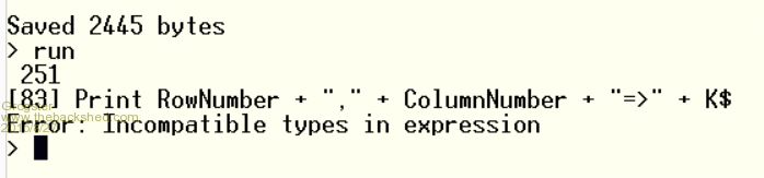

Changed to 511. Result:
As to line numbers, just copy and paste the code into MMEdit for line numbers.

Posted: 02:17am 27 Aug 2015
Result:
Current code:

Posts: 2991
Posted: 02:18am 27 Aug 2015
str$()
Posts: 2991
Posted: 02:19am 27 Aug 2015
PRINT str$(RowNumber) + "," + str$(ColumnNumber) + "=>" + K$

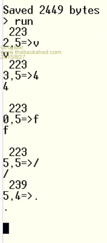

Posted: 02:20am 27 Aug 2015
Getting close. :)

Posts: 10044
Posted: 02:24am 27 Aug 2015
RESULT:
This result is still incorrect - I was typing QWERT.
CURRENT CODE:

That looks better!
Now the tedious task of filling the lookup table with the right characters.
Posts: 2991
Posted: 02:26am 27 Aug 2015
Now try with Debug=0 (should be quicker!
MicroBlocks
Joined: 12/05/2012
Location: Thailand
Posts: 2209
Posted: 02:28am 27 Aug 2015
Also add a ; otherwise each character will be on a new line.
[code]
print ScanMatrix$();
[/code]
The lookup table has only placeholders for the right characters.
If you see a 'v' that should be a 'q' then find it in the lookup table and change the 'v' into a 'q'. Repeat for all characters.
This will allow many different kinds of keyboards to be used, just need to put in the right values in the lookup table.
If you wired the keyboard as in the latest matrix, then you can use it to fill the lookup table quickly.
Can you also test holding two keys down at the same time. (Only do this when you have diodes in your matrix otherwise you can short two row outputs)
Edited by TZAdvantage 2015-08-28
Posts: 2991
Posted: 02:32am 27 Aug 2015
If you were to type eight characters at a time (as per each Lookup string) then TZA's task of populating the matrix becomes easy.
So take the first Lookup characters 'abcdefgh' and press each in turn to show the eight resulting characters.
With all 9 Lookups reported back then TZA can simply put the resulting characters in the correct place in the lookup matrix.
Hope this makes sense . . . .
