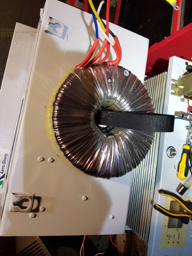

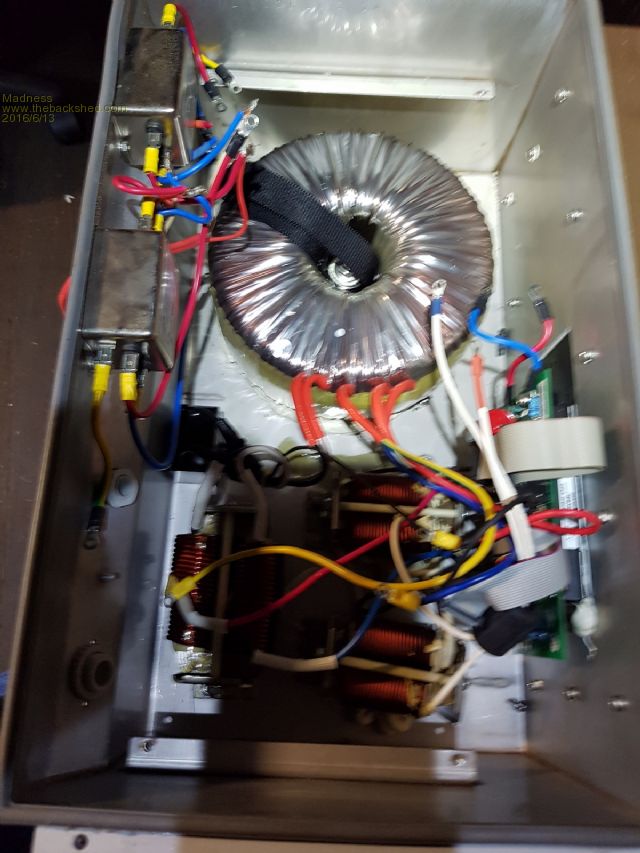

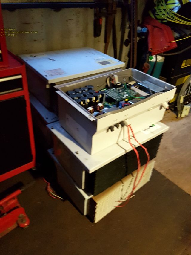

After lots of searching and nothing I finally hit the jackpot. Picked up 6 3 KW Aero Sharps today, if anyone is interested there is another 30 where these come from.

Posts: 10072
Posted: 04:03pm 13 Jun 2016
I wish I could find that kind of thing over here....

There is 30 sitting in Brisbane they might freight them they weigh about 45 KG each.Edited by Madness 2016-06-15
Posts: 10072
Posted: 06:34pm 13 Jun 2016
Lovely thought, but I expect probably not - the weight of them would make the shipping pretty expensive I would think, however I would still be interested in that idea. Could you please either post the contact details for them, or flick me a PM with that info if you don't want to post that publicly.
Out of interest, what do you think they weigh?
EDIT: You edited and put up weight - thanks! Edited by Grogster 2016-06-15
Madness
Joined: 08/10/2011
Posts: 2498
Posted: 06:39pm 13 Jun 2016
Just sent you a PM Grogster with contact details, I won't post it online but if anyone wants it just PM me.
They are heavy things, even the heat sink is over 1 KG.Edited by Madness 2016-06-15
oztules
Joined: 26/07/2007
Posts: 1686
Posted: 10:57am 14 Jun 2016
If you can get hold of one and get someone to pull the transformer, the weight may become more likely to be normal mail weight.... like 16kg or so.... maybe Mad can weigh his transformer if he has not yet started rewiring it.
Much cheaper than sending the 45kg complete..... although the box is very very nice too....maybe even get the folks selling them to strip and send for a few extra dollars.
Won't hurt to ask anyway.
