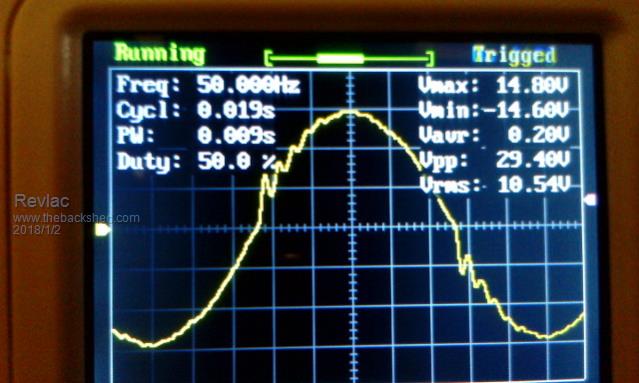

Thought I would try the old selectronic inverter that is in the OLD FARTS motor home (haven't heard from him for months), Expecting a good sine wave.
I see some spikes above 0 crossing on the leading edge (expanded for a better view) I think that is where the white smoke and fire crackers are trying to get out, so better I turn it off.
He might be up for a new inverter and some new underwear (if) when he uses it next.
Would not have Known about it without the CRO.

I have seen waveforms like that, could be something to do with the inductor if it has one.
Posted: 08:49pm 02 Jan 2018
It can also have to do with the nature of any load, or when running under no load at all.
To give it a fighting chance, try monitoring the waveform with just a light resistive load such as a single light bulb.
A perfect low distortion sinewave is simply not necessary, try looking at the grid voltage its pretty awful but everything runs fine on that.

Just tried the little selectronic inverter again (curiosity got to me) the spikes above 0 crossing do shrink a bit when applying a load up to 85w on the output, probably need 150w to remove the rest of it, If it went the other way I think that would be trouble. The inductor sat on top off the toroid.
Anyway I wont touch that inverter again, found a cell in 1 of his batteries has dropped its guts.

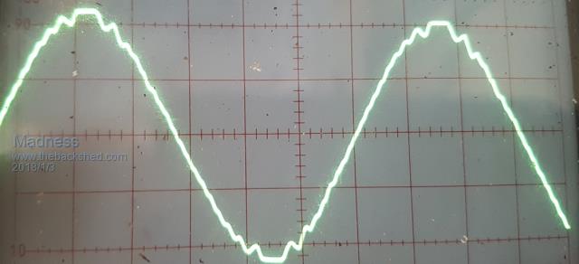

My Inverter goes very quite when the GTI is in operation, more so with HF ABB or Zeversolar, the Aero-sharps do the same but to a lesser extent.
Here is the wave form of the now dead Trace, need to get someone to help me get all 78 KG of it off the wall. It buzzed away when running but never had any issue powering anything off of it. Maybe I should try building one of Warps boards for it.
Last time I looked at the grid it was much smoother than that. As you found out the grid is a very good lightning transmitter.

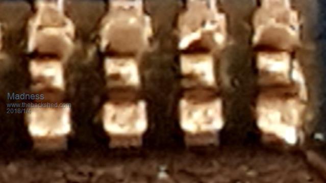

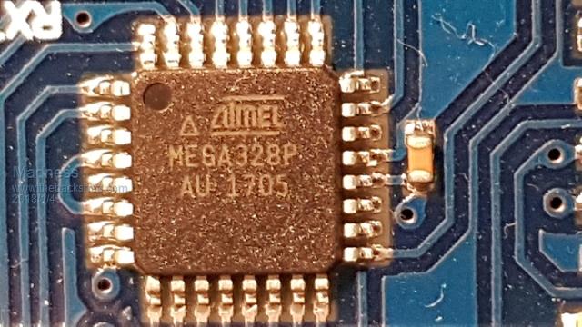

Photo of CRO above is taken by my phone, using a magnifier app on my phone also able to pictures as per below.
The black part of that chip is 6.5mm across, the second photo is of its legs.
Edited by Madness 2018-01-05
