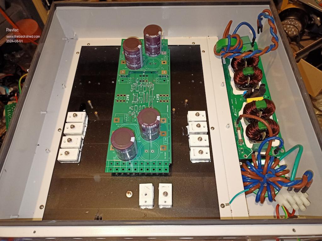

Just recently gutted out this 3Kw sunny roo GTI, Looks like a worthy enclosure for the WG inverter (placed inside), there is plenty room for the PCB's to be mounted with a display and switches on the front door, will hinge the door I guess, I may even use some of the output filter as it looks fairly strong.
I don't seem to build 2 inverters the same so this one will have the 2 parallel Toroids mounted outside in a separate enclosure there isn't that many wires involved so I don't see a problem....YET.
Still working on the current inverter build, just had so many other problems over the last month and haven't been able to do anything on this project, I thought things (life) would get back to normal but    NO, normal is now quite different unfortunately sh*t happens.
Cheers Aaron

I'm not sure if you are building a Dual power board dual Toriod WG inverter, so apology if I'm off track:
I'm also mounting two Toroids in two separate small cases, each with handles for easier lifting, I'm putting two chokes in with each toroid, so only SPWM drive cables and one AC lead connected to each case, the two ac output leads go to the AC control case.
AC current trip and voltage sense will connect to the combined AC output lead in the AC control case. Keeps everything simple and neat with minimal interconnects.

Hi Mike, I hadn't intended to do a "Dual power board dual Toriod WG inverter" but thinking about keeping that option open for the time being, I do have 2 2Kw toroids that are wired identical...well almost, I need to add a few more primary turns to one of them.
I was going to run them wired in  parallel, will make sure the polarity etc when testing each one.
I have to do a lot work in and around the house to make it more accessible (possibly wheel chair access)and easier for those that are older and not as mobile as I am, fortunately part of making things easier also includes this inverter to run the house and another as back up and easy to operate, change over etc.
More details some other time.
Sounds like you have yours pretty well worked out ......I only think I do, then end up changing something.

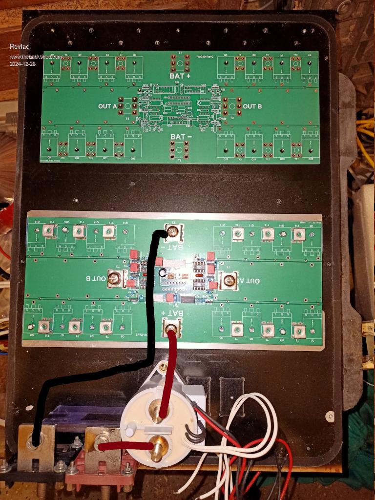

Making a little progress, placing parts on the big heatsink and making it all fit nicely can be a bit of a challenge depending on the amount of space available.
Thinking of using copper bar to link from the terminals to the power board etc, would would be better than messing with short cable and multiple crimped terminals that would cost more, still have to layout the output to the transformer and its good practice to test fit folding cardboard to the terminal layout before bending copper bar and stuffing it up, haven't stuffed any yet but there is still time for that.
BTW, The box this all sits in is bigger than the heatsink, there is more room to use on the Right side, probably Mount the control board there, will see later.
I already have a picture of the box.....forgot that.

I have had success using multiple layers of copper sheet (0.6mm) cut into strips.
It has much more flexibility than solid bar so perfection isn't required. Covered in heat shrink it looks as neat as bars.

I found using short quality 2G cable with quality dual-crimp connectors resulted in no extra heat in both the single and dual inverter builds.
Under high power, the PCB copper bus will get warmer than those large single PCB connectors using quality crimp connectors, same with the connections to the chokes.
