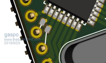

Enclosed are the latest adapter board files. I've added couple of small pads for easier soldering of jumper wires for those wishing to use the off-board crystal.
Let me know if you see any issues with the board otherwise I'm going to submit the order on Monday.

Hi Gaspo Looking good but maybe I am tired confused etc it appears that J2 has crossed up pins 3&4 and pins 5&6.
In my view for instance EG8010 pin 27 should still connect to Adaptor pin 27 after passing through gating transistor Q4 ?
Not a big deal but C4 doesn't have a polarity marked so I'm assuming its a multilyer ceramic ?
Everything else looks ok to my tired eyes.
Cheers Mike

  wiseguy said   In my view for instance EG8010 pin 27 should still connect to Adaptor pin 27 after passing through gating transistor Q4 ?
Good find Wiseguy, looks like my eyes were crossed while drawing up the schematic. I fixed that and updated the board tracks accordingly.
Yes, the C4 is multi-layer ceramic.

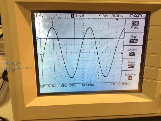

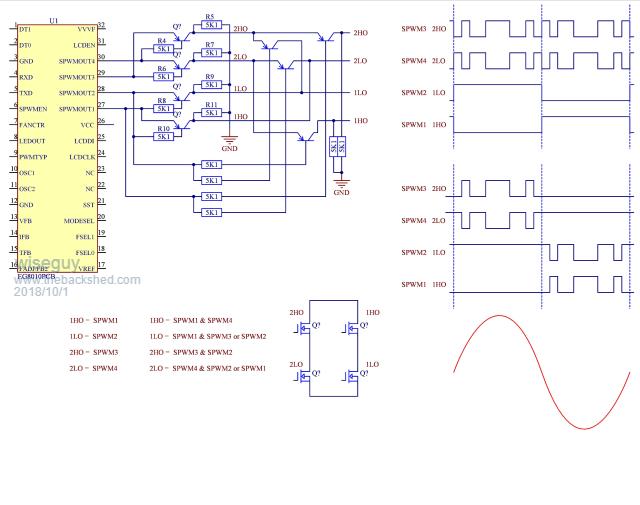

Let me apologise in advance for the technical nature of this post but I wanted to share my experiments and results with other readers and the technical bits are unavoidable.
I finally had some time to play a bit more. Before I created my control PCB I wanted to test my theory about Symmetrical drive - and I like it a lot more more than I thought I would.
Essentially I took the 4 SPWM outputs after the 4 cross conduction transistors that then drive the H bridge and added some more signal steering transistors to achieve the signal trains that I wanted. Initially I created some equations of what I wanted and then got to the part of implementing the function in gates (logic not Bill).
I didn't like the gates result (or Bills either....), then I added some diode steering and transistors and also didn't like that, finally I decided that if they can implement logic using a few discrete transistors to prevent cross conduction, I can do the same and add a few more to achieve what I wanted. Without further ado please see the attached page for the scheme. 2018-10-01_125853_New_Symmetry_Drive.pdf
The 4 waveforms at the upper RHS are the waveforms currently driving the inverter. The 4 waveforms directly under those are my version of how I wanted it to work.
All the waveforms shown are for the gates of the FETs
The gating with those few transistors seriously did my head in for a few hours but the end result is very satisfying. If you look at the new waveforms each PWM starts as it finishes and remains at that level until it has to PWM again. The upper Fets never pull high for the fundamental only the side doing the HF PWM. If you look at all the transitions going on in the upper group of waveforms at the 0, 180 & 360 degrees it is real busy. Now look at what happens as you go through those same points with the lower waveforms - yep thats right nothing.
Essentially we drive the transformer primary up to the peak and back to zero then we reverse the primary (in effect) and use the same waveform again but we swapped sides of the H to do it. I think it looks elegant and avoids a lot of unnecessary transitions & complication in the switching.
Advantages:(maybe others undiscovered?)
1) Pimary is not transitioning from zero to 50V for each alternate half cycle.
2) No busy transitioning of all 4 waveforms at each 180 degrees zero crossing.
3) The LHS and RHS share the power switching (and generated heat) equally
4) The two upper waveforms (1H0 & 2H0 )are no longer driven during the fundamental part
5) Both sides of the transformer start from zero (Batt Negative) and end at zero for each alternate half cycle.

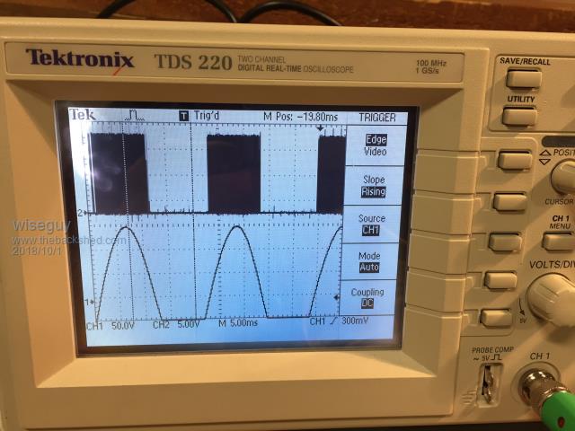

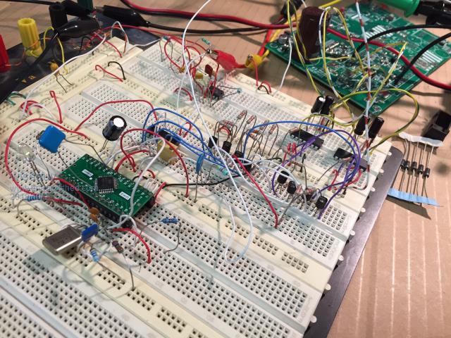

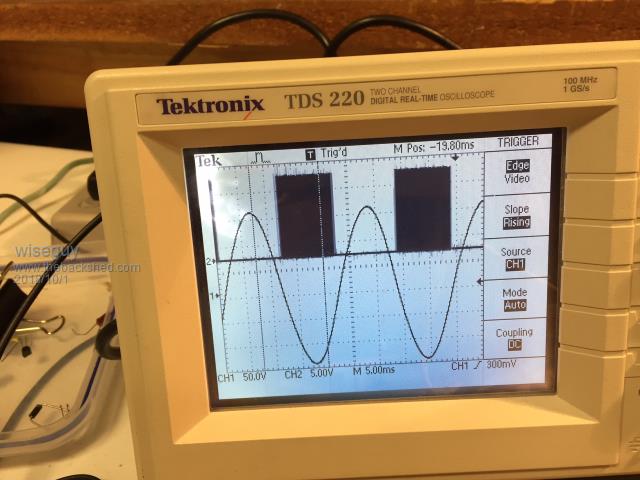

And a few pictures of it working - yes I have finally made an inverter - of sorts. I grabbed the nearest transformer and drove it with the waveform - surprisingly I didnt get 240V only about 150V.
Warning Do not try this at home.
The result
Driving the Pos peaks
Driving the Neg peaks
The mess that made it possible
The PCB at the rear has 4 x TO220 mosfets mounted on it for convenience. The two IC's on the upper RHS of the breadboard are the two IRF2110's.
Breadboarding this stuff is not advisable - only for those who get it.

Posted: 04:45am 01 Oct 2018
Great stuff Mike.
That should get rid of the zero crossing kinks without adding an electrostatic screen to the toroid.
Would probably work best with a choke in each side of the primary, but should be o/k with just one choke.

Mike , Ive got a better plan can you explain why a bipolar modulation scheme is better that tnis scheme and its advantages over this scheme - I thought I listed some advantages with the posting ?
I would have thought that having double the switching losses and associated heat generated would be high on the list. Not needing 2 voltage feedbacks & associated circuitry for each half of the generated wave also figures. The fact that unipolar is time tested as the choice for all high power units being discussed on this forum. The fact that I have spent a considerable amount of my time testing the EG8010 and working out how to avoid its buggy behaviour to date and I dont want to go to a bipolar scheme I personally dont like, and then try to figure out what new bugs are lurking for the unwary.
This scheme is really just a minor rearrangement of the current inverter scheme being used but I think a little tidier.
Im happy to use my scheme as presented - I also totally support anyone wanting to use a bipolar scheme.
Warp thanks for elaborating on why the 50V transitions on the primary are undesirable - there is no sign of the crossover distortion in my scheme - but its still got to prove itself at higher power levels - not on this breadboard !

Posted: 06:33am 01 Oct 2018
Several different ways to do PWM with ac voltage, each has various advantages and disadvantages.
Unipolar only requires two of the four mosfets to switch really fast, but has the disadvantage of very abruptly switching the transformer at the zero crossings with full battery voltage at 50Hz, where the polarity at the secondary has to change over.
Capacitive coupling between primary and secondary, which can sometimes be especially high for a toroidal winding can couple a large transient into the secondary at the zero crossings.
That could be mitigated by placing an electrostatic screen between primary and secondary, but that becomes rather more difficult to do effectively with a toroid.
Pretty easy with a conventional E/I transformer though, but that is not what most of us have.
This coupled transient is what causes the notorious kink in the output waveform after one or both zero crossings that some people are seeing.
Continuous and simultaneous true bipolar sine wave drive to both ends of the transformer primary solves all of those kink problems, but then you require all four mosfets to be continuously PWM'd which should not really be a problem.
The whole thing needs to be thought right through, and various decisions made as to the PWM mode of operation, and the design of the transformer, and the advantages and disadvantages weighed. Plenty of combinations are possible.
Unipolar drive and an unscreened toroid may not always be a happy combination, although it can work quite well.
The kink may be truly awful or hardly visible at all.
It depends mainly on the primary secondary coupling capacitance.
