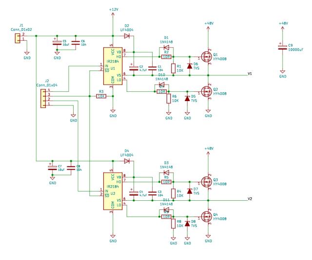

I am really excited to learn from this design.
Questions:
1. Is this called a charge pump based MOSFET driver?
2. Do you have a link to the TVS? or uploading the BOM, if that info is captured there will be helpful too
3. Do the 1N4148 exist to redirect transients that might appear across GS? Does not the TVS take care of that already?
I for one, will be using these isolated supplies for a while though because MOSFETs (or power electronics) is black magic to me.

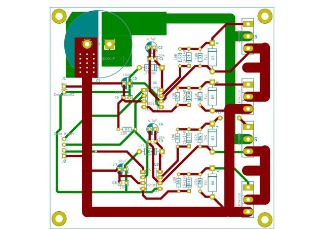

  poida said   I've just completed, with errors yet to be identified, the power board I will be using in my test Warpverter. I need 4 of these:
Only need one 12V supply for the drivers. The need for 18 isolated supplies and more is not going to happen if I'm doing it.
Poida, if I understood correctly, this little plaque that you show here, is the Warpverter topology. These cards are the complete H-bridge with only 4 simple transistors ... Is it used in this topology, to connect several of these cards in parallel to form the desired H-bridge power?
If such a plate fails (burn), the rest of the plates are not reached?Edited by hugocamaras 2019-05-03
poida
Joined: 02/02/2017
Posts: 1497
Posted: 10:46pm 01 May 2019
Hugo, the above design is for a simple full bridge inverter, for low power but also for easy building and easy driving from an Arduino Uno.
I have drawn one HY4008 per leg of the bridge because that is how it will be when built up. A full bridge inverter using one HY4008 each leg is more than enough to deliver 500W which is the max power I intend to test it at.
As you know, we need 4 inverters, to drive the 4 transformers, each delivering different voltages.
There is no intention to parallel these cards in an attempt to increase power capacity.
Yup
RS part no. 815-2578
Vishay ICTE15-E3/54
The 1N4148 task is to make a low impedence connection to the driver IC output
when pulling the gate voltage down to zero.
In other words, to make the switch OFF process as fast as possible.
The 10R resisitor is used to slow down the switch ON process a little.
In the future I probably will experiment with the switch ON and OFF speeds.
This is a good performing starting point for gate drive design using a 2 Amp
driver IC.
The TVS is used to protect against negative voltages at the driver output pin.

The high voltage rails that the HBridge switches on the other hand can be made more resilient
I think you are referring to the 48V and GND wide tracks on the pcb. I have no problem with the size (4mm, 2oz).
All I need is a current capacity of about 10 Amps RMS at 50V.
I could add some reinforcement with copper braid wire, let's see what happens.
The boards cost $25 AU for 5, including postage. This is not a lot of money and a redesign with larger tracks and likely larger boards won't break the bank.

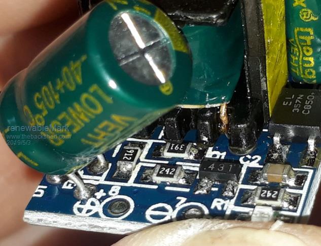

OK got all the power supplies in, took a punt on them starting at 48v and yep they do.
Tried on 24v but they just pulse, 48 is just fine, didn't put any load on them though, should I???
this is what I got
So should I swap that 242 to a 1k8?
And is it just me or does that soldering look a little frosty?
Cheers Caveman Mark

Posted: 06:13am 03 May 2019
There seems to be a very big variation at the voltage these supplies will start up.
Could be anywhere between 30v and 45v depending who you ask.
Try slowly increasing the voltage and see where the pulsing stops, and it suddenly goes to full brightness without any load on the output.
As your minimum battery voltage will be 44v, as long as it starts up reliably at less than that, you will be sweet.
You could try changing the 2K4 to 1K8 and see what happens.
The boards I have modified increase from 12v to about typically 15.1v output.
