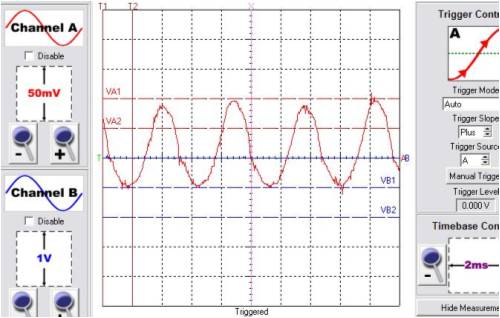

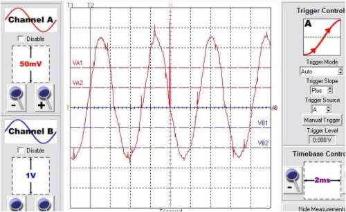

I have had the opportunity to measure and record the AC current in the stator. The current does flow during the whole cycle, not just when the voltage is above the battery threshold.
I present 2 storage oscilloscope[DSO] pics of measured AC current during similar wind/rpm with and without series caps.
This is with caps
7393
this screen is the mV across the current shunt. the AC period was 4.7mS.
This is without caps
this screen is the mV across the current shunt. the period was 4.4mS, so it was a slightly higher rpm.
This is the same current shunt with very similar wind conditions. There is a marked difference in the measured outputs.
The capacitors appear to provide a lot more than just power factor correction or reducing leakage inductance. The current waveform to the battery was pure DC and I had trouble locking the DSO to any signals.
The caps seem to work in conjunction with the rectifiers to provide current gain. The exact mechanism I hope will be debated and a better understanding gained.
An interesting observation is the variation in the shape of the current output between positive and negative transitions with or without capacitors. The reference of the DSO was connected to the rectifier side of the current shunt. This is a delta wiring of the stator.

Am I seeing a dc shift in the waveforms ? I take it you used dc coupling on the scope.
I do not subscribe that the main effect of caps is to counter leakage , its tied up with advancing the rotor and making better use of the rotor mmf IMHO.
It is very complex but for all practical purposes can be thought of as a means of increasing rotor mmf hence generating more emf at lower rpm this of course translates into current as we feed a fixed voltage.
I believe the Dc shift is the battery effect if you could repeat with a resistor load it would be interesting.
Also I assume the delta is closed. In this case the delta will circulte currents in itself to try to establise a Sine wave ie shorts out all odd harmonics.Hence current is swopped from phase to phase.
Try a separate phase connection (Jerry connection )

The current was measured by the voltage drop across a 350mm length of 2mm copper wire, as a shunt. I do not believe there is a voltage shift in the waveform as such, as there was no external reference for the measurement. When current flows one way, a voltage is developed in proportion to it according to the resistance. When current flows the opposite direction, the voltage is in an opposite,[negative] direction. This is what was seen on the oscilloscope chart.
I measured 605W today into the battery from the std 100S stator in delta with the caps.
I decided to check the AC current and measured a peak of 24.6A at an AC mill frequency of 425Hz. The ACV could have been in excess of 80V between phases. I was unable to confirm this with a measurement. I did record increasing AC output with increasing Hz. Power to the battery maxed at 605W. It would seem that a lot of power is resonating within the inductor/capacitor arrangement. This power may be available with additional transformer coupling on each output. I suspect the current would not be in phase with the voltage. The stator has not burnt out yet, but the caps did rise 25degC above ambient after many hours of punishment.
I will be testing a 7phase with caps soon.

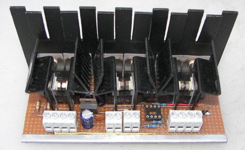

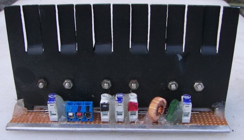

You read my mind. I thought the same thing a month or so ago. So I designed a circuit and built it. Testing and evaluation is currently under way. Back into it again this weekend. Herb will be pleased to hear I'm using fixed powers instead of fixed speeds for the tests.

Hi Gill,
I hope those heatsinks are only for show.
On the matter of switching, or PWM switching of capacitors. The natural tendency of the series capacitor is to pass more power as the frequency increases. This is the relationship the windmill needs to have to follow the wind energy. Adding switching is complicating the natural behaviour. BTW the voltage should increase with frequency. The current should increase with the increased voltage. The series capacitor is the third component to form a cubic power relationship. There should be no need to add complications when the natural relationship is already there.
